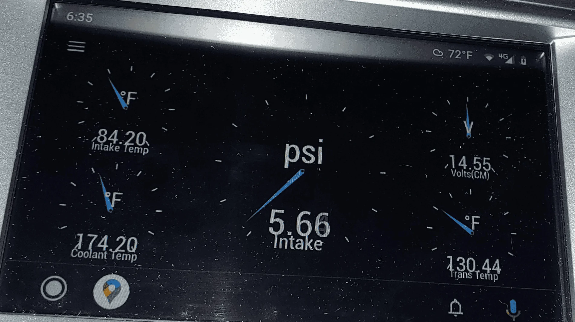

Using the volt meeting in Torque/OBD2AA its ~12V not running and ~14+ running. Pretty typical values in my experience.
Was wondering how did you get torque to show you the truck radio thanks
