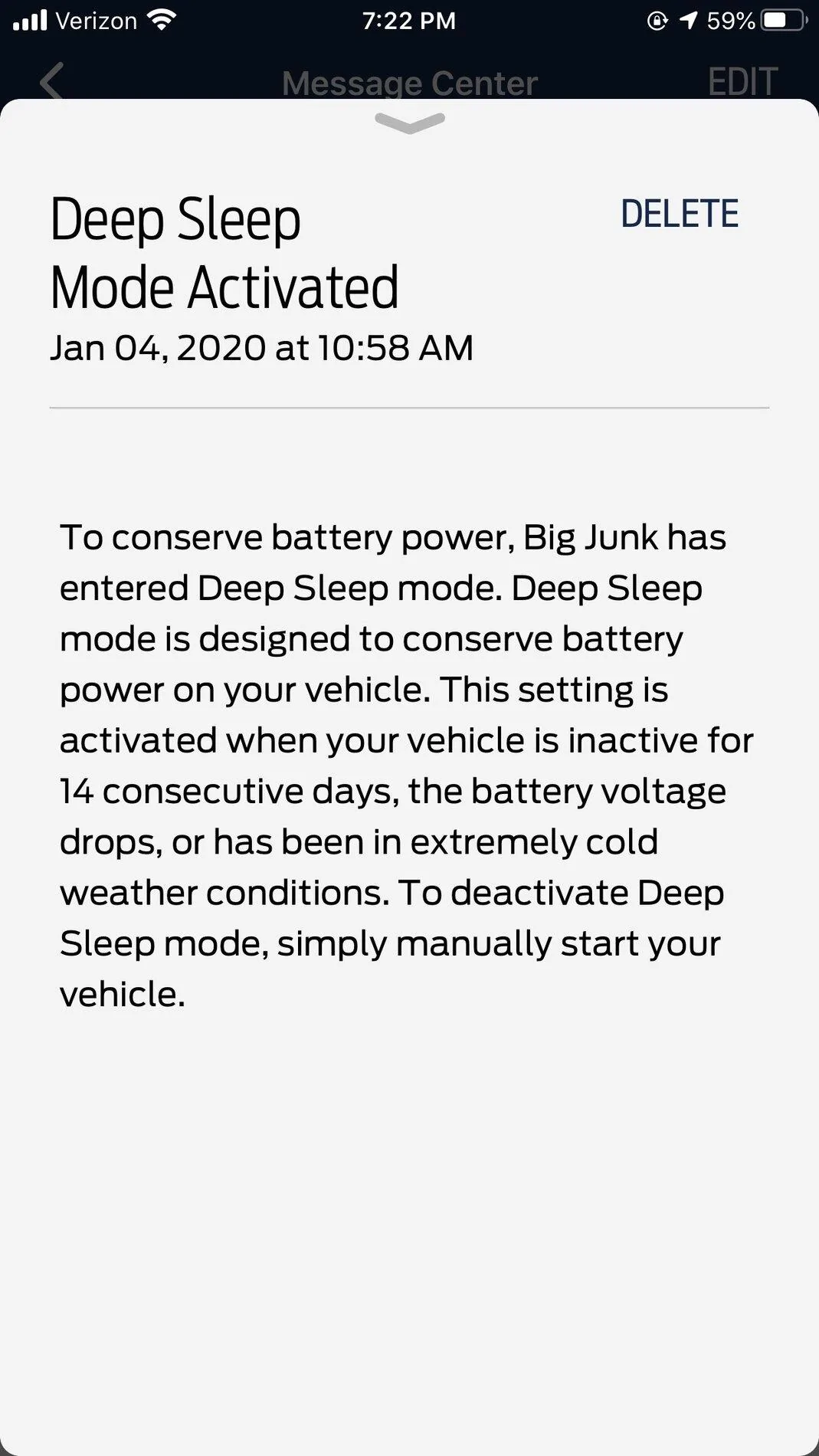

Same here Phil. Last Christmas when I was away for 17 days it sent me a notification that the truck went into deep sleep mode.

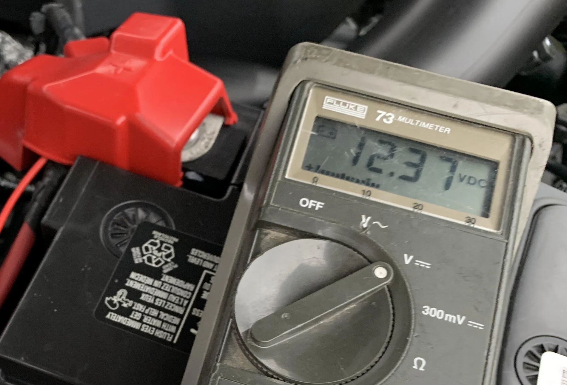

I’m kinda old school, ?
and when I suspect issue with charging system, battery or alternator, I use a multimeter:
Here’s my old school Fluke 73.

Like you, I also use multimeter/ voltmeter to check battery charging and condition.
If needed, I put in a battery tender and charge overnight.
(If that doesn’t help then I suspect other issues, e.g. wiring, alternator, bad battery, fuse, etc)
