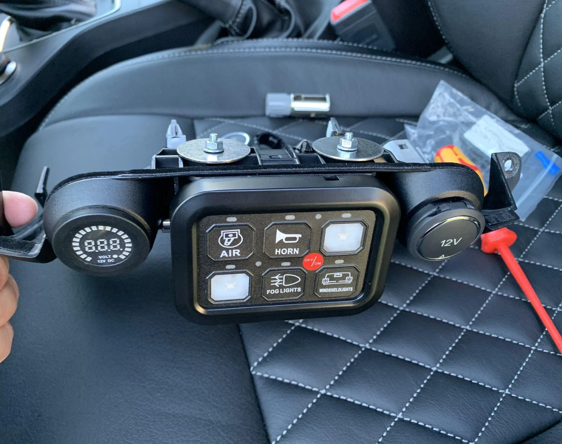

I also installed a voltmeter (replaced one of the 12v power port)
At startup (for a few seconds, but less than a minute) it will
blink and read 15.6 volts.
Then after that, with engine running it shows between 13.8 to 14.8 v
(driving around and depending on auxliary lights/12v accessories I have on)
When I shut off the engine, it reads between 12.6-12.8 volts.
I’m pretty sure the alternator is working as it should, and this little Voltmeter lets me keep an eye on the battery.

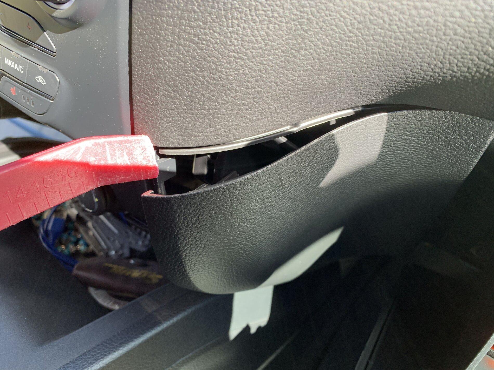

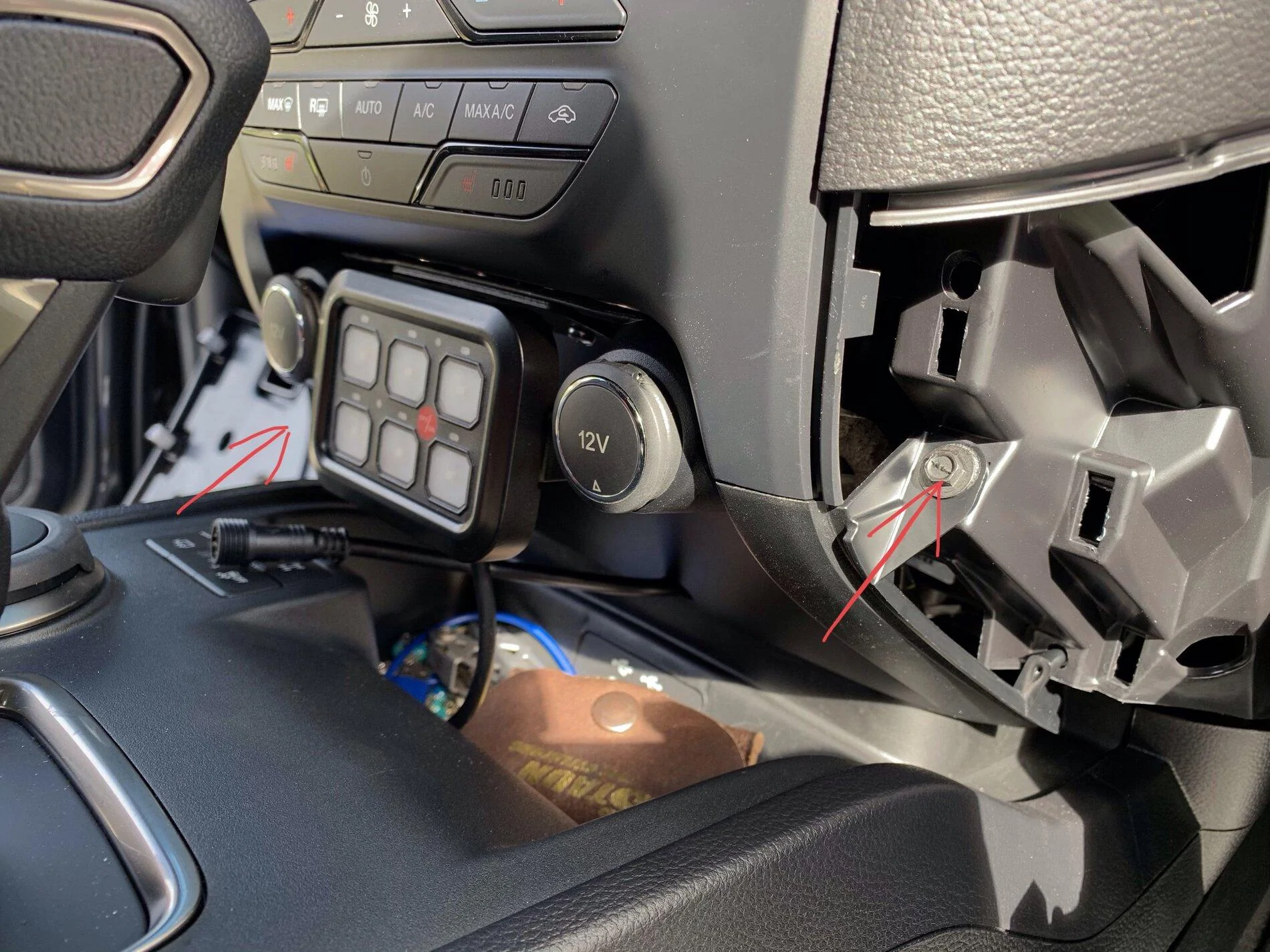

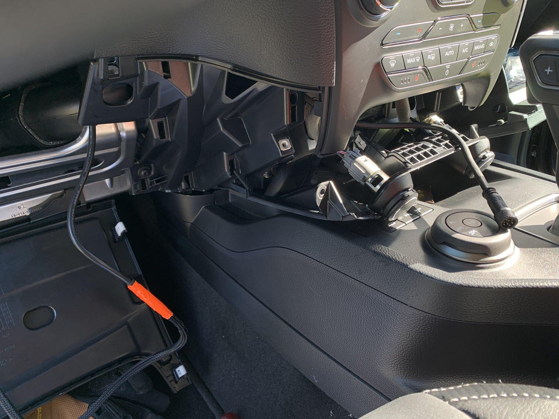

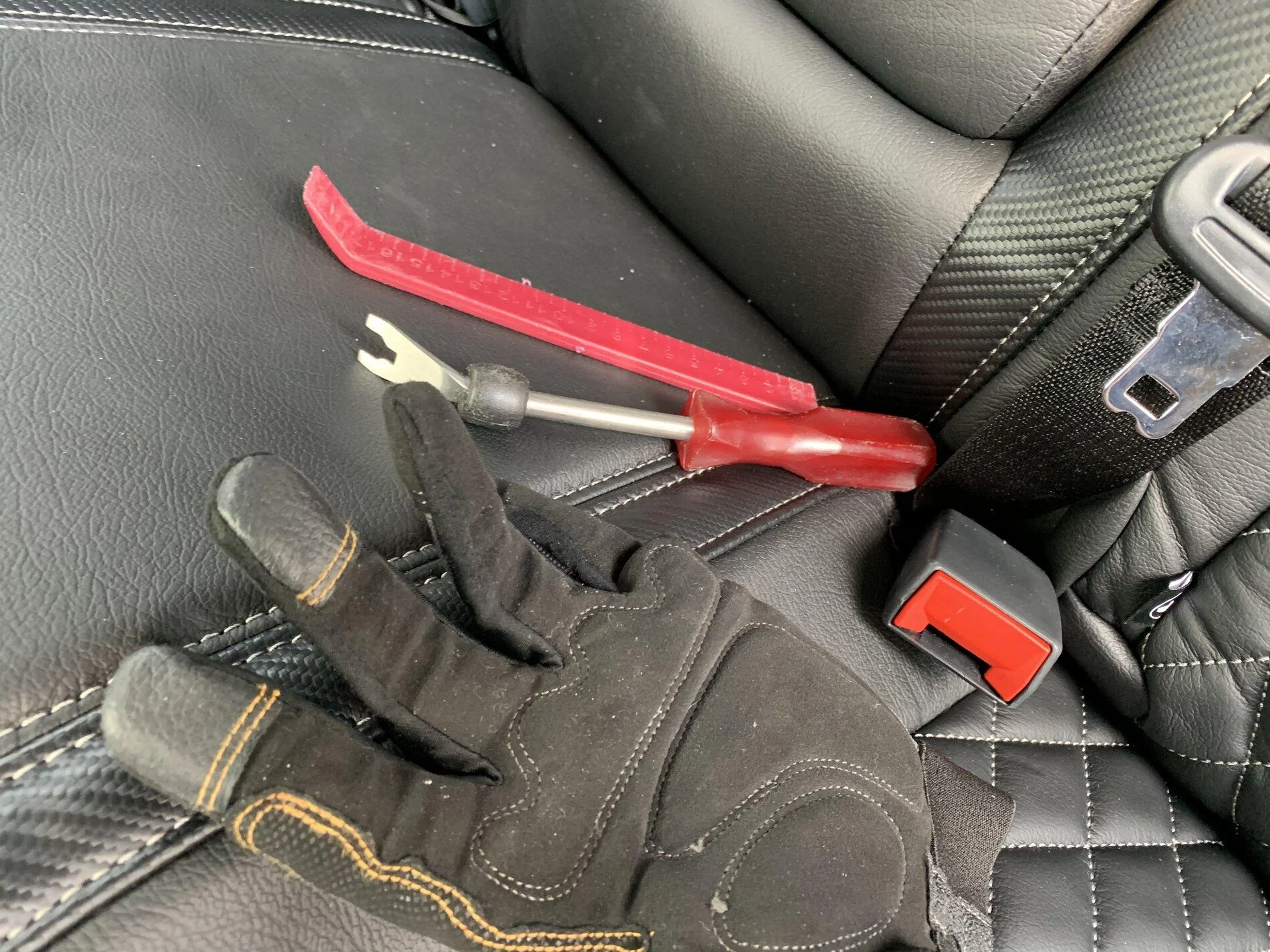

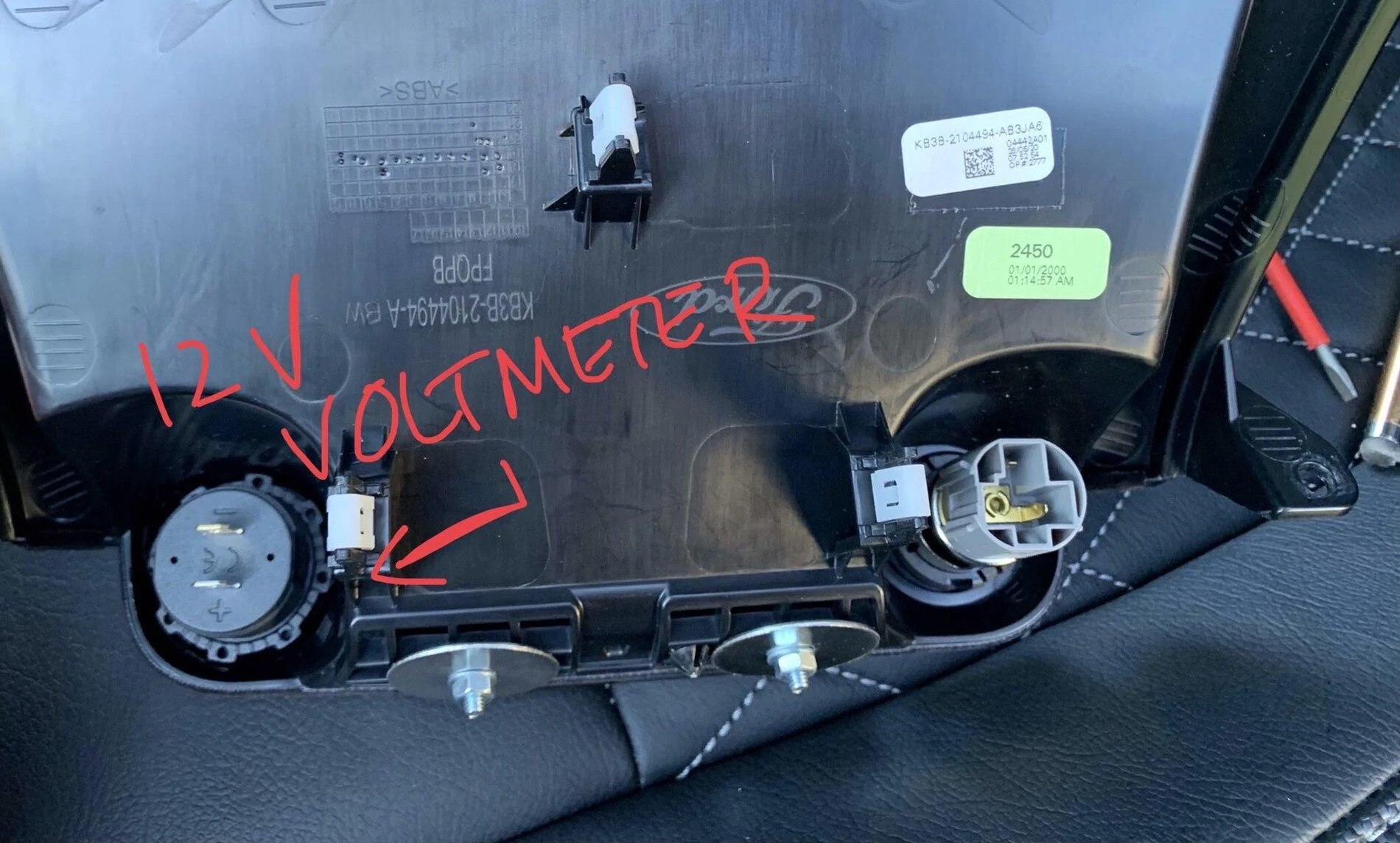

Thanks for the heads up. Definitely getting one. Was installation easy?
It was not hard, but I suggest using automotive trim removal tool
and carefully pry the side panels to acces the 2 screws on the side.
(similar to charwest link above)
I did have to cut the wire from the original 12volt port, and used wire stripper and crimper to add spade connectors then heatshrinked for the voltmeter connection.
You can also watch YT for LightForce switch fascia install:
