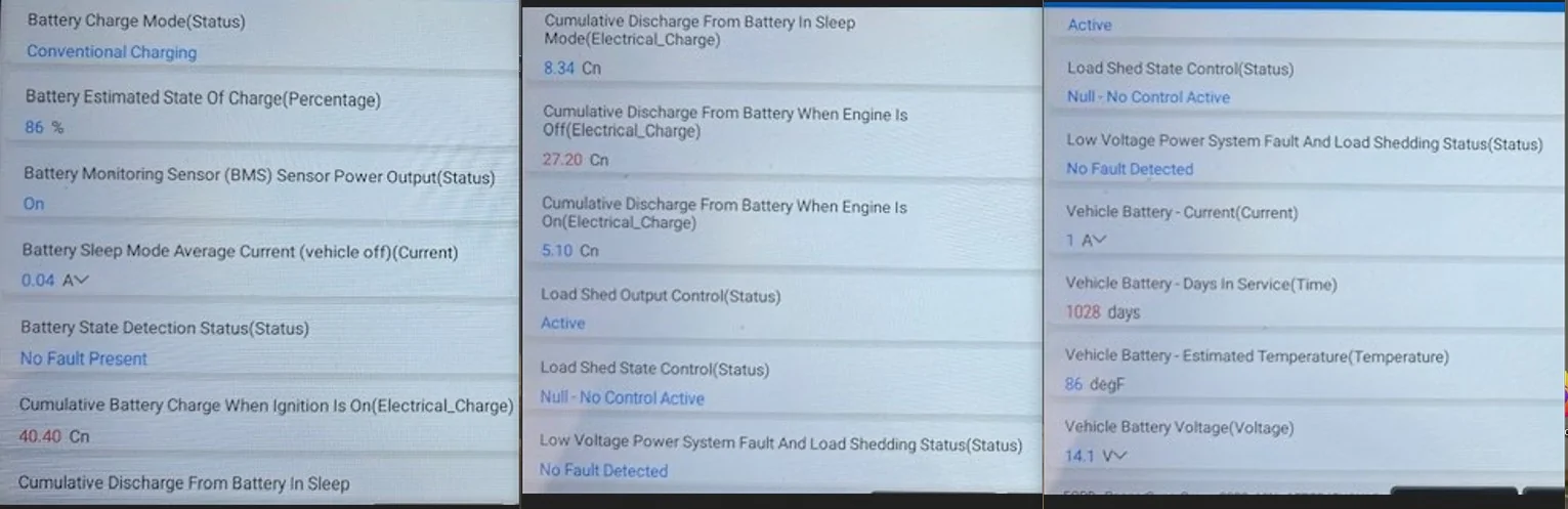

I have a hunch here that the BMS Sensor is false reporting data, and this is the reason for your Battery Save - Message
So, if the battery tests good and it has a Low IR then I suspect the BMS sensor, you may try a BMS Reset first - since it was not c/w with the battery replacement.
I would be curious what the BCM PID reads for the SOC as it comes from the BMS Sensor.
Note: Forscan will not display this PID
The System Off to Save Battery Message:
We know that the BMS Sensor (what it is reading) triggers this message, but I believe it's not really about the actual battery voltage reading, it's what the BMS Sensor is registering as the SOC reading.
This would explain why you have a good battery voltage test (12.2 Volts or Greater) but if you get this message (Check what the BCM is showing for the Estimated Battery SOC) this calculated reading comes from the BMS Sensor- it periodically updates the sensor while driving and performs a (True & Accurate) reading during sleep (rest)
Note: I think what is happening over time this sensor builds a (Drift Error) and reports false readings - throwing off the charging system and minimum error parameters that trigger the message.
Be it a - Sidetrack of the manuals and perform a BMS Reset, although there is only one Ford Document (GSB) that calls for a BMS Reset for System Error (T-Shoot) most of the document's state only with Battery Replacement
or
Replace as a precautionary maintenance item - depending on what your PID data is showing.

What do I need to read that did? I have an obd reader
It's going to be under the BCM - Battery PIDs - if the tool will read it, the PID is there but it depends on the tool if it will read the PID

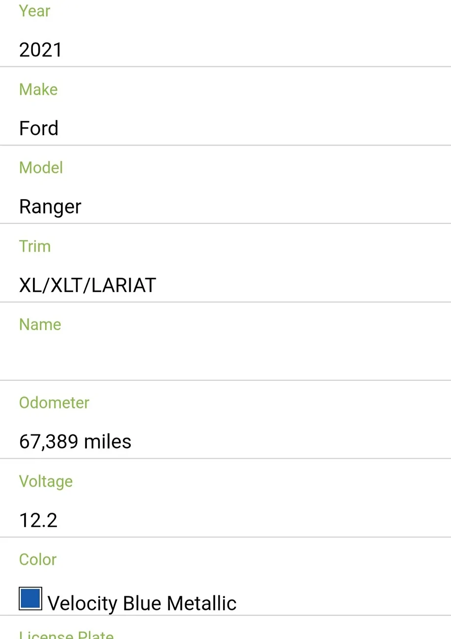

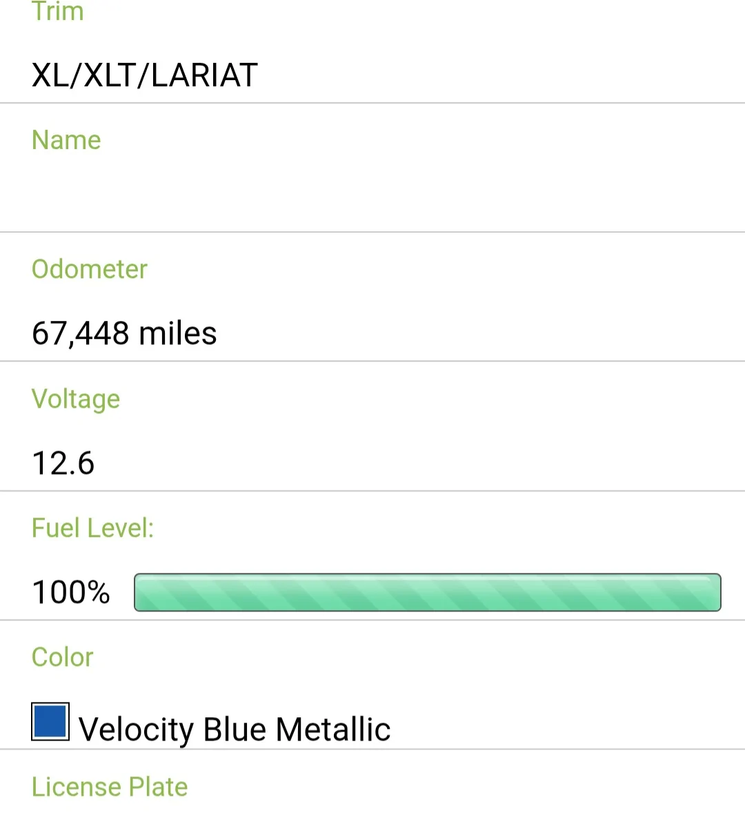

Walmart told me it was still testing good at 12.5 but it's still going down to 12.2 after sitting. i decided to get a newer one anyway. I drove over to ford and see if they'll put in h7 in it. Going to keep there old battery.

It is a Walmart Battery and has a warranty. Take it in and get a replacement.
Tried. Still test good on there test. Replaced anyway with different brand because I don't want to deal with it later. Kept the battery though.
