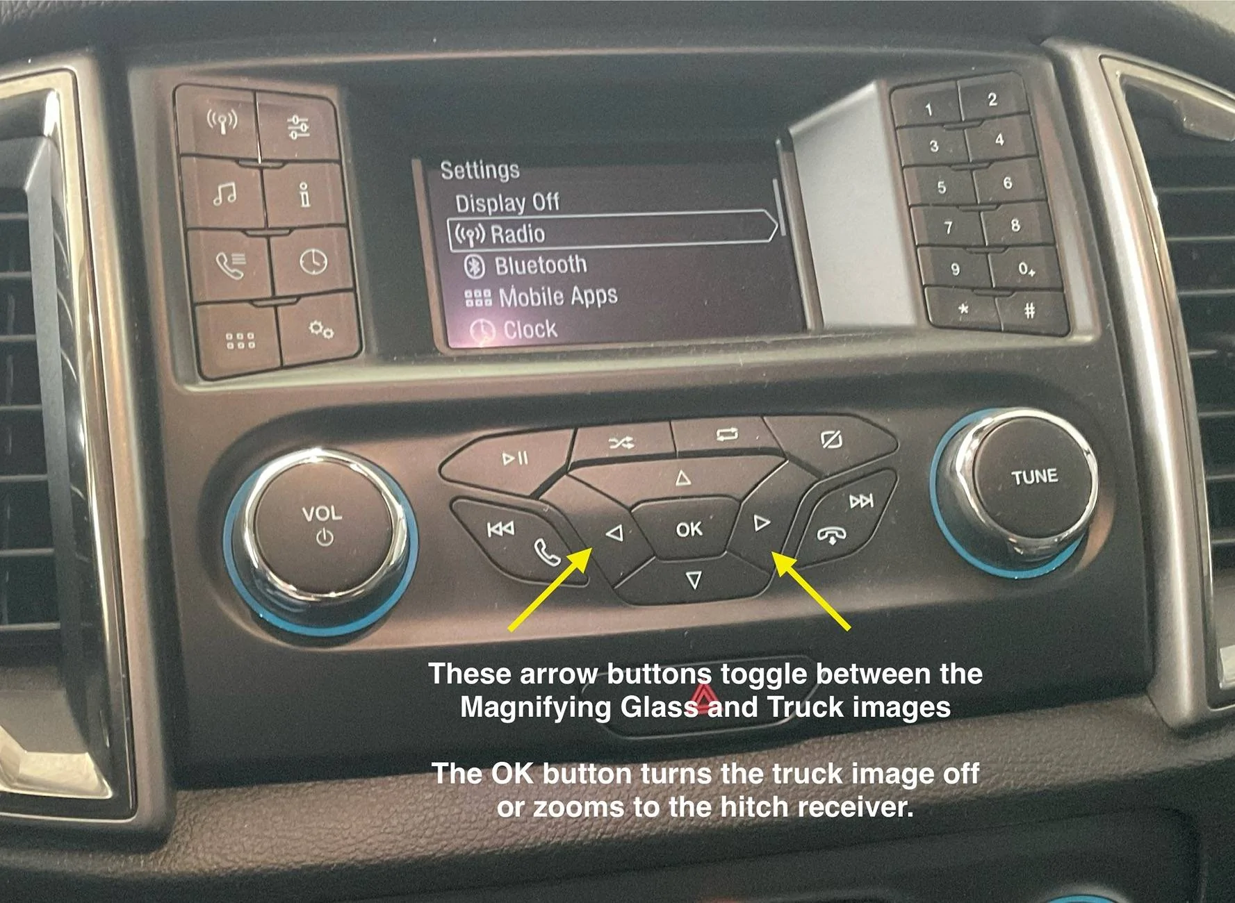

I can toggle it off on my 4” screen…
I can also toggle from regular view to close up on the hitch receiver…
I would think the same is available with a tech pkg.

OK looks like I don't have it.
I've got an XL and don't have BLIS or parking sensors (LOL, I also have the munchkin center screen). No little truck icon on those.
9,883
47,302
9,883
47,302
I also have the small screen, David. It’s likely not there on yours because you don’t have the parking sensors. We don’t need that feature here in Canada anyway because we always shoulder check…

I really never noticed this until this thread. lol So today I tried touching it (short and long presses) and it doesn't do a thing. But thanks to this thread I know see it every time I put it in reverse now. :devil:

You likely have to have rear parking sensors for this. Also, it defaults to normal after exiting reverse.

I also tried it.....good news/bad news. The + button does take it away. But comes back each time you put it in reverse. Still..... better than nothing. Thanks!
After checking closer ......the plus button takes the image of the vehicle away, BUT....it zooms in for trailer connecting most likely. So that mode does not give you the wide angle view when backing out of an angle parking space. So.....back to square one. Will have to try with Forscan......
