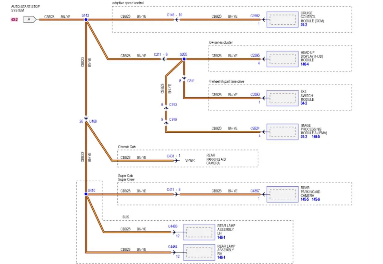

I see where the issue is: It explains all the latest voltage check results (lower and not equal with load applied) it also shows why the rear camera has (no voltage)
The Splice @ S410 is broken.
Note: For clarity (all 4 wires) are spliced together @ 1 point (ignore the dashed line)

One last test if you want, just a secondary check for continuity
Disconnect C408 - C4483 - C4484 and C411 all at once
At C408 - (REARWARD) Connector - Jumper Pin #26 to Ground
Meter - Ohms Scale
At Connector:
C4483 - Pin #12 to Body Grd
C4484 -Pin #12 to Body Grd
C411 - Pin #6 to Body Grd
Shold be reading 3 ohms or less on all connectors, but I suspect you will get high resistance with C4483/C4484 and VERY High resistance on C411
So most likely a broken splice point but possible that between C411 and the Splice is a short to ground. My gut tells me it's the splice point. We have at least confirmed the problem lies between the rear camera connector and that splice point.

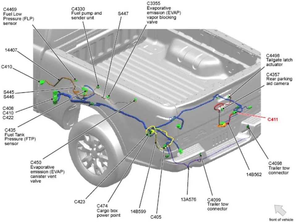

Find & Disconnect C411 - Connector
Do a check for power at Pin 6, same as above checks, does it match the readings that you had on the camera connector.
I want to eliminate the slight possibility that the camera leg from the splice being shorted to ground.
Is C411 the connector right before the harness goes into the tailgate? If so mine looks physically like the one above but only has 8 spots, 7 of which are populated. Using the numbering system above my connector would have pins 1-4 and then 5,6, and 8. I am currently going to do the continuity tests from the rearward C408 to C4483/84. Just looking for clarification with C411.

Yes, I checked another manual looks like they revised the connector, still pin #6 for power
Sweet, thanks for the clarification. I will check this one also then

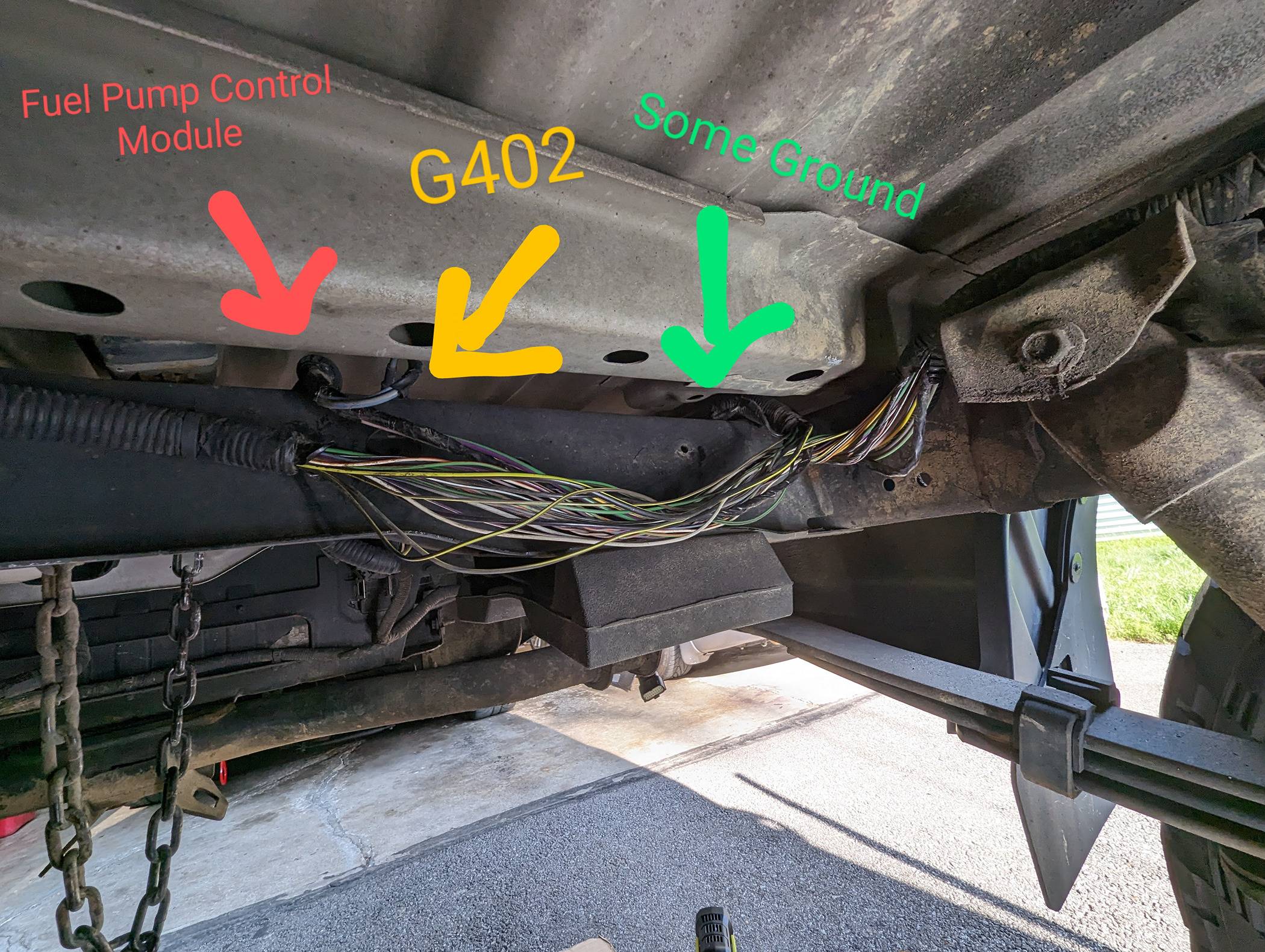

Struggling to find the splice, no surprise there... Wasn't sure if either of you had any more detailed location info. According to the connector locations linked above, S410 should be just outboard of G402 and C433, but I don't see any splices. There are some brown and yellow wires but they are all fully independent. Just wanted to confir here before cutting into more of the harness.

The splice S410 is located between the connectors C408, C411 Camera intermediate connector, C4483 BLIS, and C4484 BLIS.

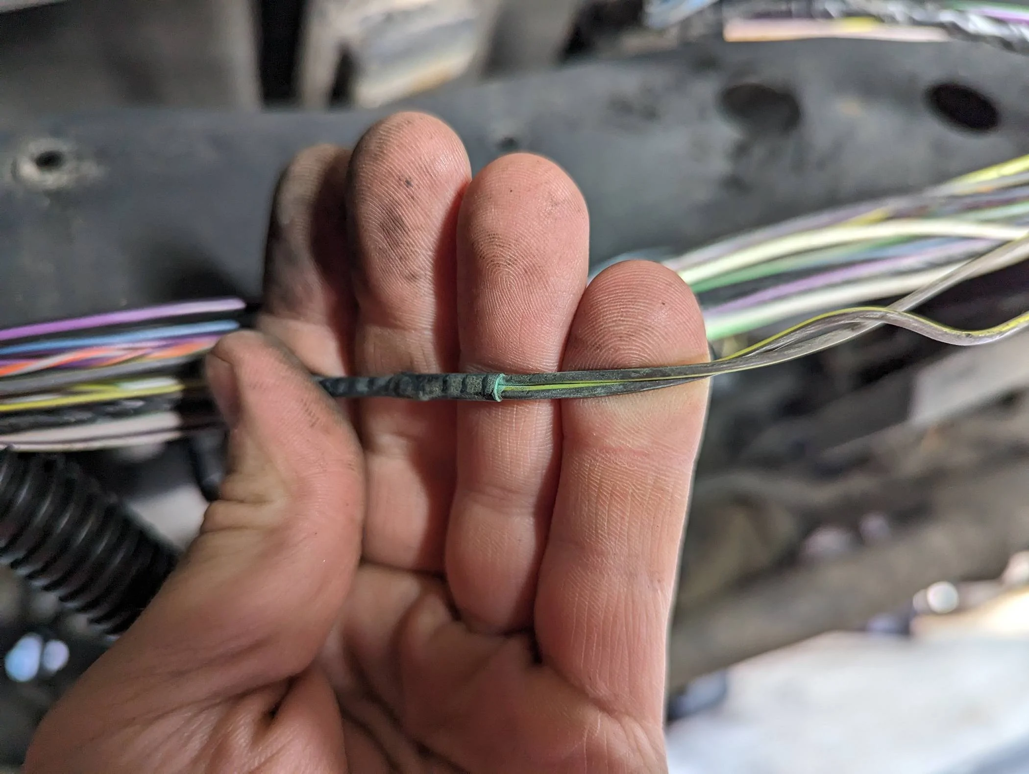

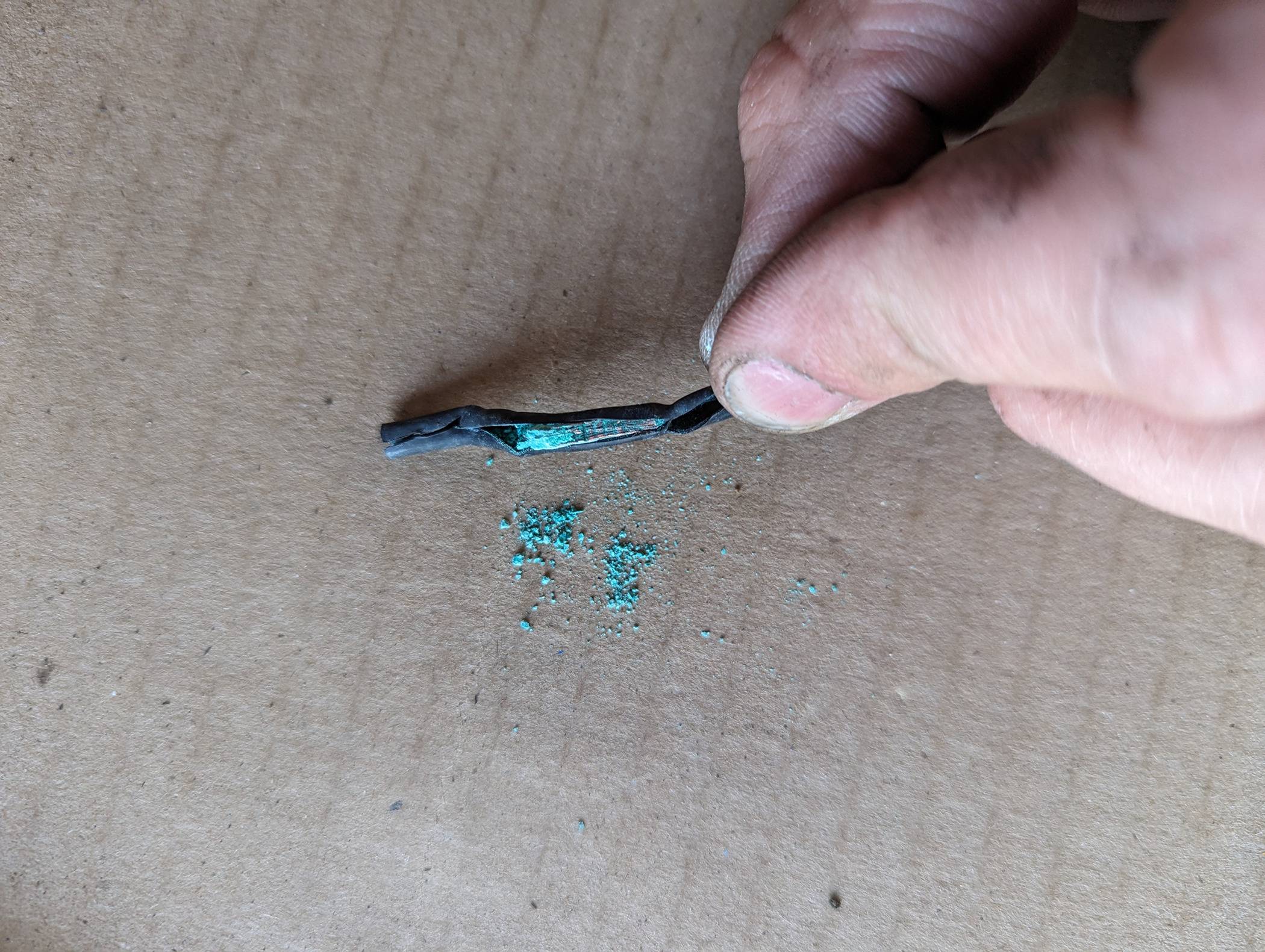

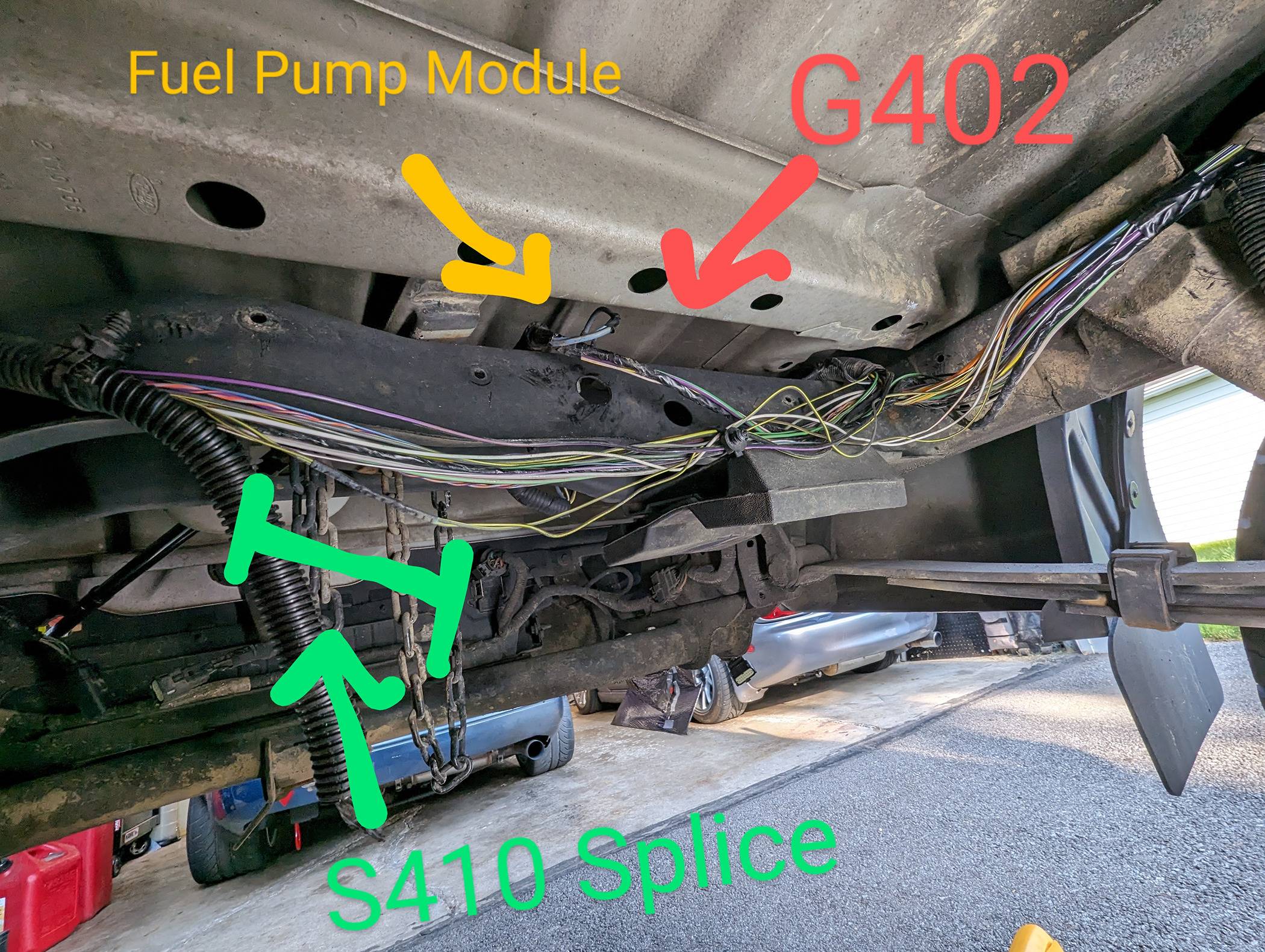

Splice found, not where it says it is on the connector diagram. Regardless, I think we found our culprit. Not sure how water got through the electrical tape, through the plastic harness wrap, through the heat shrink, and ruined this splice, but it did.
Also for anyone else who finds their selves in this unfortunate position, S410 is BETWEEN G402 and G400, not as indicated on the diagram. Will update once I fix the wiring.
