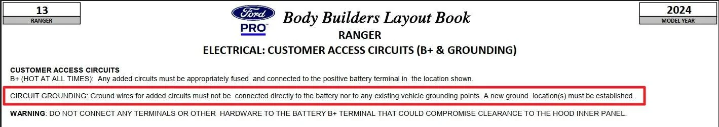

When charging the battery with your onboard charger that you shown there, you do want it to go through the BMS. How you have a go through the BMS is having the negative side on your chassis ground. That'll have it go through the BMS sensor versus if you had it connected directly to the negative on the battery.
I'm not clear on what your describing...I have the negative side of the charge going through the post the BMS is on...should it be connected directly to chassis ground?

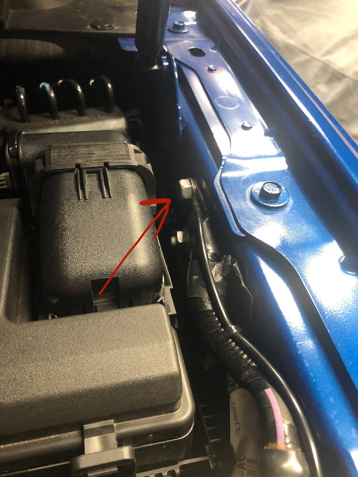

Mine is connected here.

That is the correct way to do it. When you have the charger with negative connected right there the charger will go through the BMS system. If you just connect it all at the battery itself it skips the BMS and the BMS doesn't even see it.
Same thing goes for any aftermarket accessories that are added on. They want you to go through a chassis ground instead of directly to the battery negative. This helps the BMS detect any loads so it can adjust accordingly in the correct manner in order to keep the battery where it should be and give the appropriate amount of amps and volts

Thanks Tony and Chris...got it sorted out now...chassis ground for negative...learn something everyday here...
