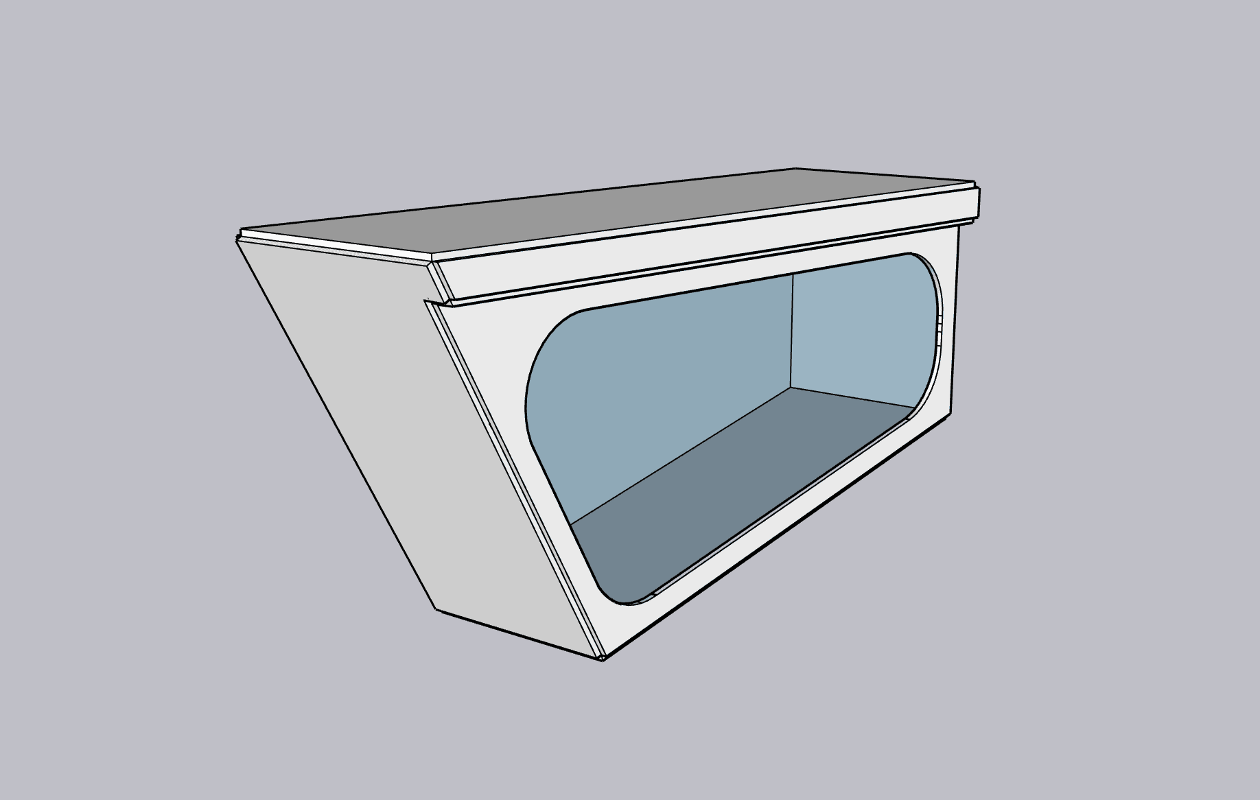

not sure if I am a huge fan of this design. I haven't incorporated the fuel filler only because I can't find any decent edge seals that doesn't have a bend radius less than 3". I have thought about putting the edge seal on the door but have an inner web holding the seal vs the outer structure. maybe Im just rambling about it and overthinking it too much.
