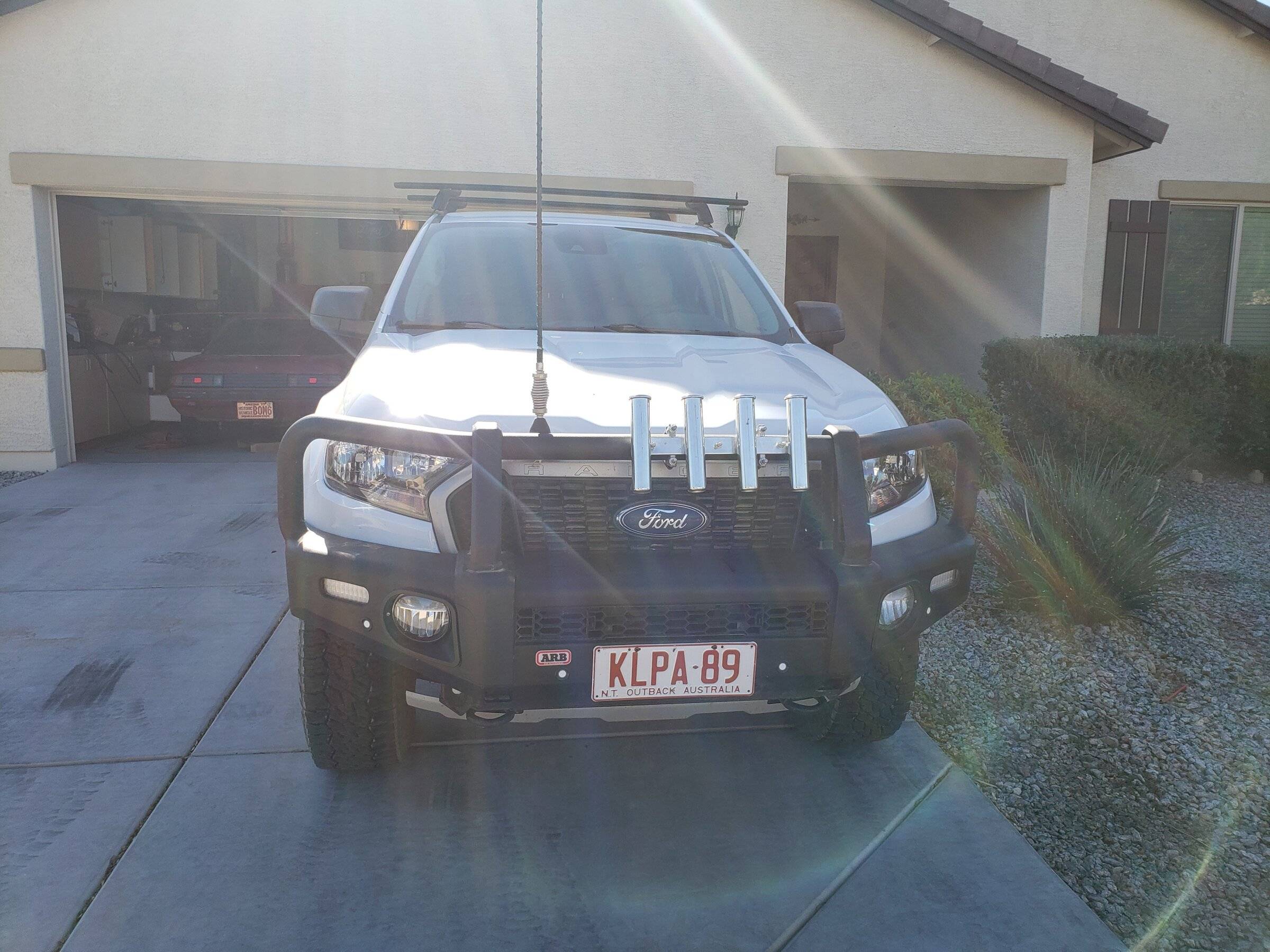

Whats your plan with the antenna? I've thought about ordering a UHF antenna from GME and having it re-tuned. Australian UHF frequencies are close enough to GMRS that it might work, assuming the antenna is tunable.
I found a small business that makes them and ordered one. If you go this route, just keep in mind that they are built to order. https://antennas.alamosa.mobi/ I ordered mine on 9/22, and got a shipping notice on 10/7. According to the Alamosa Antenna, a shipping notice means they printed out your info to get you in the build que.

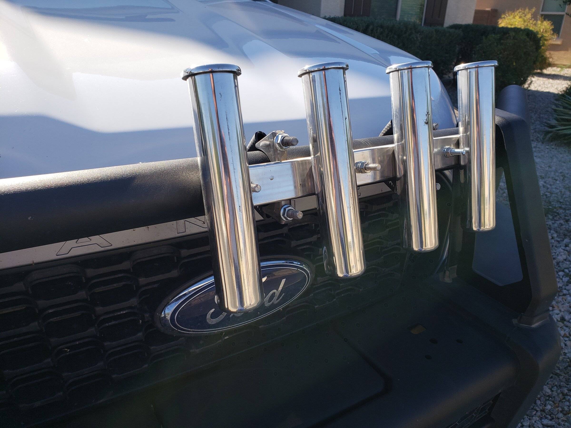

2.5in exhaust clamps welded to a 1in flat bar, and a rod holder from amazon bolted to it. You could do this without welding if you wanted though, just bolt it together.

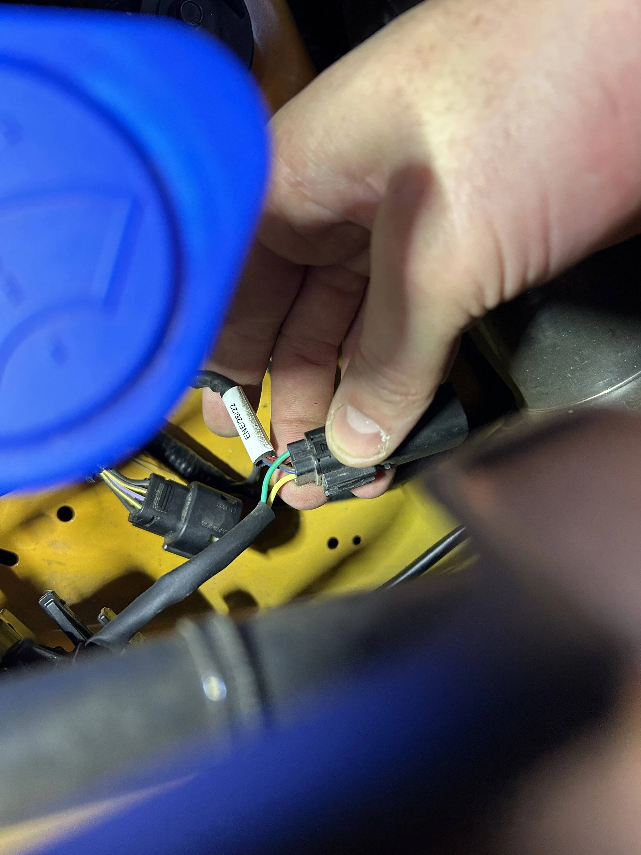

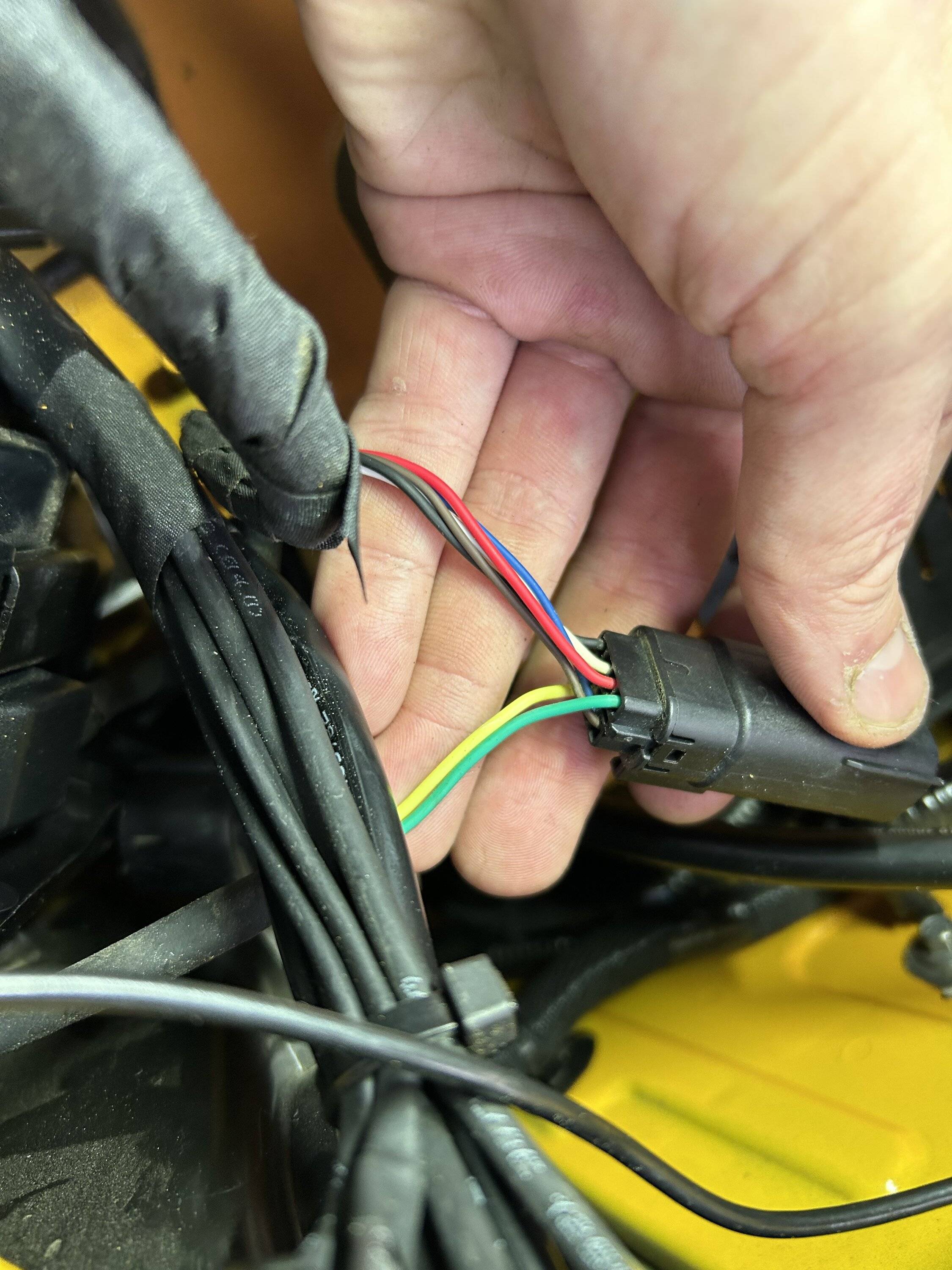

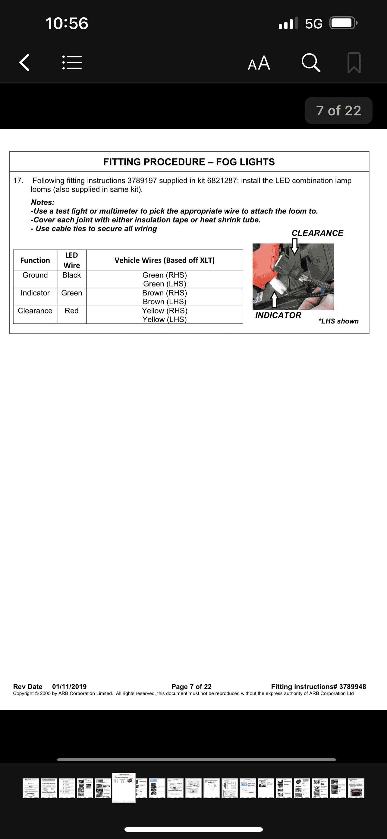

A few folks have asked about the clearance and indicator light wiring on the summit. I finally figured it out and it’s working well. ARB got the clearance and indicator wire colors backwards in their instructions. It should be red to brown and green to yellow
I wish I could star this post to come back to!

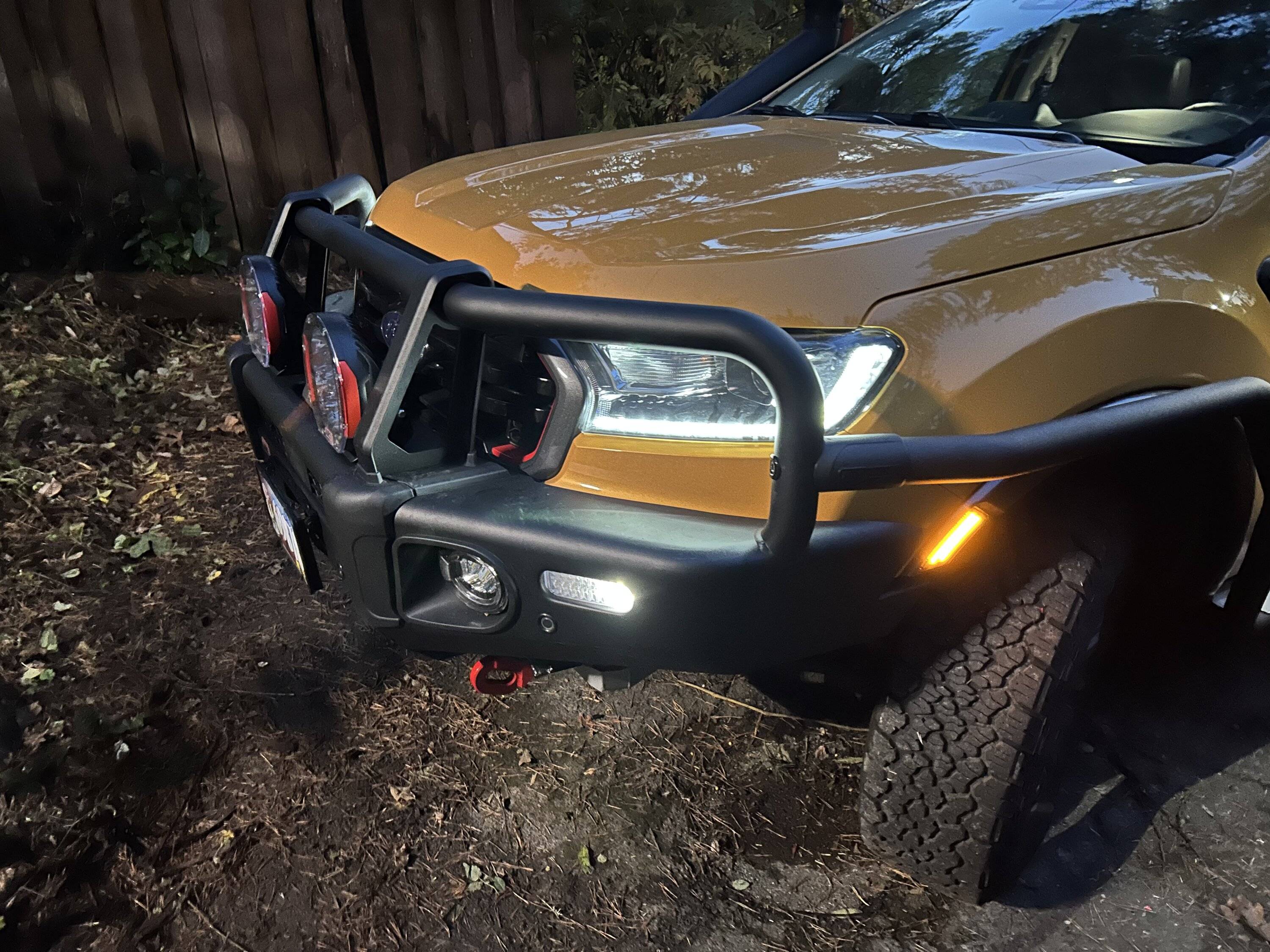

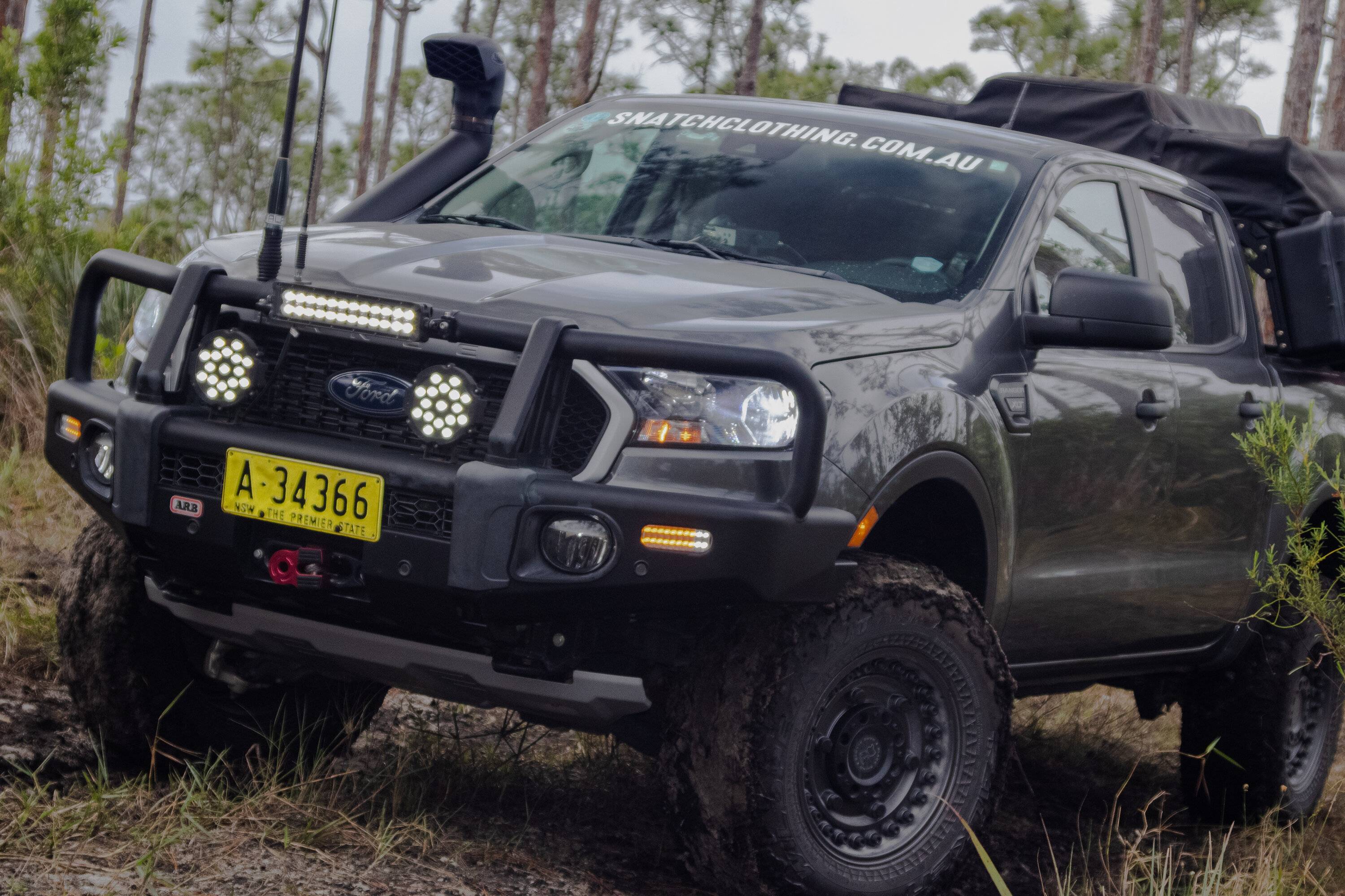

I got my ARB installed this last weekend. I’ll be wiring up the lighting this weekend.
the OP mentioned needing 3 people to install without an engine hoist and I agree. @Nopalito And @UnregistredHypercam2 to the rescue.
Looks great!
Do yourself a HUGE favor and ditch that Badlands hook. Mine rusted out pretty fast.
