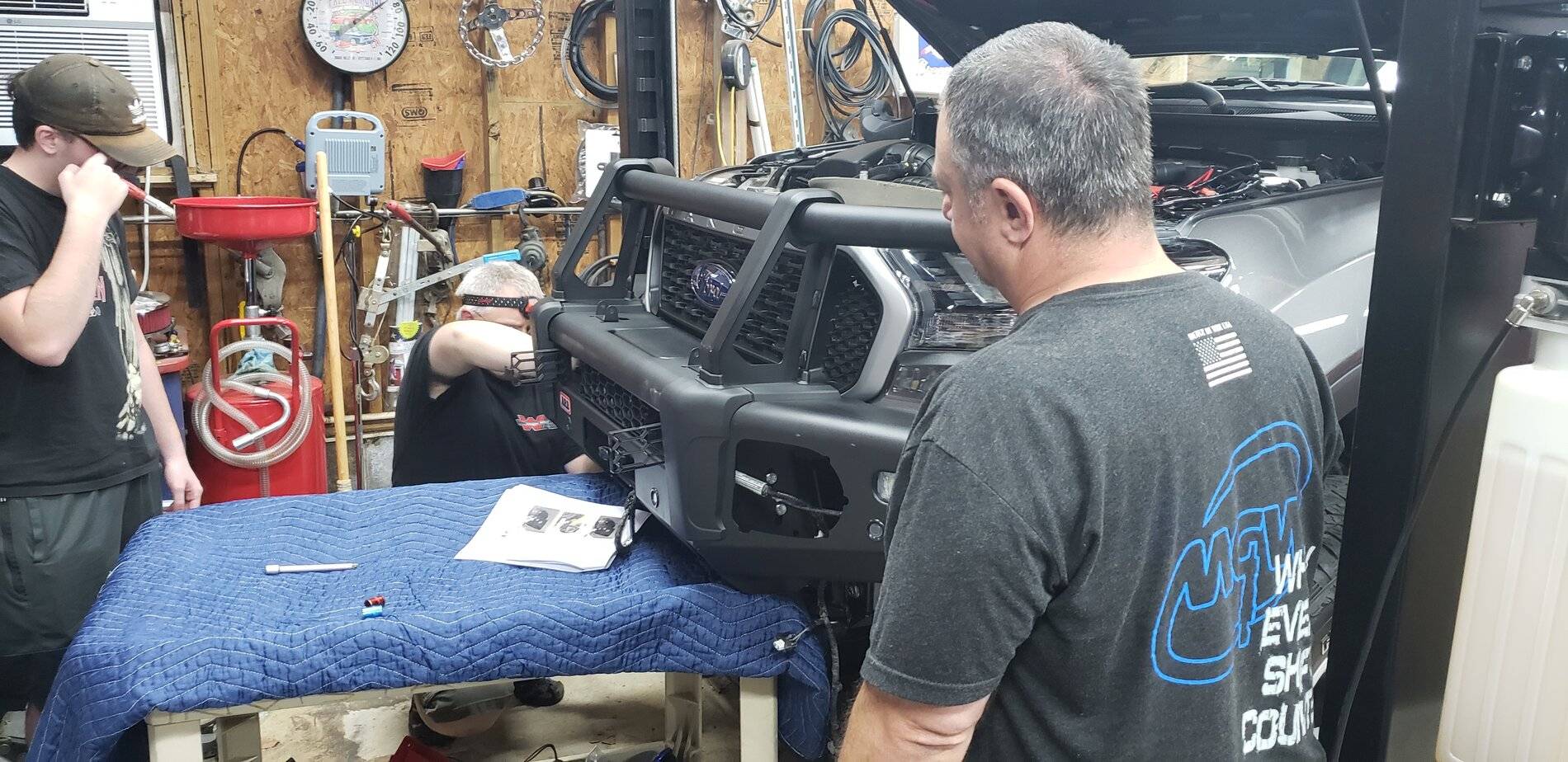

I got lucky when I went to put mine on. I have a friend with a lift in his garage, so we put the bumper on an utility cart and moved the truck up and down until we were at the perfect height. Then all we had to do was roll the cart forward and bolt up the bumper!
I like it! I will be installing this at the shop I used to work for and will likely be doing the exact same thing, haha.

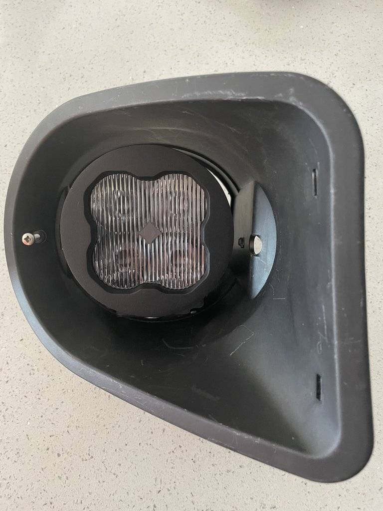

Appreciate the input! I am wondering if the Eibach 3” with springs will be enough.
Also, you wouldn’t happen to have an image of the back of the fog light assembly? I have a set ofDiode Dynamics yellow SS3s in my factory fog light holes and am wonderingI could make them work with the bumper.

Funny you ask! No, I don't have a photo of the backs. But there is a company that makes a relatively inexpensive bracket to fit different fogs into the ARB buckets. I'll have to dig it up for you.

Here you go:
https://www.paranoidfabrications.co...epbzNoFD-sip0hj9OlkDzLh7Ph1RfmrBgkTTaEdPTwIL4
I don't know if that's going to help you or not with your fogs. It might! There is a drop down to select a Diode Dynamics fog bracket!
