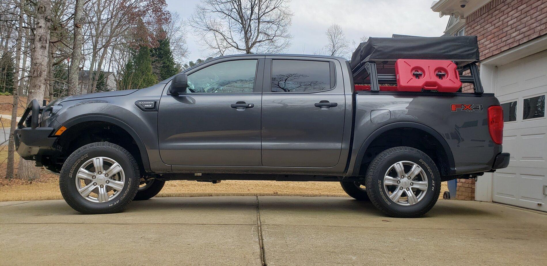

That Summit bumper looks great! is a leveling lift recommended or would it be ok with stock suspension?
I would do a 2.5in leveling kit, I have the readylift 2in and it has a little more rake than I'd like.

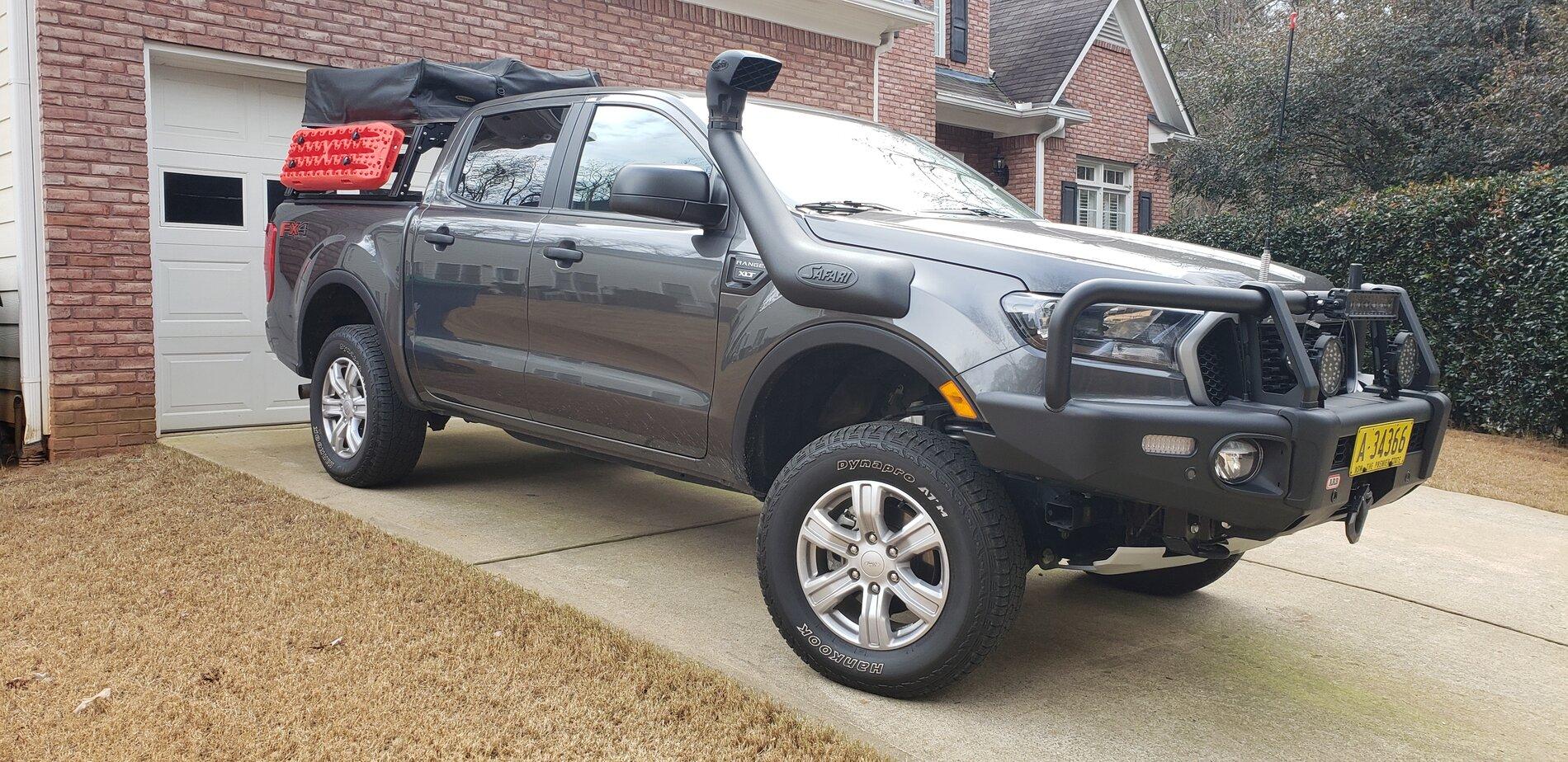

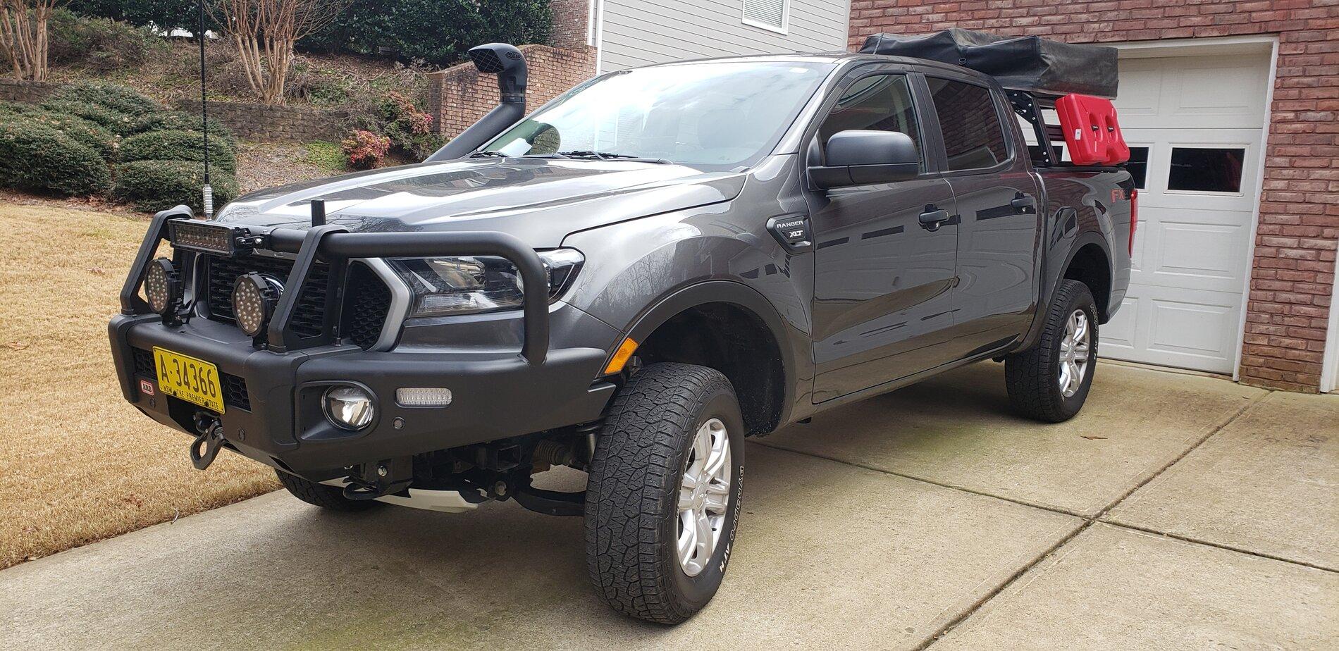

I love the bumper. It was worth the exhausting day to install it!

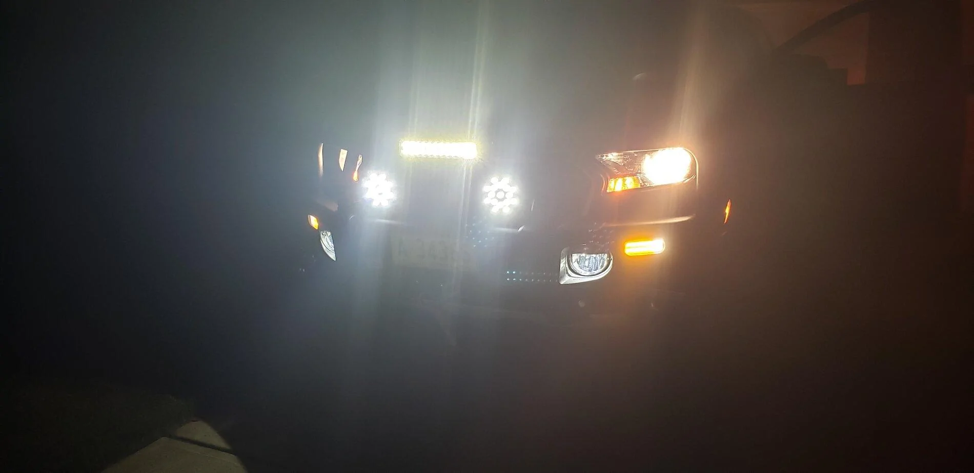

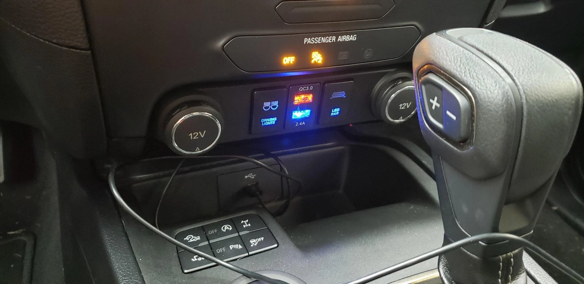

Thanks for posting the photos! Your install and bumper looks amazing. What lights did you install? What did you do with your light switches? Future plans?

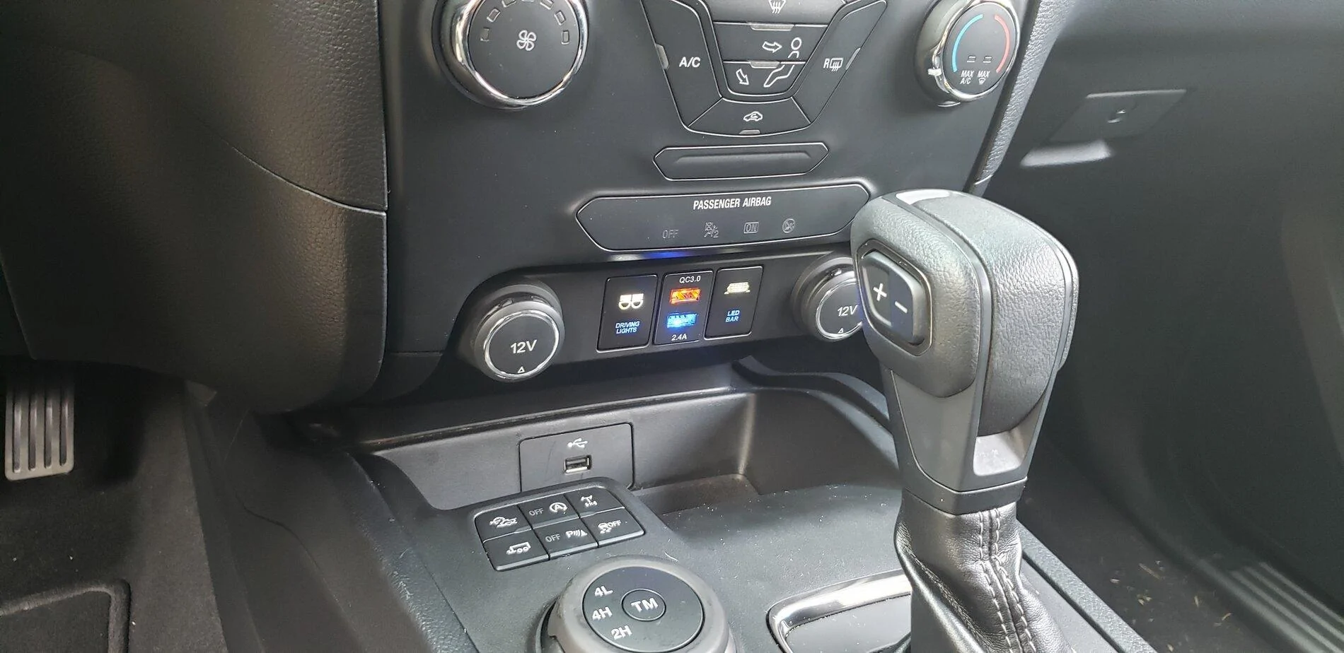

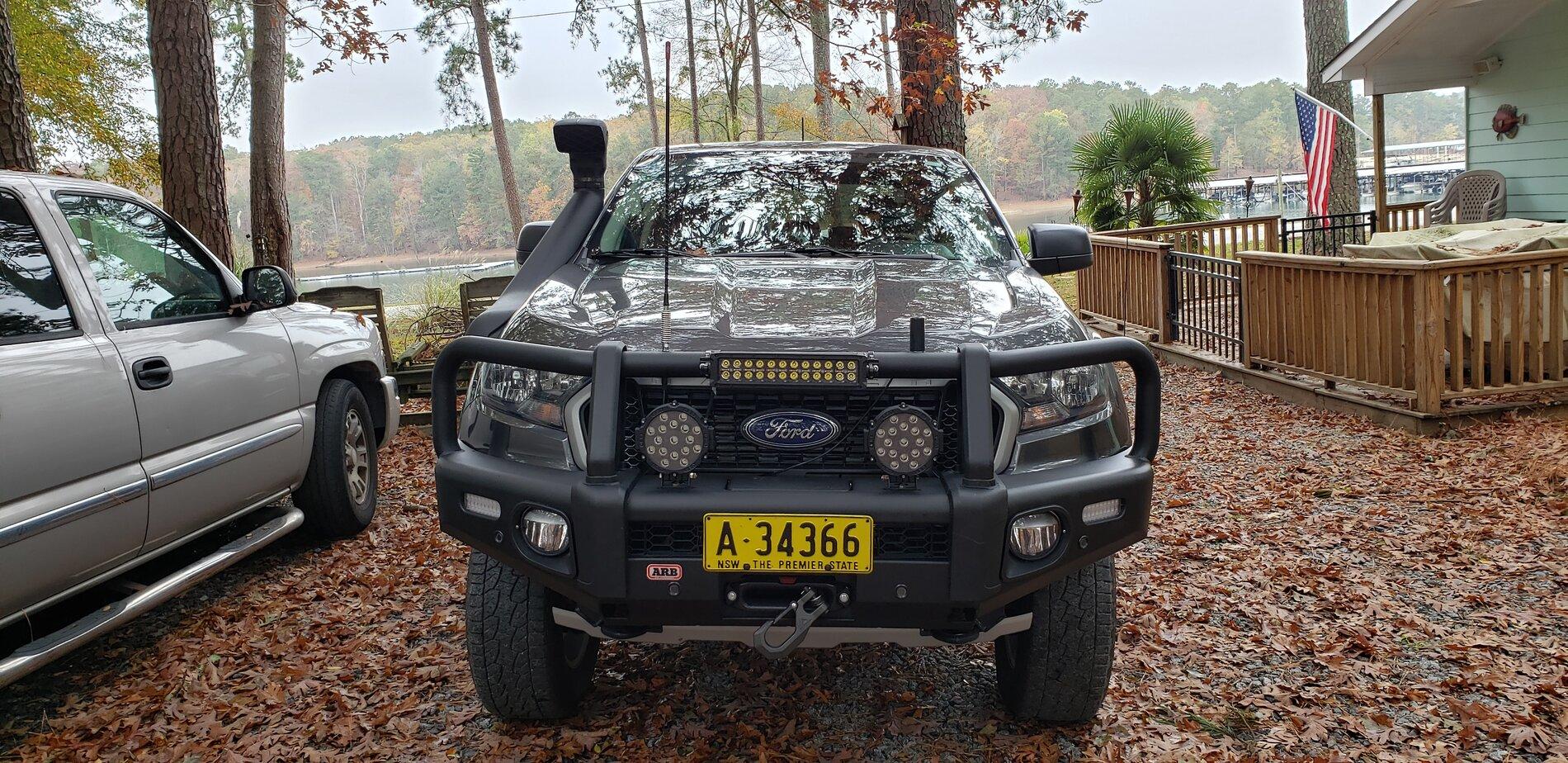

So the bumper came with corner marker/turn signals (amber) and fog lights (led ovals) that you see mounted in the bumper. The Round lights bolted to the top of the bumper are from Amazon (I think a set was $46ish?) and the short light bar is from Rough Country ($120ish?). I used two off-road light wiring kits with relays to power them, and ran them through the firewall to a LightForce switch fascia kit that uses Toyota switches to turn them on an off. the lightForce switch fascia has provisions for three switches, and at the time I only needed two for lights, and I wanted more phone and electronics charging capabilities. So in the middle of the switch fascia I have a dual USB charging port. In the future, I may move this to inside the center console and add another switch for a chase light or rear rack lighting.

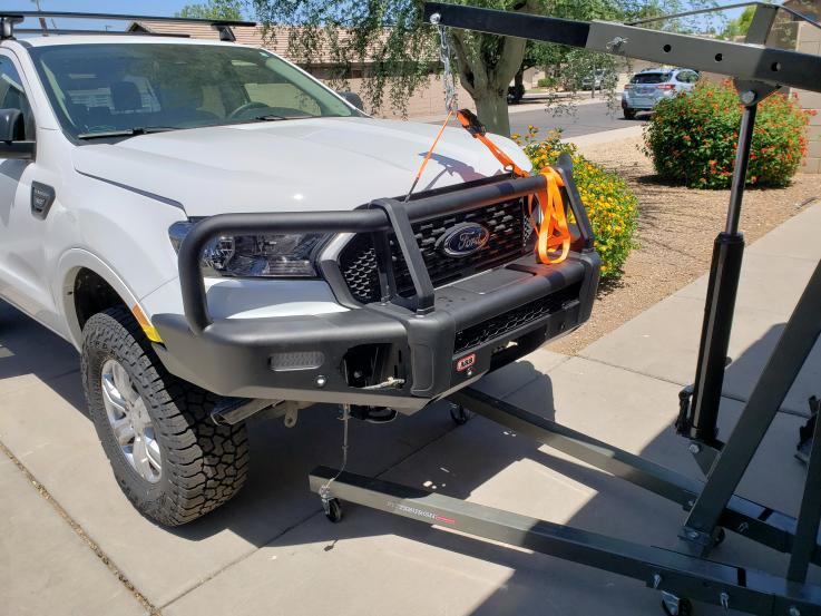

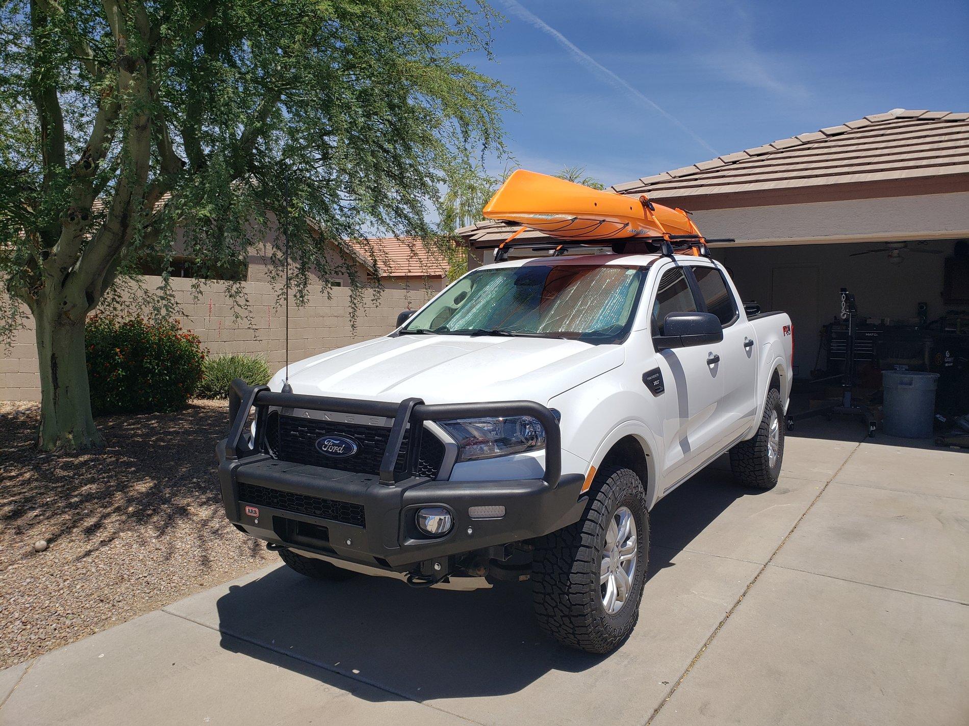

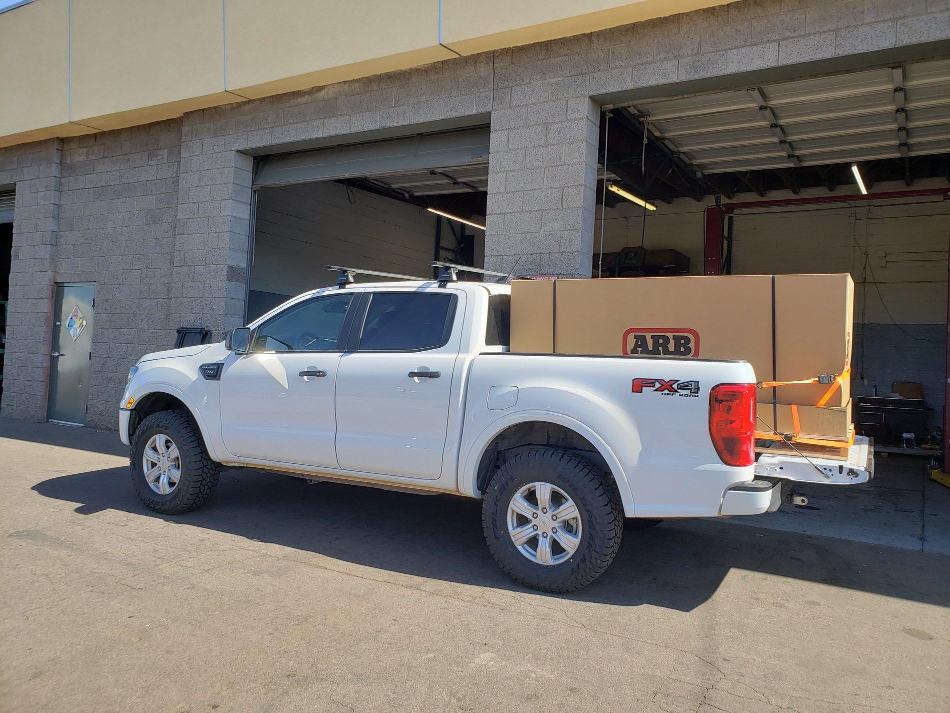

A few people have asked me questions about the bumper and the install, so I thought I'd make a thread so everyone can ask questions and answers can be shared.

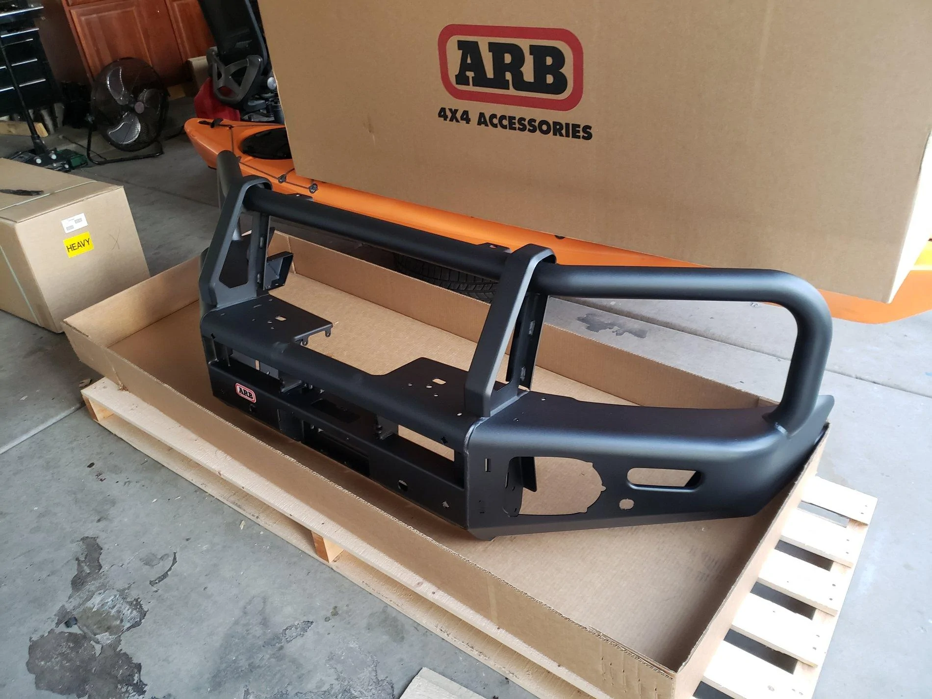

The bumper came in a massive box, it sat on the very edge of the tailgate, everything was packaged very nicely and every piece of the bumper was in its own little box.
The install took me about 3 mornings to do, living in AZ I wanted to stay out of the heat. Everything is pretty straight forward, I found the instructions to be very good. I recommend using an engine hoist to fit the bumper, it makes it so much easier, and there is less risk of you damaging the paint on your truck. It could possibly be done without it, but you would need three people to do it, two to hold it and one to run the bolts through. Note that you have to mount the bumper, mark where to drill 4 holes, remove it, and mount it again, and the engine hoist really helps when you are trying to line everything up.
The wiring on the bumper is NOT plug and play, but its really not a big deal. The fog lights come with deutsch connectors, I opted to cut these off and use a standard H11 male head light connector so that I did not have to modify the harness from the truck. I bought the connectors from NAPA, part number HWH101, ($10ea), its a complete harness with with both male and female connectors, just cut it in half and use the male end, splice it into the ARB light. The indicator lights come with some clamp connectors, also pretty easy, you just need a test light to figure out which wire does what. I believe the truck side was green-ground, yellow-indicator, brown-running light, but double check.
One user said that they had to bend the wing panels that go under the bumper, I did not experience that, but I am only running a 275/70r17 tire, so I had no clearance issues.
