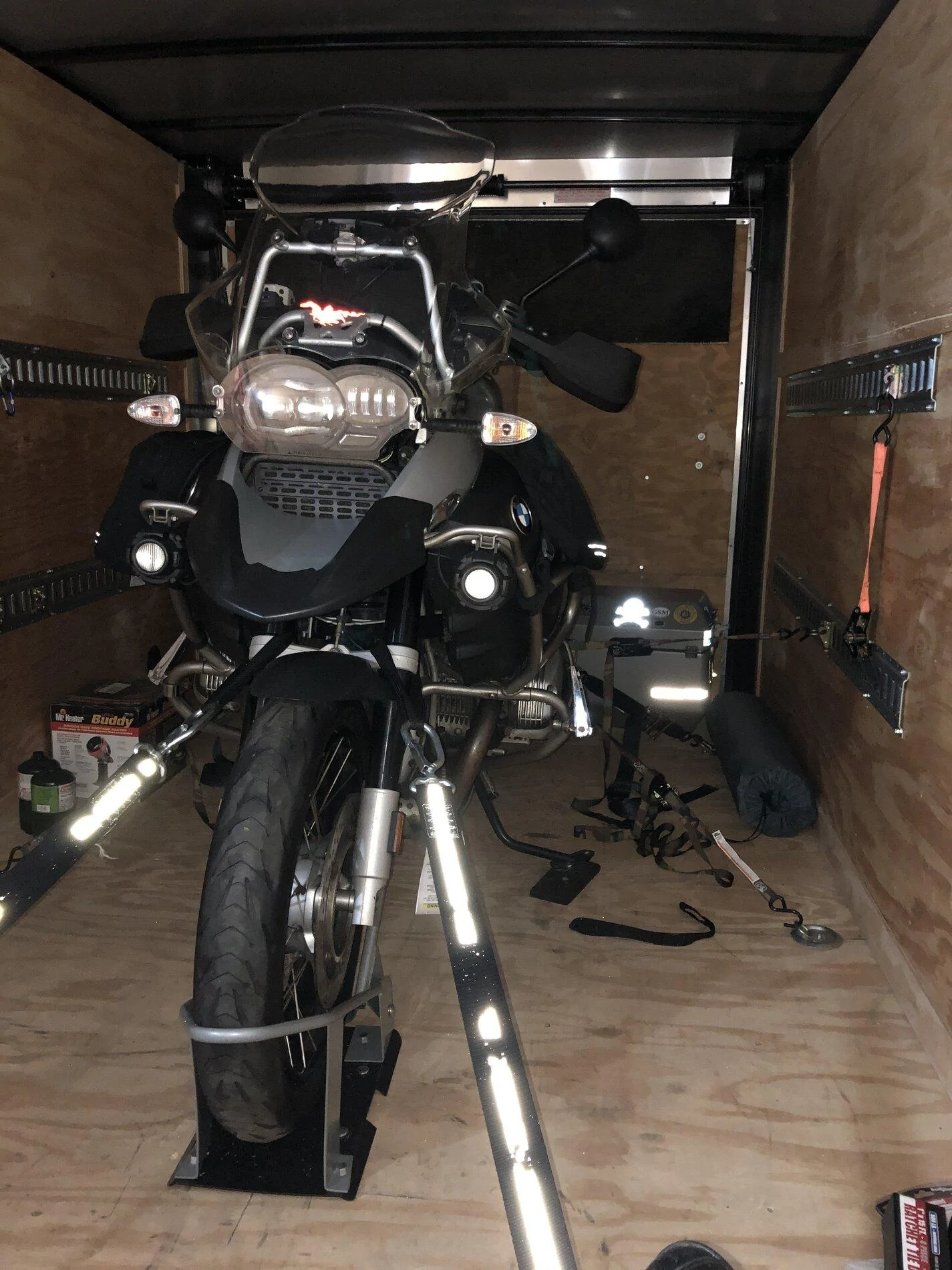

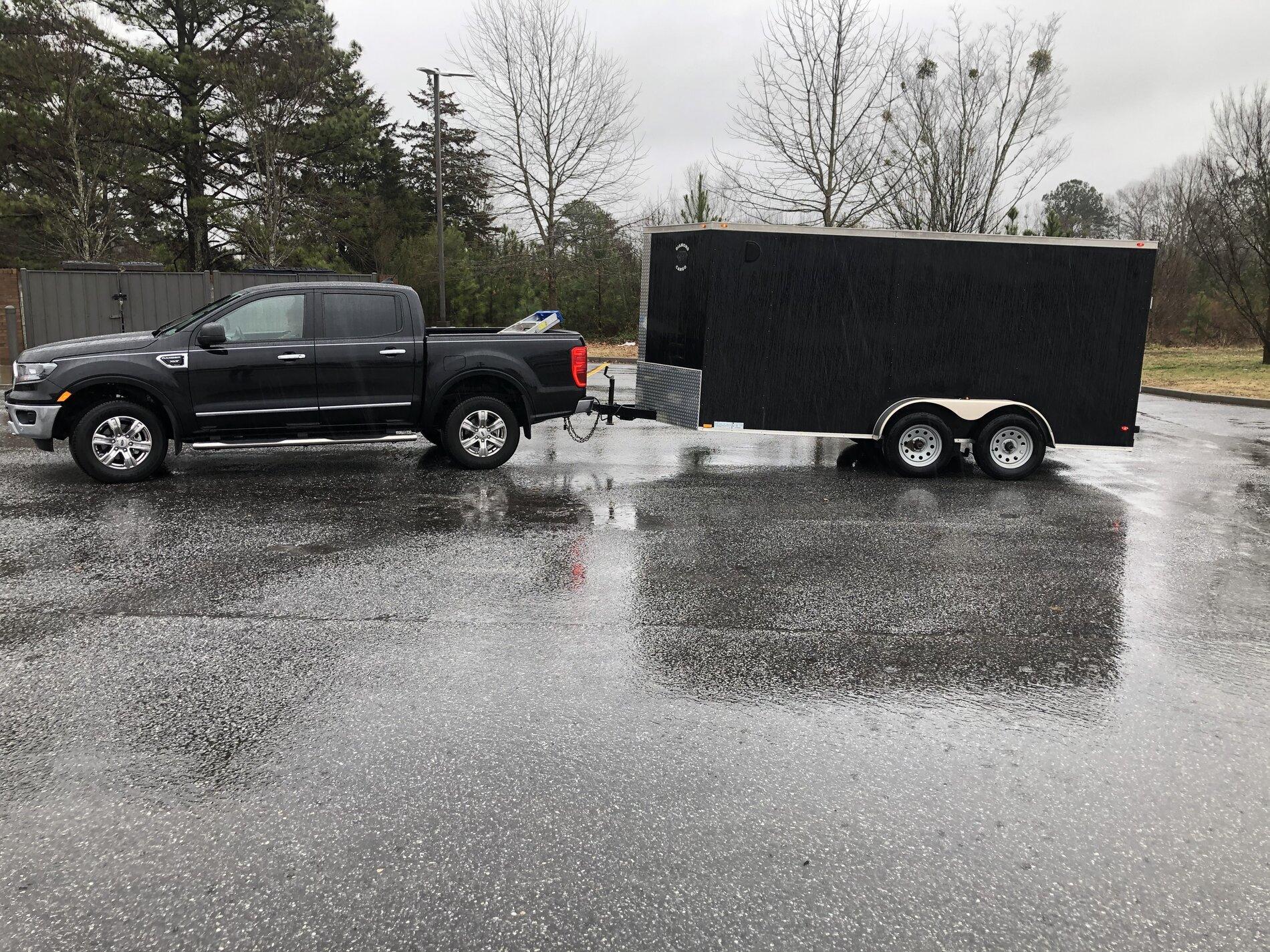

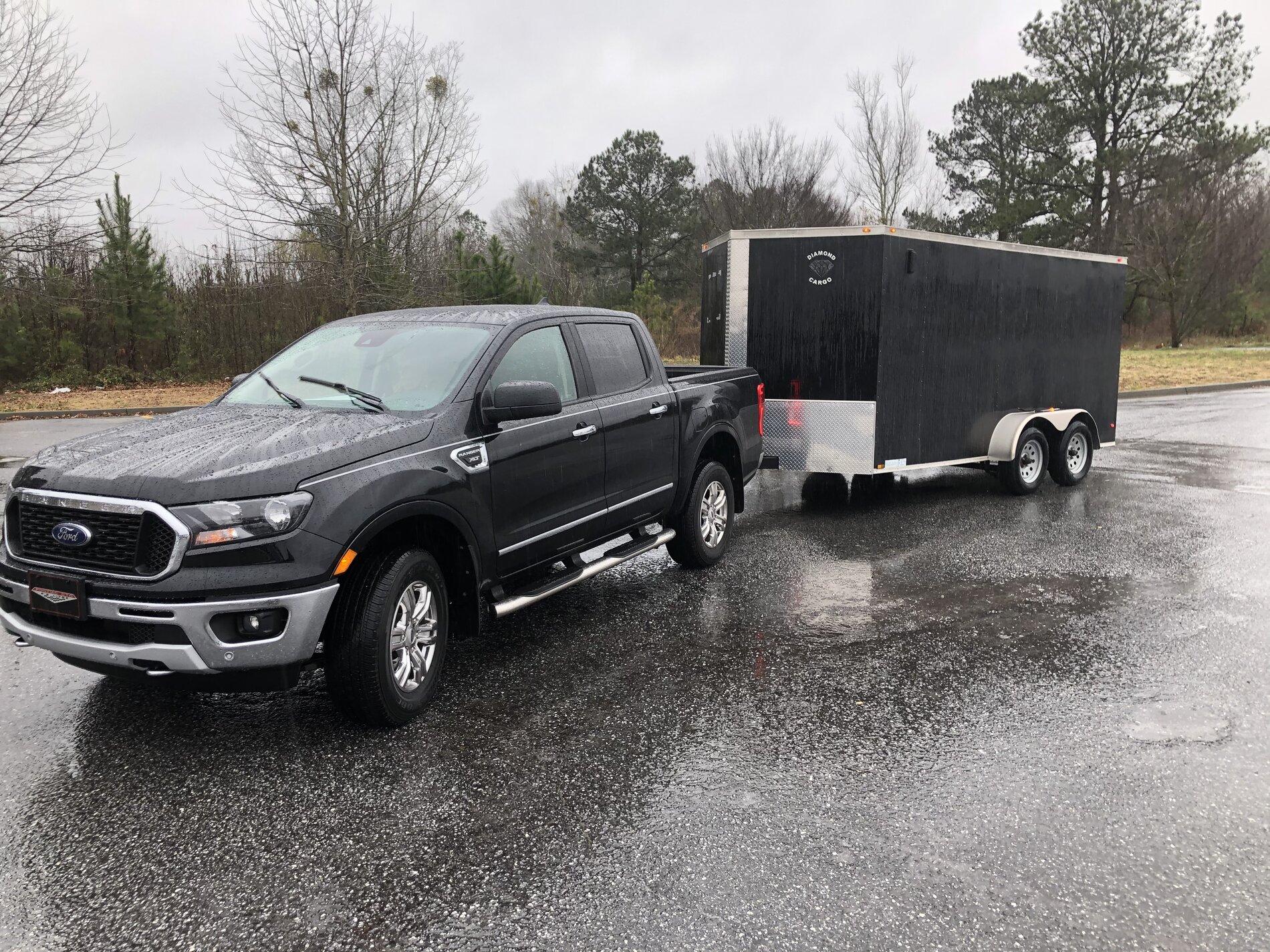

After I retired at age 64, I began riding, after a lifetime of sailing. Went every place in US I desired, including Canada.
Three bikes for a total of three hundred sixty-five thousand miles, including 107 thousand trouble free miles on all three; only one flat tire.
So, at 78 y old, and because “Mama” it’s my case about riding so far on the bike, I succumbed, at least to three weeks in Fla and Bike Week.
if I can post a picture of my 2017 rig, U will.
my Ford dealer service folks charged me 703$ for a brake controller and installation. Must have been hard as it took a day!!

Um...I would recommend a drop hitch...trailer angle is way too much...JMO.

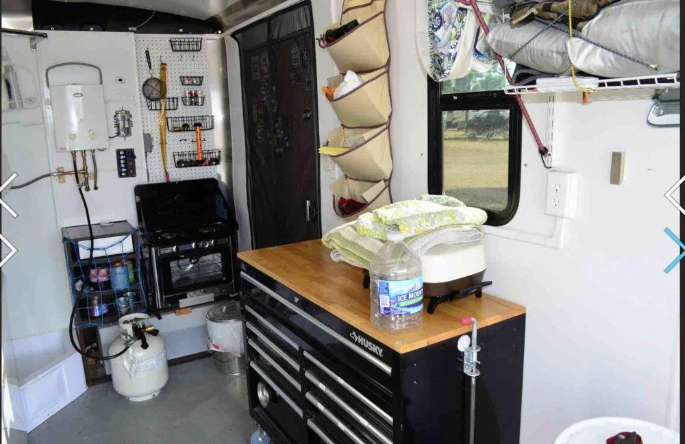

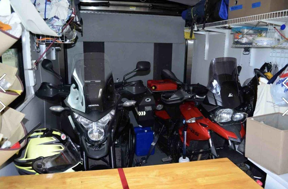

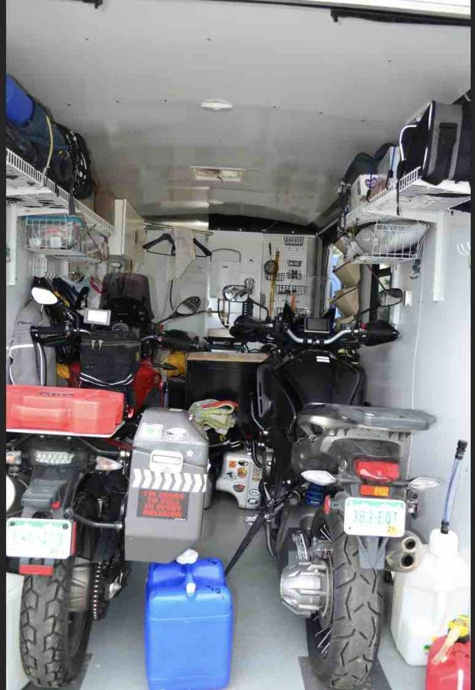

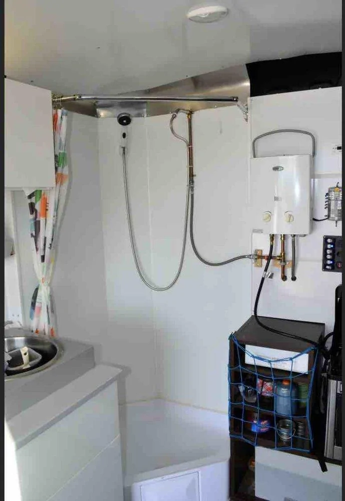

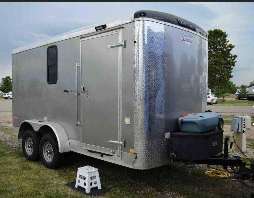

I have a friend that has this for sale in CO, it's built out really nicely and not just a simple cargo trailer.
It has:
Trailer Features
Cargo Mate 7’x14’x7’ enclosed cargo trailer. Steel frame and structure and aluminum wall skin and single sheet aluminum roof.
  • Tandem 3500 lbs axels
  • Four new tires ST225/75R/15 TRAVEL STR HF288 10 ply. 07/15/2020
  • Axels have been flipped to raise the tongue and frame clearance 6 inches. Axels and coupler were laser aligned when flipped. Wet bolt system also installed. ($1300)
  • Four wheel electric drum brakes and 2-5/16” coupler
  • Walls and ceiling are insulated with 1” foil covered foam insulation, 3/8” plywood and covered with white 1/8” hardboard.
  • Ceiling vent with fan and one side window
  • Drop down tail gate has 12” wide Grip-tape for traction for loading and off-loading motorcycles
  • Trailer electrical independent of tow vehicle
  • Water proof electric box on trailer tongue
  • Three dual plug 120 VAC outlets conveniently positioned inside, 20 amp breaker in electric box.
  • Camp Chef two burner propane stove and oven
  • Marey Instant on propane hot water heater
  • 36” neo-angle shower, someone 6’5” could shower in this
  • 20 gallons fresh water and 25 gallons grey water
  • Sure-flo water pump
  • Ikea Four drawer 36” kitchen cabinet with 15”x6” round sink
  • Ikea storage shelves
  • 12 feet of Wire rack shelving
  • 6 feet of L-Track system installed in three locations on the floor for L-Track tie downs for motorcycles
  • Will carry two full-size adventure bikes with panniers side by side
  • Will include Blue Ox SwayPro® Weight Distributing Hitch ($600)
What is in the electric box
  • Two 100 ah deep cycle batteries
  • Magnum 1000 watt pure sine power inverter
  • Progressive Dynamics Charger/Converter. Used to charge house batteries when plugged in to shore power
  • Progressive Dynamics auto switching unit. This automatically switches between 12 volt DC system and 120 volt AC system when plugged in to shore power.
  • Blue Sea 12 VDC fuse box with 12 fuse slots
  • 20 amp shore power plug SAE 12 VDC external output plug (Used for 12V air pumps, water transfer pumps, etc.)
Not Included
Tool chest, Tie Downs, Blue Boy, wheel chocks and propane tanks
"I bought this trailer new, I had it ordered with 7’ ceiling. This is not just a cargo trailer, it has been built out to support full-time motorcycle travel. It holds two full size adventure motorcycles, is fully insulated, has a full kitchen, instant on propane hot water, a shower, sink and counter. There is an electric box on the tongue that has two 100 ah batteries, a power inverter, battery charger and shore power auto switch. Solar can be easily added. "
He wants 9700.. seems like a good deal given this setup. Let me know and I'll give you his contact info.

A 7 x 14, tandem with brakes of what I bought. The Ranger has o problems towing it, but I’ve yet to tie up in The Blue Ridge Mountains-Parkway, too far up the road.
Got 12 MPG overall on my Florida trip, including some truck solo time.
Yes, Phil!
Agreed. Wasn’t happy with the look either. Consequently, I purchased a 4” drop hitch, to replace the 2” drop. Tows better and sure looks better. I believe a 5” would be perfect, but whats’s an inch? Right?
