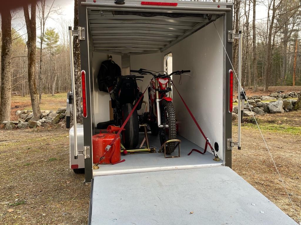

I tow a 5x10 with 2 motorcycles.
Easy. Peasy.
6x12 seems overkill for one bike.
Trailers are somewhat regional. There are national brands, like Wells Cargo and others that may not be available everywhere.
Dealers order well in advance of their season, so what you find on lots may not always reflect the best possible selection of configurations.
Shop around an look them over in person. Find a good dealer and ask what the possibilities are.
Steel frame vs. Aluminum?
1/2 inch Particle board interior vs. 1/4 inch lauan?
RV-style door?
Ramp back?
Flooring?
Finish?
You get the idea

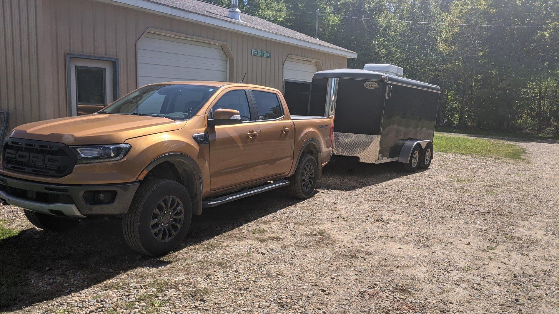

RC Brand 6x12 V nose with an AC unit. Weighs 2300# empty. Three crotch rockets for the track, a generator, and a whole bunch of other crap that brings it well over 4000#. Towed it from Michigan to California and back at 70mph the whole way. Up over the Eisenhower Pass (11,158' elevation) west of Denver and across the American Southwest.
Like a champ.
A six foot wide trailer is as wide as the truck, so the stock mirrors can see along the side of the trailer just fine, and whatever is directly behind you is their problem.
Other people tow MUCH larger trailers than this. A 14 footer would be no problem. I have 56,000 miles and don't have second thoughts about hooking onto this to go across the country. This truck is a beast.
Get a weight distributing hitch, though. Makes a world of difference.
