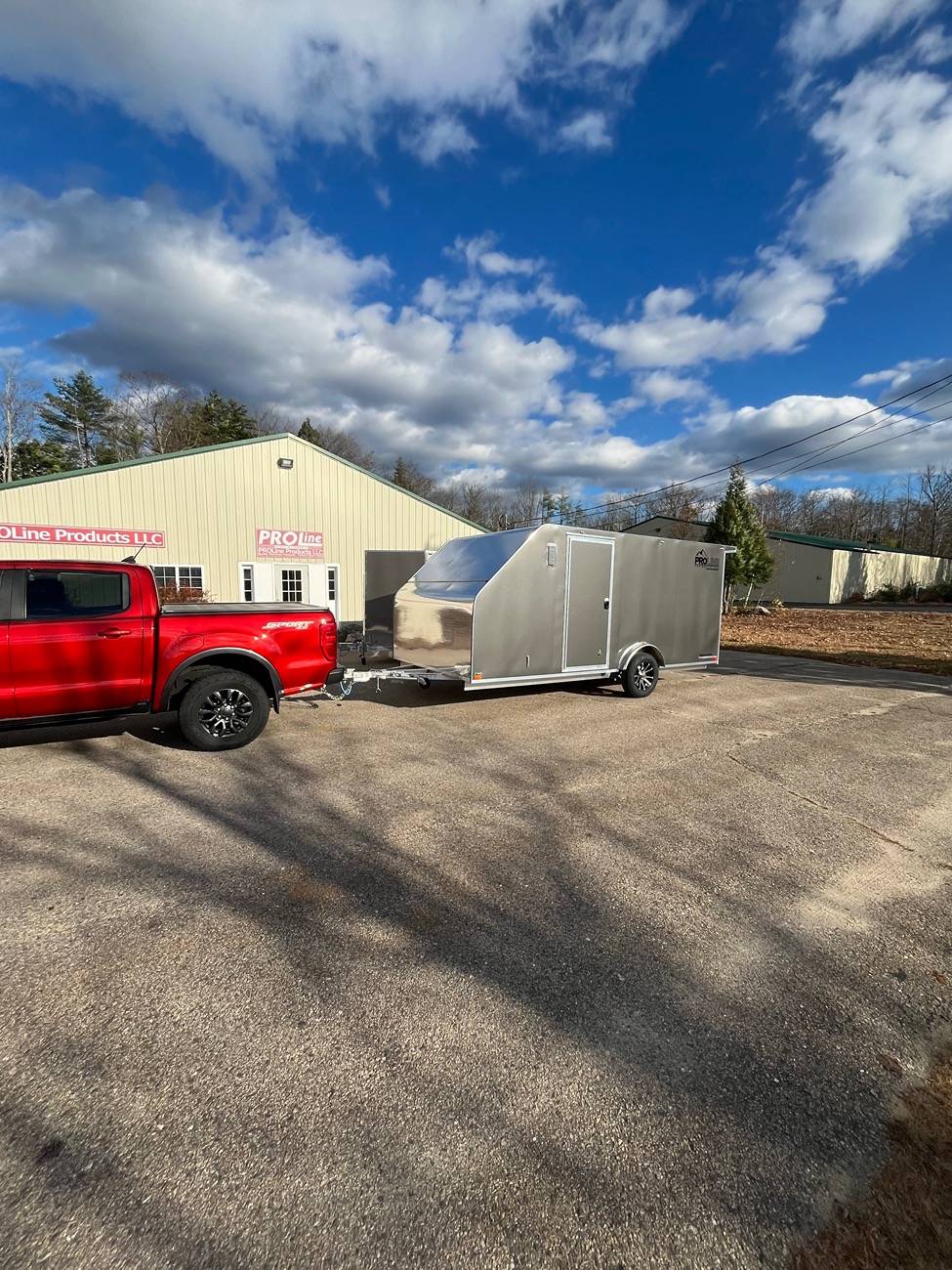

Here is a picture of the 7.5x 16 trailer that I have towed 2 sleds with thousands of miles.
I am a big believer is brakes which also presents a challenge with our Ranger’s as you need to purchase and install an aftermarket brake controller.
Very happy with how it tows.

Nice looking trailer there. Does it have trailer brakes?
Bsenecal
Brian
May 21, 2020
649
1,847
Milton Vermont
Military
Absolutely, I wouldn’t own one to tow I. The wi tee without them. It was a $400 option.

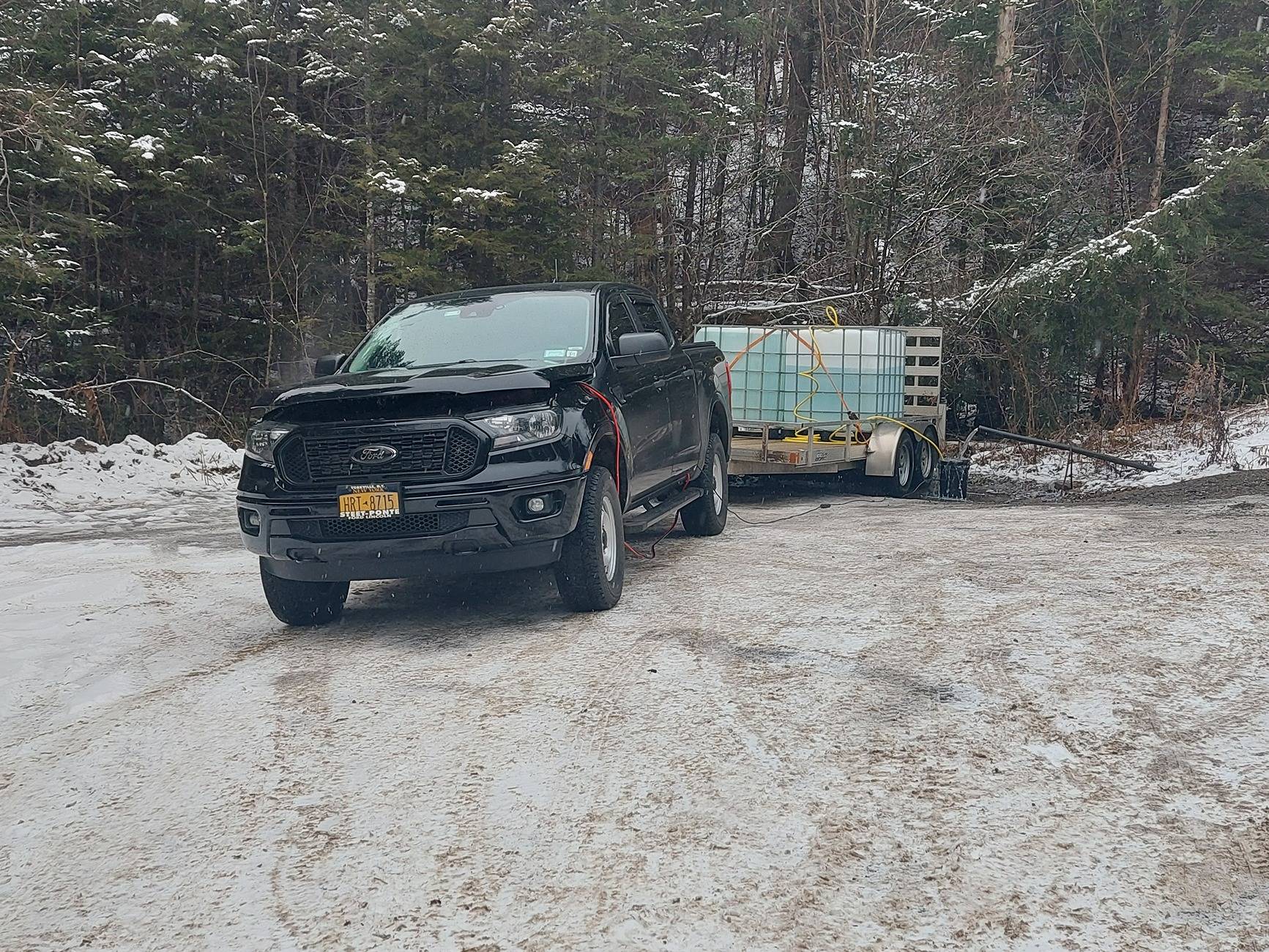

I tow close to 7000lbs every weekend 40 miles even in winter no changes from summer other than winter tires for the truck. I also use a 7x16 enclosed trailer as well never had an issue with it, but trailer brakes are key imo.
