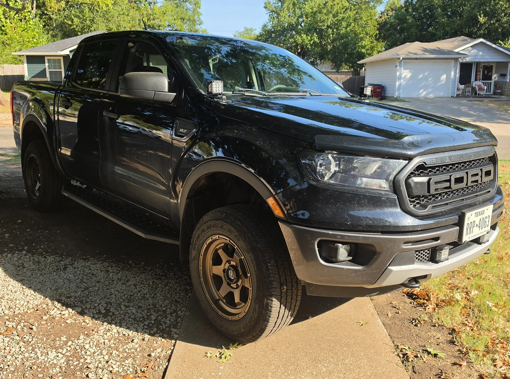

I'm running Fuel Shok wheels with a +20 offset on the stock size tires.
My 2 cents fwiw.

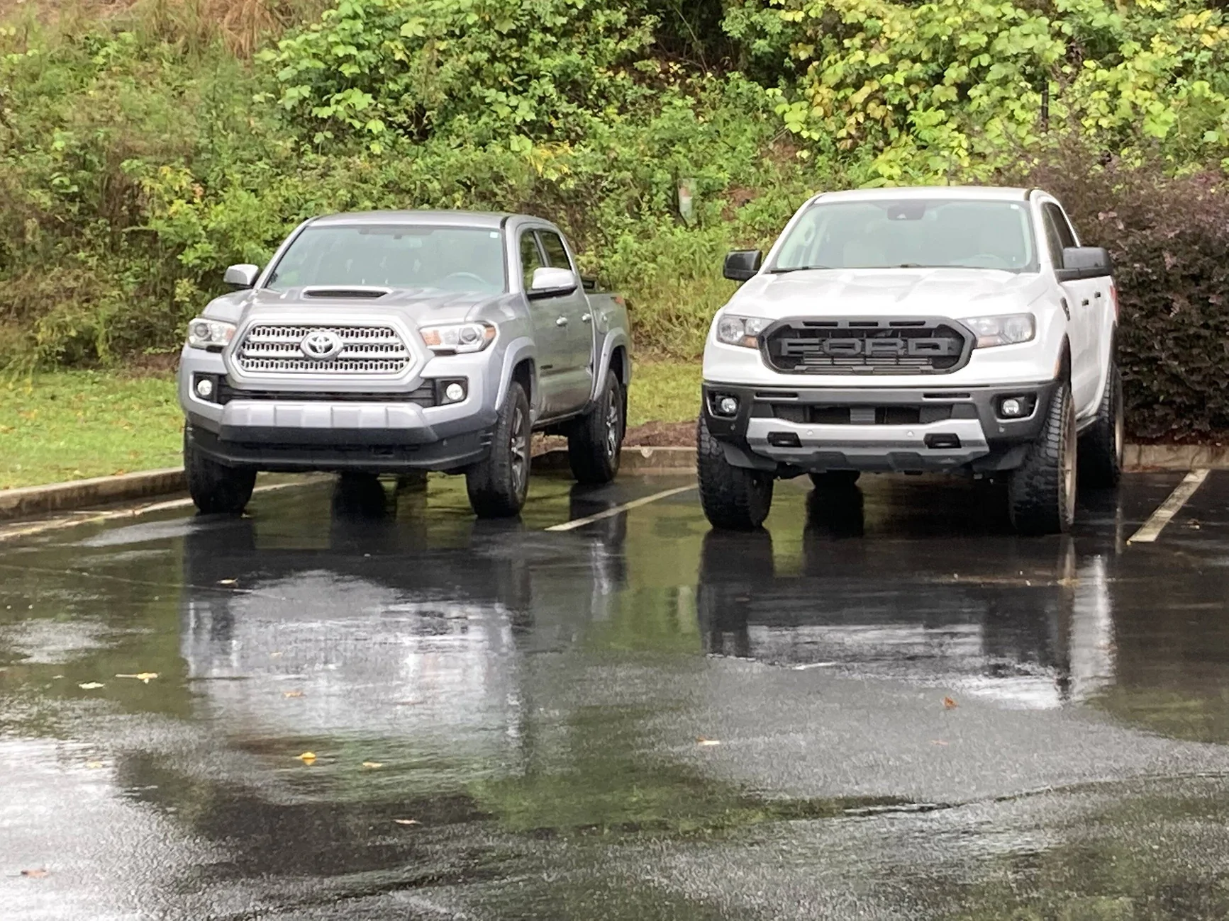

Fuel Shok with +20 offset and 265/70/17 tires for 6 years and 40k miles.
No issues.
This shows the "poke"
