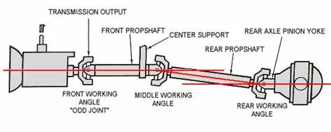

Have you checked the the drive shaft/pinion angle? I'd also wonder about the carrier bearing for the 2 piece drive shaft.
You need to check the working angle of the 2 piece driveline, the working angle should be 1-3 degrees if I remember correctly. Most likely the problem is in the rear drive shaft/Pinion angle esp. if the vehicle is lifted. Correction is done by shimming the center support and or using a tapered shim/s on the rear axle/leaf spring mounting. It's been years since I had to do any measuring of the driveline/diff for vibrations issues as usually they are within specs from the factory.
Thank you! I’m thinking the same thing. I’m either going to lower the front next weekend to the 2.25” setting (I’m 3” right now), which I kinda don’t want to do. Or I was thinking about adding a 1” block to the rear. Do you think this will help?
I did a little experiment in the garage and lifted the rear of the truck from the tow hitch by an itch. Crawled underneath and the driveshaft did seem a lot more straight than it currently sits.

If your rear suspension is at stock height, just figure out the working angles of the driveline, front and back to make sure you are within the 1-3 degrees. If ok leave it alone as your issue could be elsewhere.
I do not know how the Ranger 4wd system works, but if you raised the front end, perhaps the working angle of the front driveline is too great? I'm not even sure if you have a 4wd or if the front driveline isn't in the picture in 2wd.
