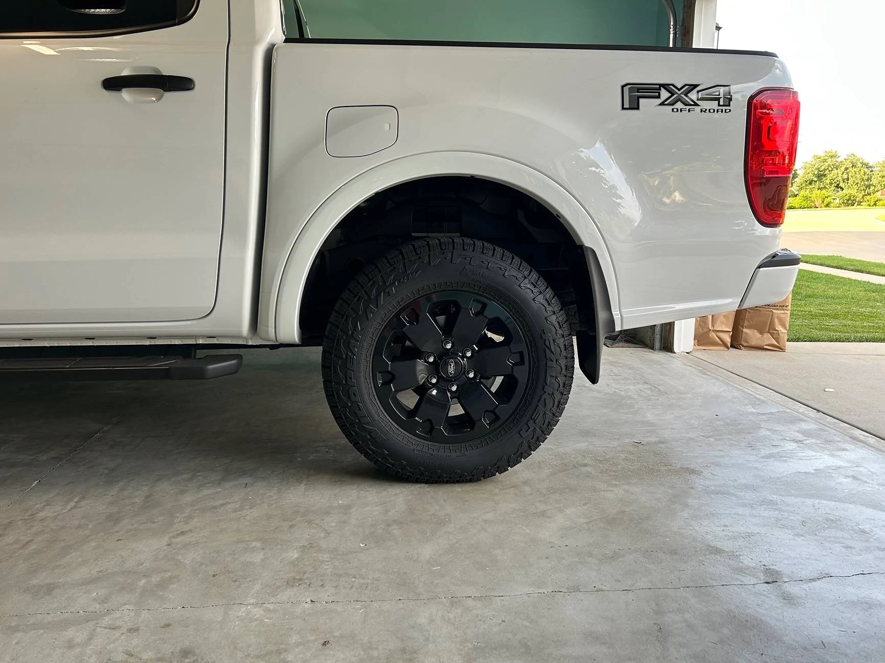

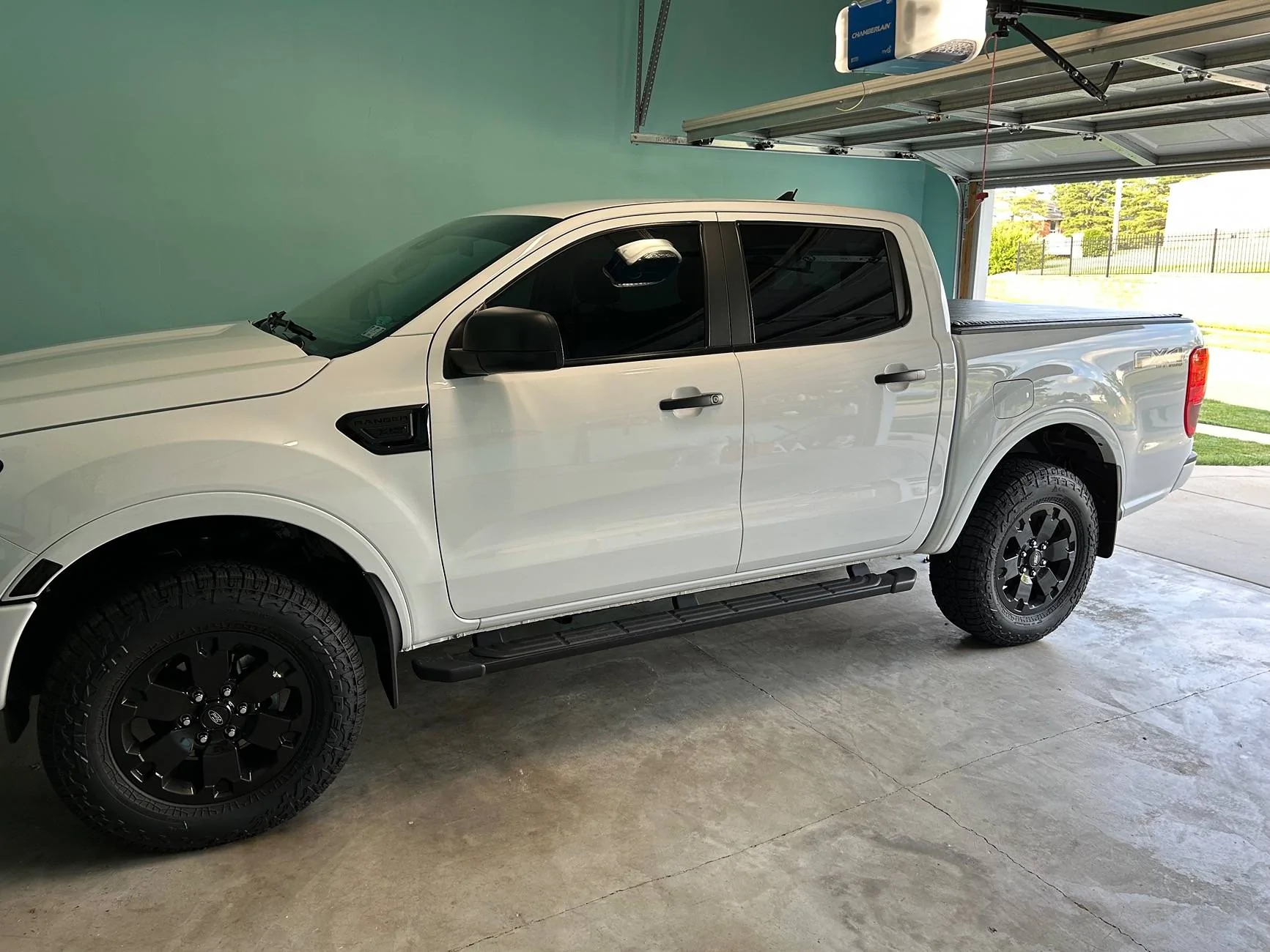

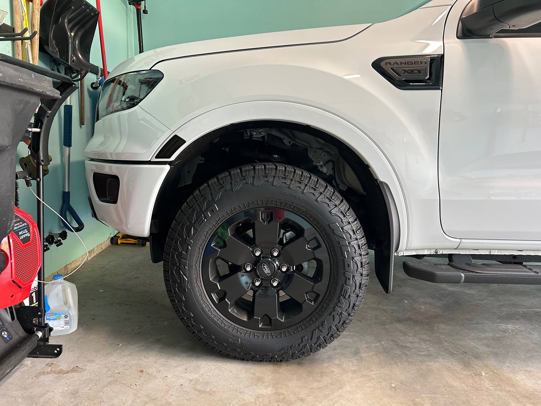

Unrelated to your question, but could you share a pic of your Ranger? I’m considering those same tires and size so I’m curious how they look!
Here is mine. 255/70/18 Wildpeaks with about 1” level in front.
