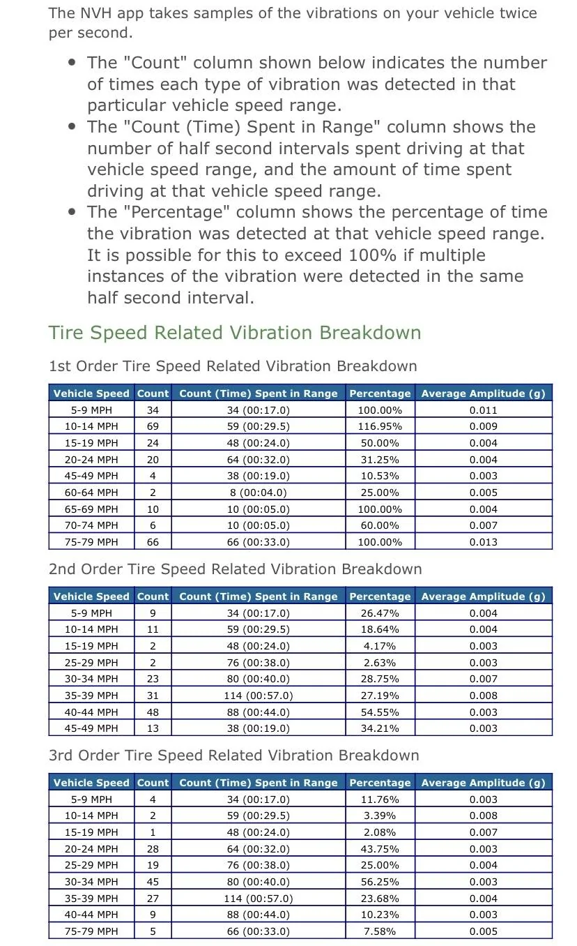

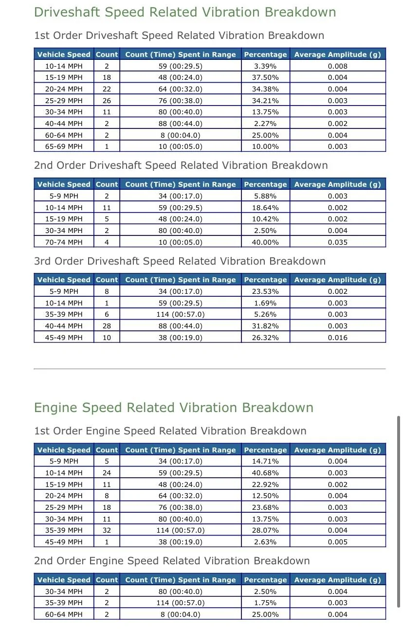

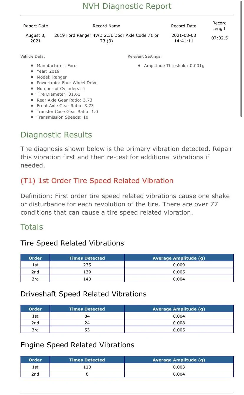

So this weekend I took a 300 trip to my dad’s house and towed a car back for him, a 2007 Corolla using a tow dolly from U-Haul. The truck handled great as far as pulling, even through hill, however the ride was miserable!!! Severe shaking at anything over 65. I get vibration with these tires normally but have been managing, but this was insane. I had aired up to 40 as well.
When I get to my dads town, I had a local shop balance all the tires, they said they were a little off but nothing too bad.
Fast forward to my trip back, on the rougher, not as well kept sections of the highway my ride was miserable again. Anything over 70 and truck would vibrate. Everything in my seats, including rear seats was shaking. No load this time.
I’ve had these tires balanced 3 times now and same issue.
I don’t think it’s the truck and here’s why, when I bought it new, with the stock 18” STX rims and Hankook tires I took it on a 500 trip and the ride was great.
Mods: Aside from these tires: 17” Ford Sport rims, eibach front struts set at 3”.
alignment is perfect and been verified.
My only conclusion is the tires, unless the front lift somehow screwed things up.
