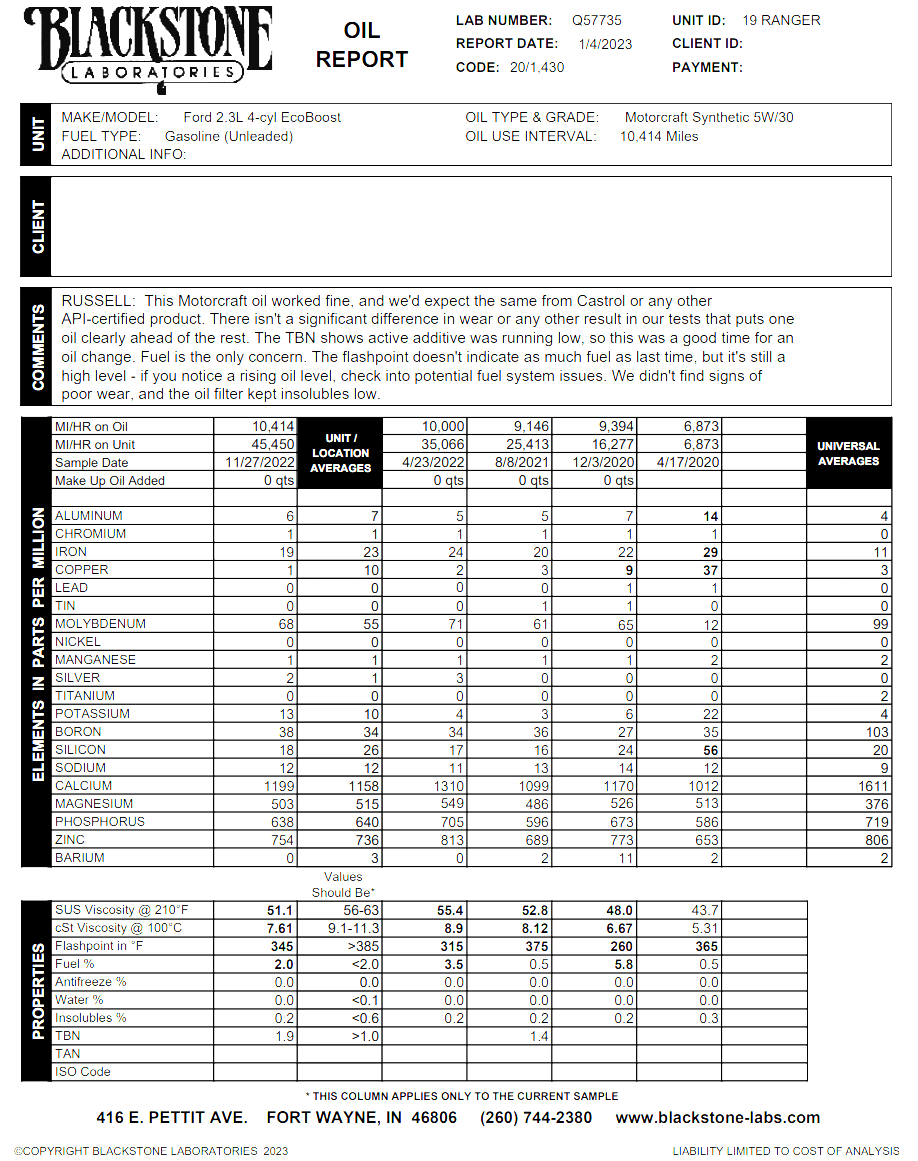

I have gotten a UOA on every oil drain and fill on my Ranger including factory fill. I am sorry to report my findings are that both Motorcraft synth blend and even full synthetic are stretched to their limits with the factory 10k mile OCI. TBN is worn away to the 1.0 level and they sheared well below grade. The last two in a row in the UOA below were the full synthetic. I got a lot of flack at BITOG for those UOAs by the way. I personally think it's fine as Ford intended; end of OCI and oil is worn out ready to be changed. I would like more margin than that going forward, and there is very very little margin for those that might let the change oil warning persist for a month or two beyond 10k.
I recommend using a stouter oil in the Ranger GTDI if you plan on doing the 10k OCI. This last fill I switched to Castrol Edge 5w30 that says 10k OCI on the bottle.

No because I'm a hobbyist and I like to practice science rather than engage in internet myths. Plus you have to admit changing your oil twice as often or three times as often as the data demonstrates no additional wear, and factory recommends, is.... stupid.
