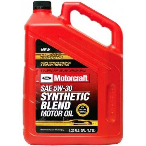

Motorcraft 5W30 ...
This is what I use as well. Be sure it has the newest SN Plus rating. Last time I bought at my local NAPA they had about 50/50 stock. It’s still working its way through the system.
