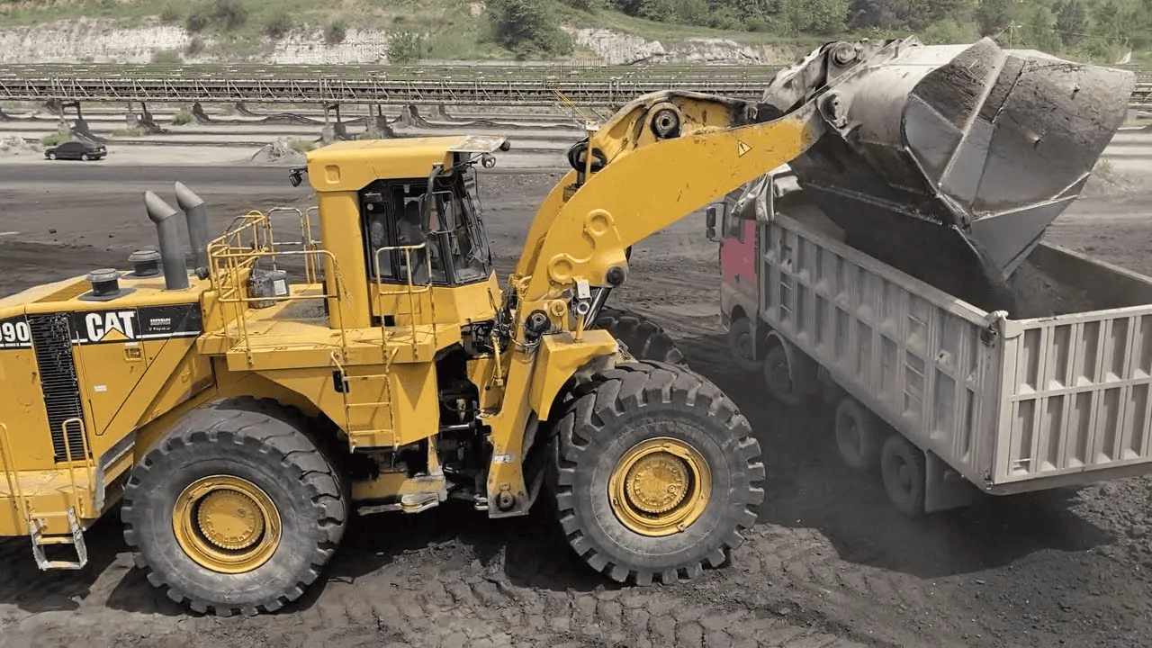

We had a Cat 990 payloader which was used to load petroleum Coke (filthy service)
It took (if I recall) about 25 gallons of engine oil plus filters.
It cost (15 years ago) about $250,000 for an overhaul on a recommended 11,000 hour schedule.
UOA was used to monitor engine wear and samples were taken while in service, to determine whether to extend or reduce turnaround times in order to save major components.
Down time for service was very costly as it loaded 7000 tons of Coke per day.
The $35 was considered worth it for this application, but we would have been laughed out of the shop if we submitted a UOA for the field service truck.
