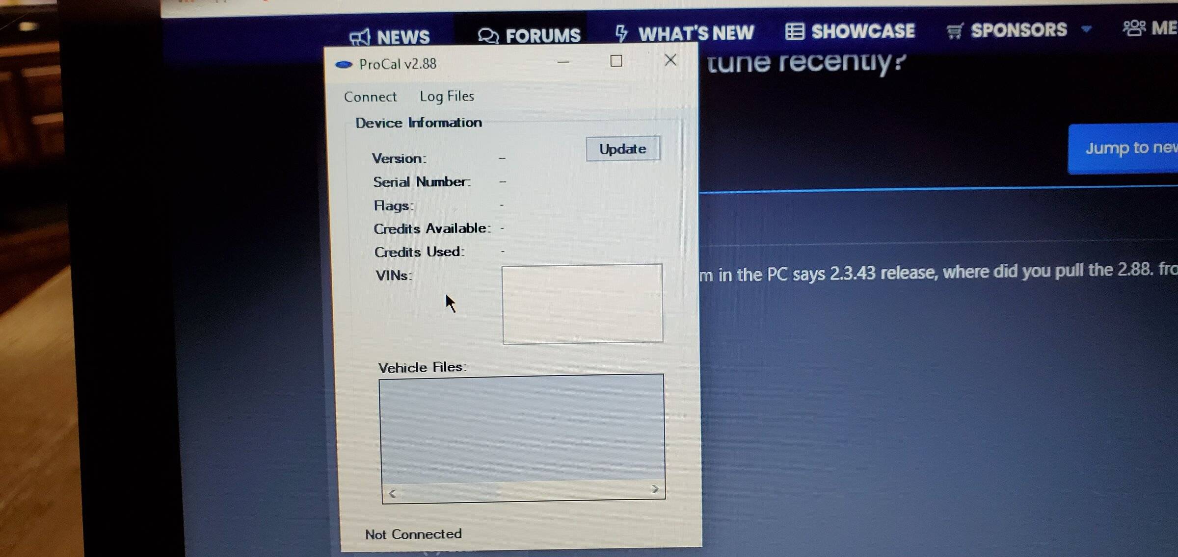

The Forscan program in the PC says 2.3.43 release, where did you pull the 2.88. from?

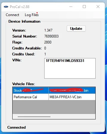

Forscan has nothing to do with the tune. The Procal Updater Software is version 2.88 and it appears in the header of the window. When I first downloaded the software I want to say it was version 2.83. I plug in the device a few weeks ago and got a dialogue saying there was an update and it then updated the software to v2.88.
The 1.347 is the version of the firmware that resides on the ProCal4 device. When I first purchased the tune step one was to see if there was an update for the device. There was but I don't recall what it was but it was updated to 1.347.
The tune file on my 2021 Ranger is MB3A-FPREA1-VC.bin, not sure if this is different per year of truck or not. With the Mustang I had there was an update that came out and the last characters in the file name changed. I tuned my truck in early September and that file name has not changed any time I have checked for updates making me think that there has not been any revisions since early September.

Oops, I'm a dummy, I have both icons next to each other on the desk top, yes mine is also 2.88

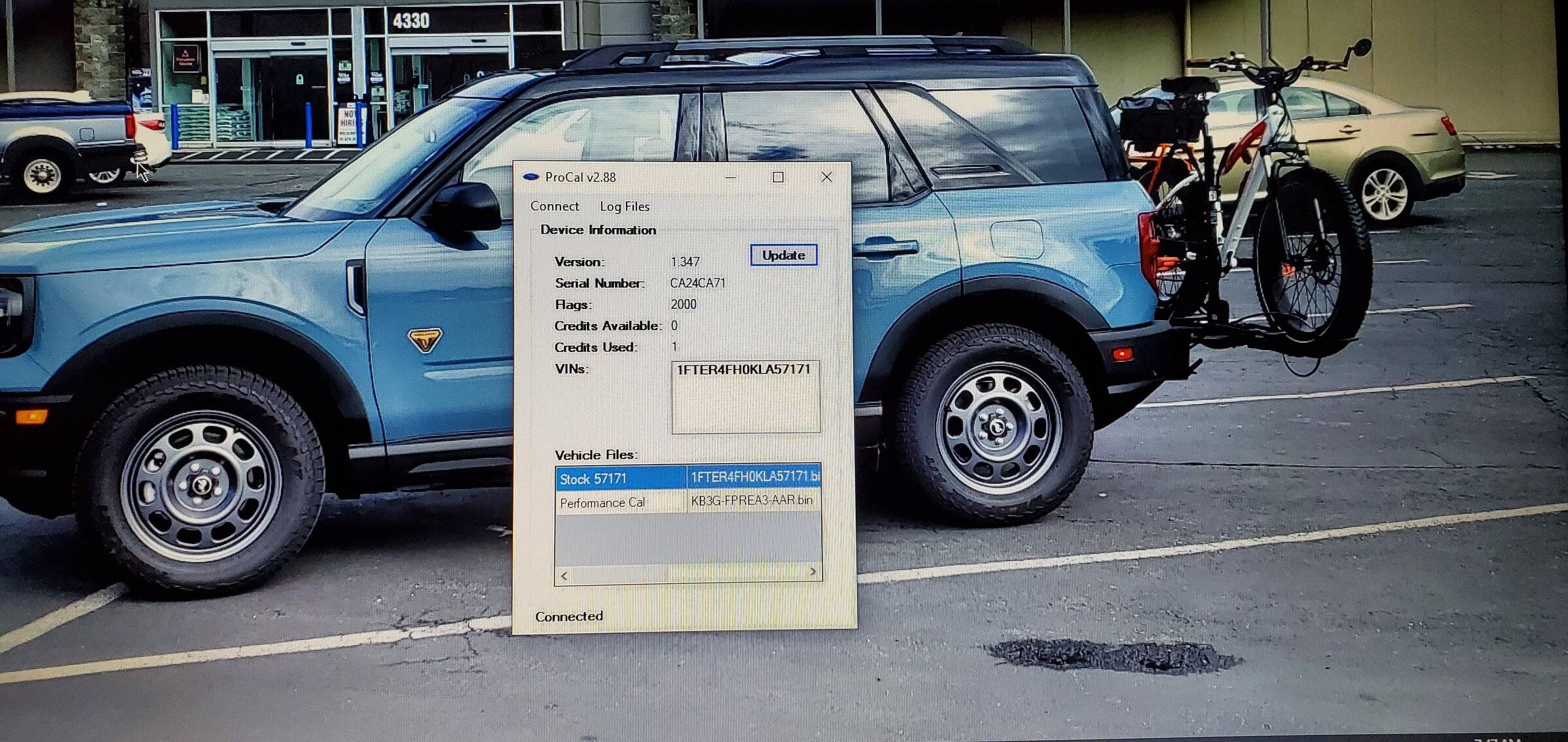

I also have the same version 1.347
It must have reset the trans when I went in, so the relearn process is what must be going on, it's likely I never got into that high speed downshift the first time I loaded it in.
So it turns out to be a big fat nevermind, I'm just a dummy, well at least it's not the first time, I'm used to it, I'll write it off to being old.
