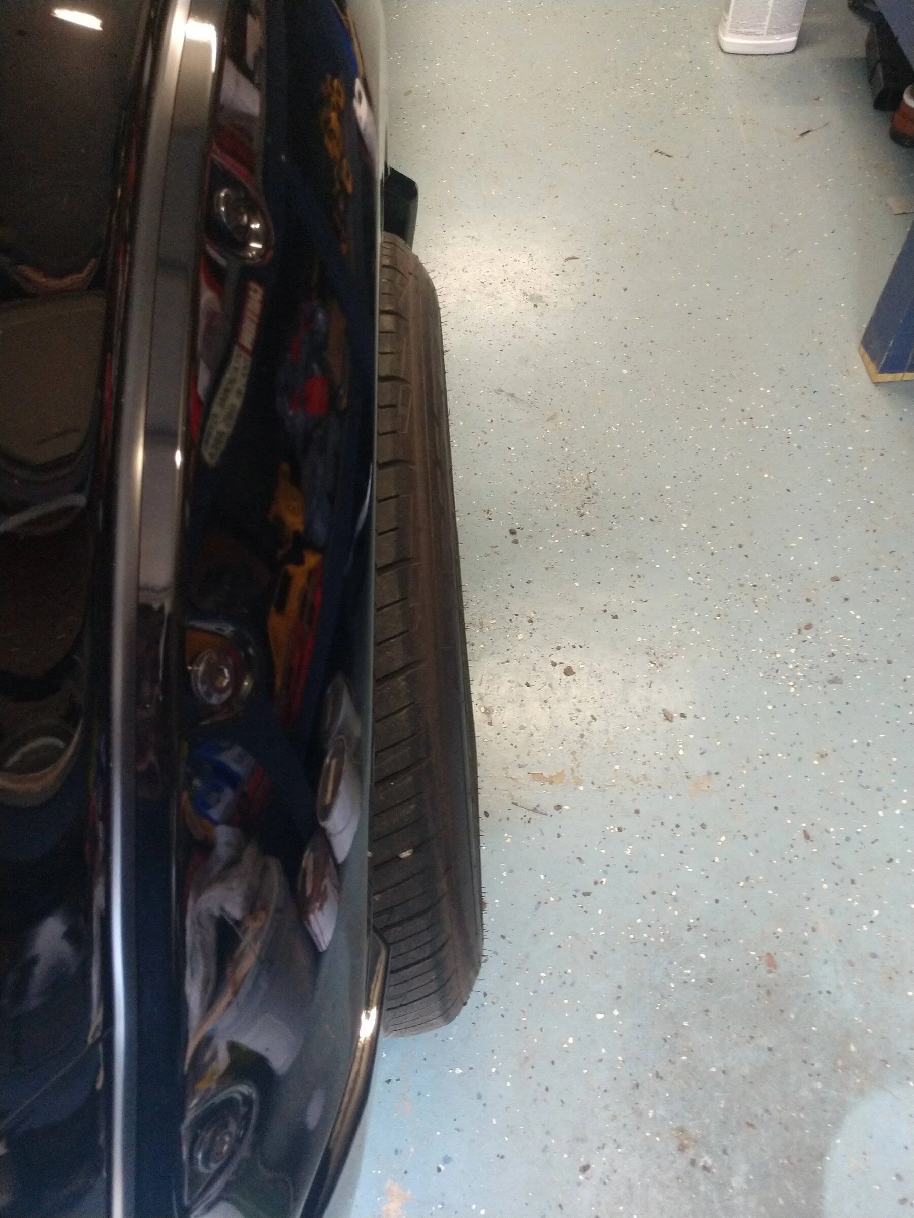

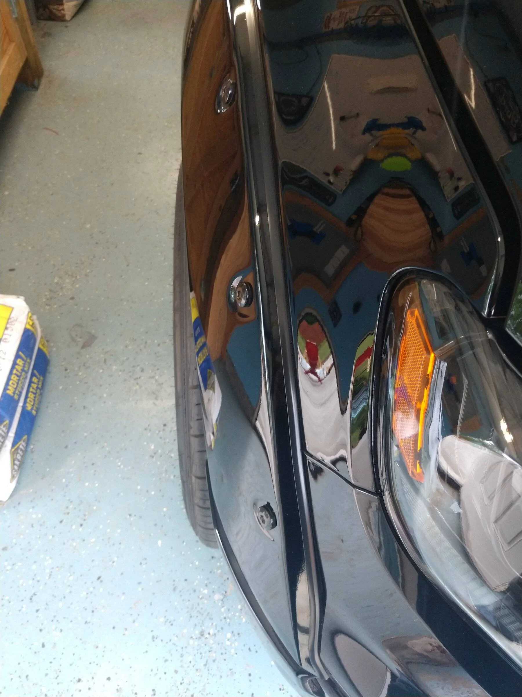

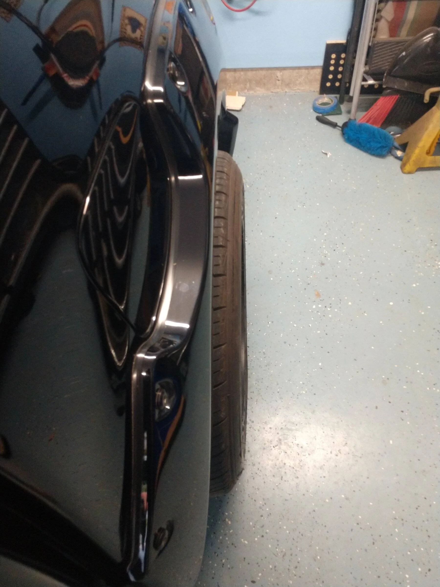

Jared,
I took a couple of pics of my flares/tires this afternoon. My wheels are turned slightly to the left, but maybe you can tell from the rear pic or the full angle pic?

Jason,
Thanks so much for these pictures.
Man looking at your truck is such and inspiration to my build, i ordered the belltech 3/6 kit today (no idea when ill get it) and will be picking up some 605s friday (found a good deal) just need to decide bronze or black. I have a magnetic gray truck, additionally need to order the fender flares to send them off to paint to get them matched. It wont be black like yours but I’m excited to share once I can finally start. I’ve been dreaming about doing this build since I bought my truck in 2019. Any advice on any steps that I will be taking will be much appreciated.

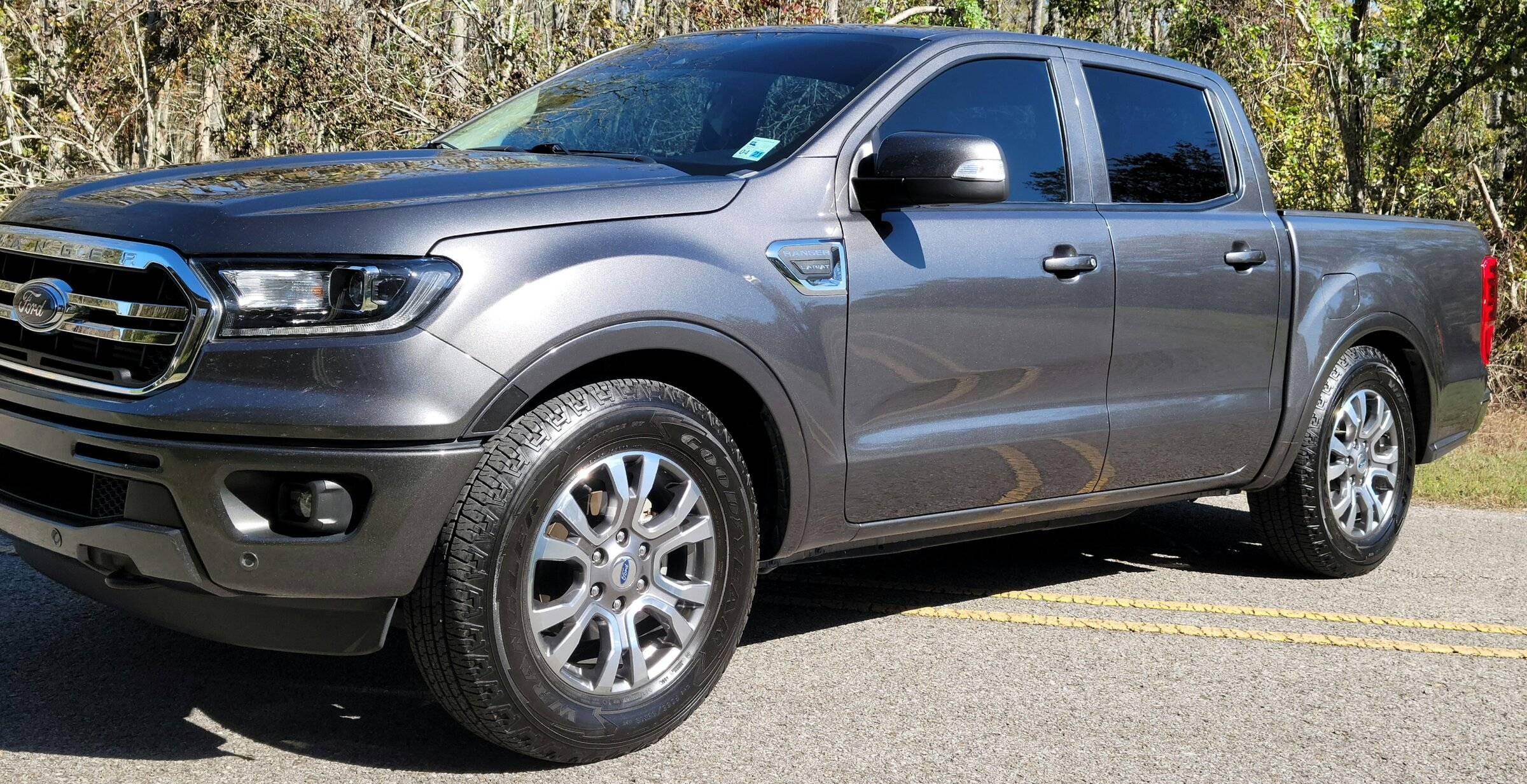

I lowered my 2019 Lariat roughly 6 months ago using the Belltech kit 2/5. Can't complain, definitely improved the handling in corners, and has a smoother ride, it does bottom out from time to time but Louisiana has the worst roads, now on to searching for some wheels. I ended up buying the smoked led turn signals for the mirrors, and had the taillights and third brake light tinted. Don't have any updated pictures, but will post once i get it cleaned back up.
Bought the same kit, have you seen Mirage776’s build, how do you feel the tire and fender Flares would work with this kit, I have an xlt with the same wheels as you buy rocking 285/60/18s currently. I dont think they would fit without modification after dropping so I was planning on doing a wheel and tire set up like Mirage776 with the fender flares.
any input you have would be appreciated.

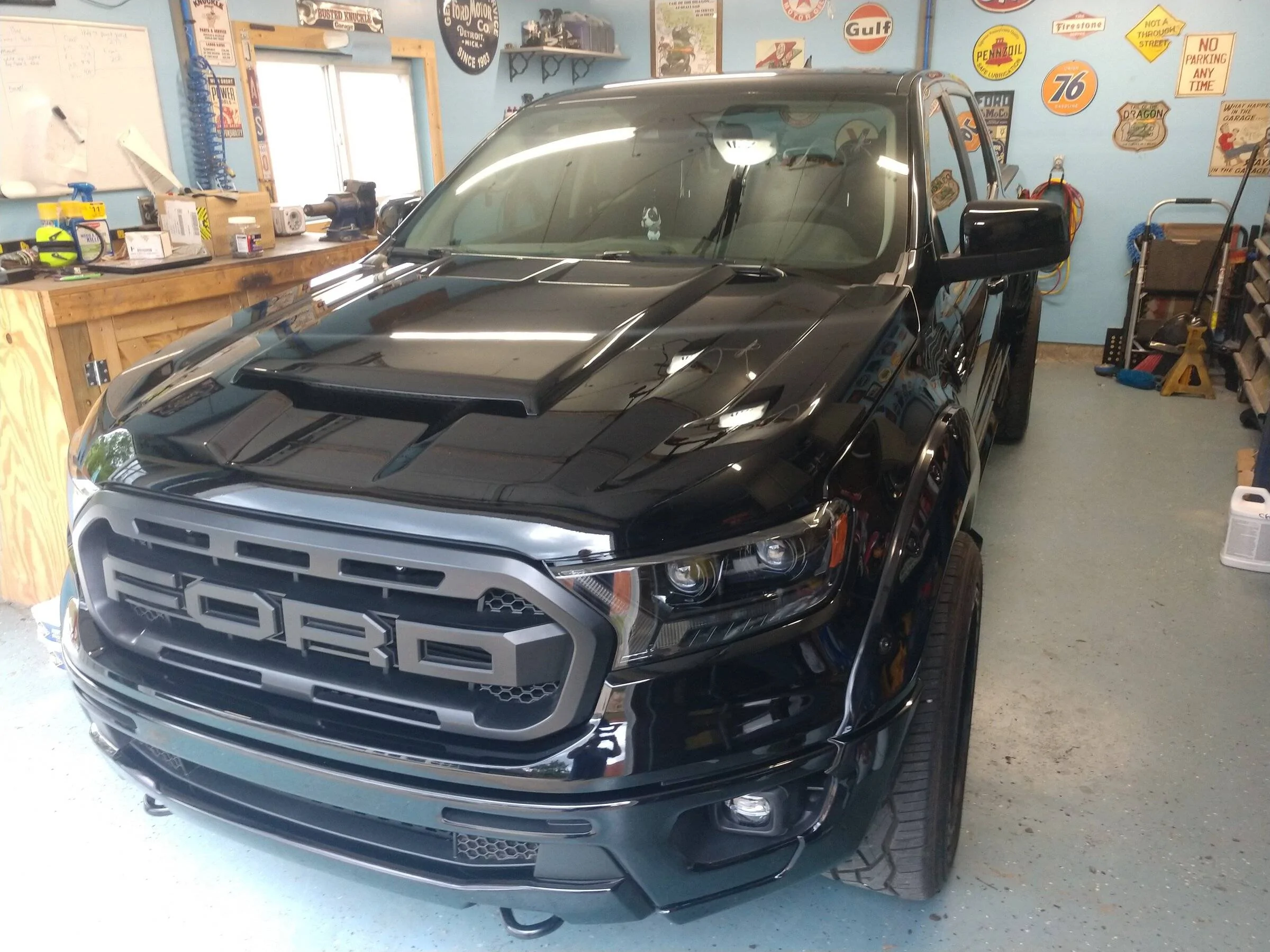

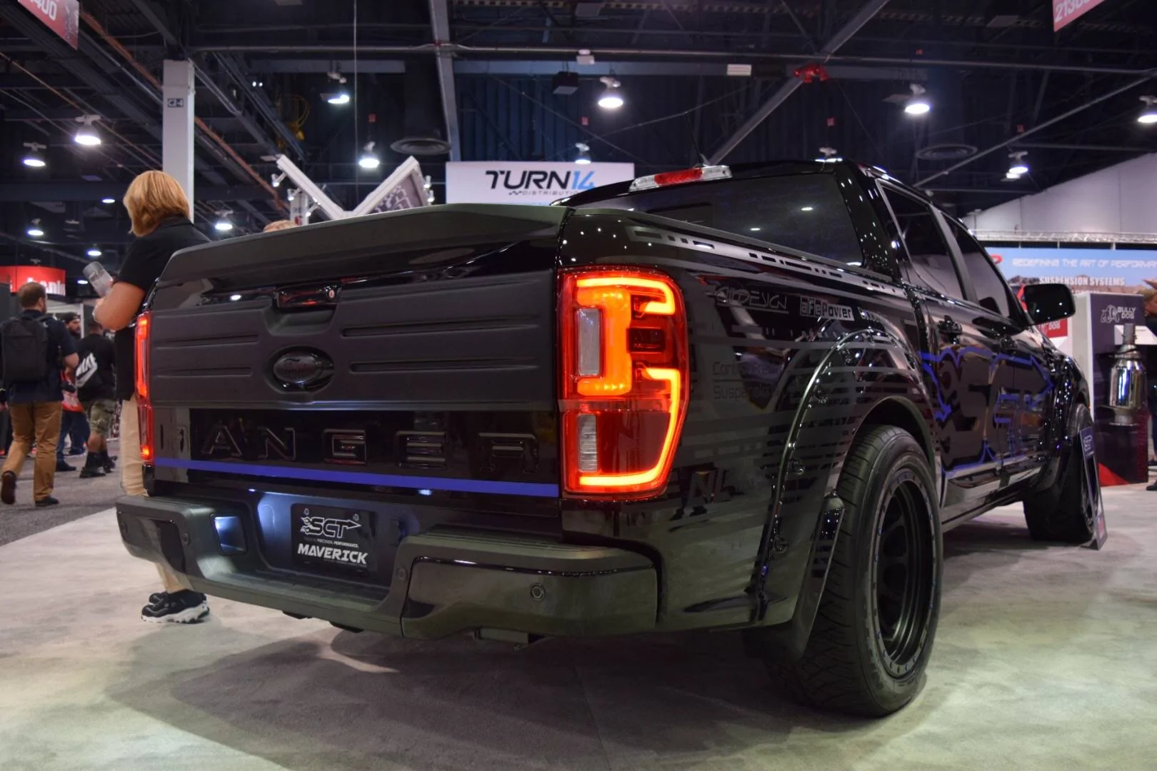

No problem. When I spoke to Belltech a few months ago, they actually said their front drop kit would only allow it to drop 2.75"
With the expensive front drop I have, you can actually drop it down 5+", but that's only for show, it will not be drive-able at that height... I don't have the awesome rear coilover drop from Control Freaks, but it'll drop the rear 6+"
Wheel size and offset as well as tire size are going to be what makes the difference in getting it that low. I don't think the rear is an issue, but since the front wheels have to turn and all, wheel/tire choice will play a huge factor here! I was cloning the SEMA truck, so I did months of research and planning to find as much as possible on what they used!
You don't want too much "sidewall", on your wheels, when you drop it. I would look at something taller than an 18" wheel. You could do a 22" wheel and have a little more sidewall than normal, that would also fill in the fender gaps.
He's a pic of the SCT truck sitting 5.50" front and 6"+ rear, but they did inform me, that this was for the "cool factor" only.... :(
