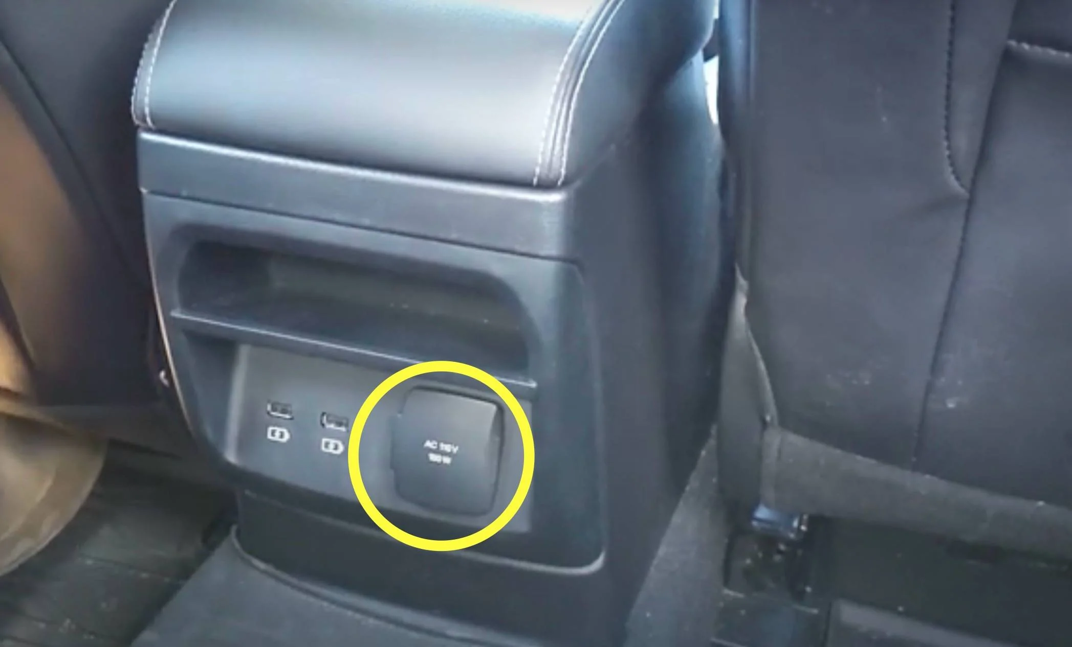

It is limited to charging or powering small devices so you’re not missing much but when it’s in use, the Auto Stop/Start is deactivated to save the battery. Hence, the nightlight hack.

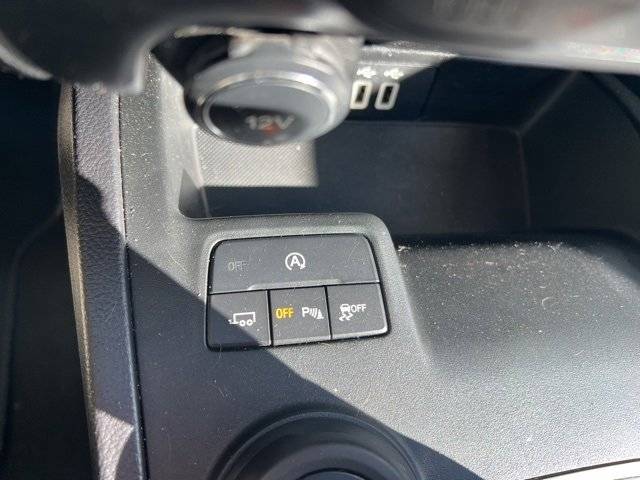

As an example, from Auto Trader here is a Pic of the Console Switch Pack.
I have noted various layouts of the switches for the trims, but each row of switches has one connector to feed all the switches in the row.
Your switch layout and number will depend on the options the truck has.
Such as E-Locker and Trail Control
Mine only has the (Bottom Row) of switches and the Upper Row is just a Blank Plate.
When I did my TM Switch (Add/Mod) I had this panel apart, I do not remember if I had any extra connectors tied off under the panel (going nowhere)
I am quite sure the wiring is there for the ASS Switch, will look if I ever have a need to pull that apart again.
This is only if the Hex-Line changes triggers faults with the ASS Switch installed.
Options for a work around.
Note: If you have a switch layout like the one below, then if the switch being installed gives you faults after changing the Hex Code Lines, then simply disconnect the single connector going to the ASS Switch on the Upper Row.
If the ASS switch is embedded with other switches on the row, then try to locate a switch row that has (ONLY) the switches you need on that row without the ASS switch embedded.
As my online research shows various options, you may find the one you need.
