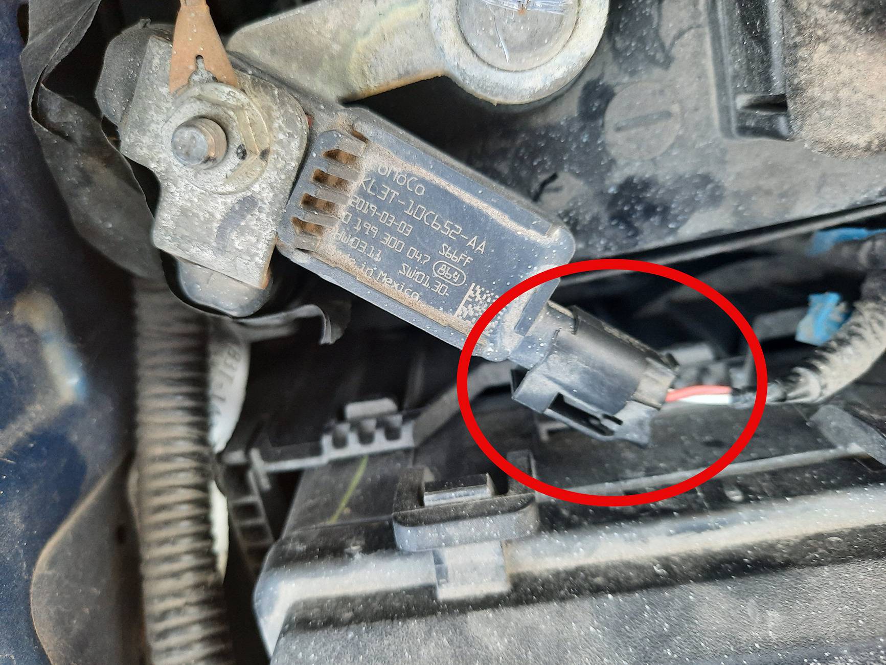

I just unplug this part that comes from my NEG battery and the auto start/stop never engages.
had it like this since 2020 and never a problem.

disconnect the small plug from the battery. put tape over it for corrosion. the small connector is the start/stop. just unplug it. no more start stop. just dash indicator but inop.
That works, but it also completely turns off the BMS, Battery Management System. Which many people are fine with.
