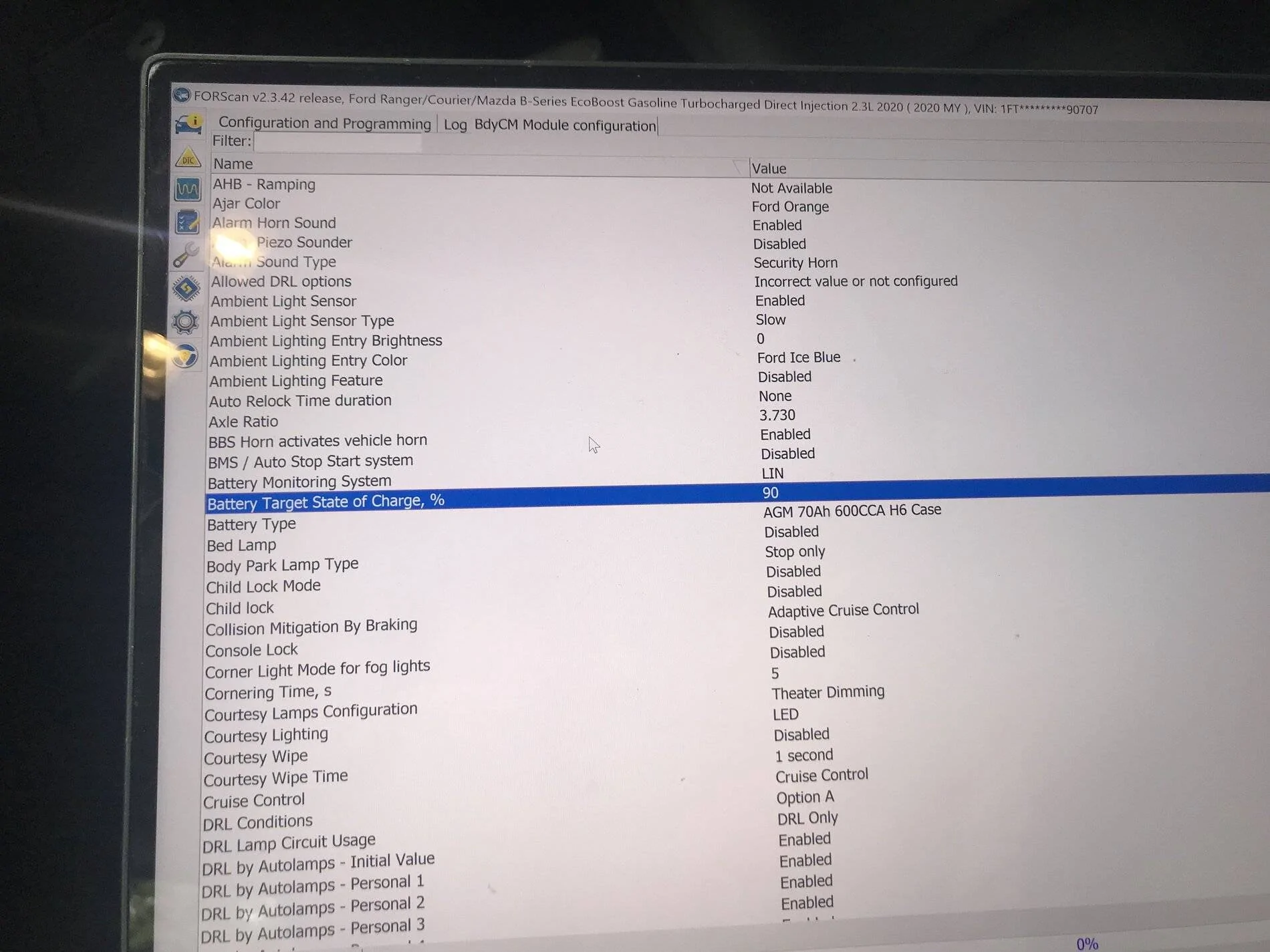

The factory default for ASM battery charging is 75% of capacity. Many are not aware of that.
Where is this information coming from?.
For me, this doesn't make any sense. The worse thing for any batter is over discharge as well as heat. Everything I read about AGM batteries is that they should be fully charged and not over discharged.
Not sure where it "came from."
But a little digging in ForScan showed mine factory set at 75%. It is now set to 95%
thanks for that information. Just doesn't seem to make any sense to charge battery to 75%. I can understand 90-95% so heat doesn't affect the longevity, but 75%?
This is a Forscan photo. I changed it from the factory default of 75%. If you have Forscan go see for yourself
I'm just a milkman, but my thought is this.
ASS is tied into the BMS as we know. If the system requires charging, I assume <75%, it will not allow ASS to engage. By setting a lower threshold ASS operates more frequently, increasing economy. In this case I feel they are viewing the battery to be sacrificial to economy.
