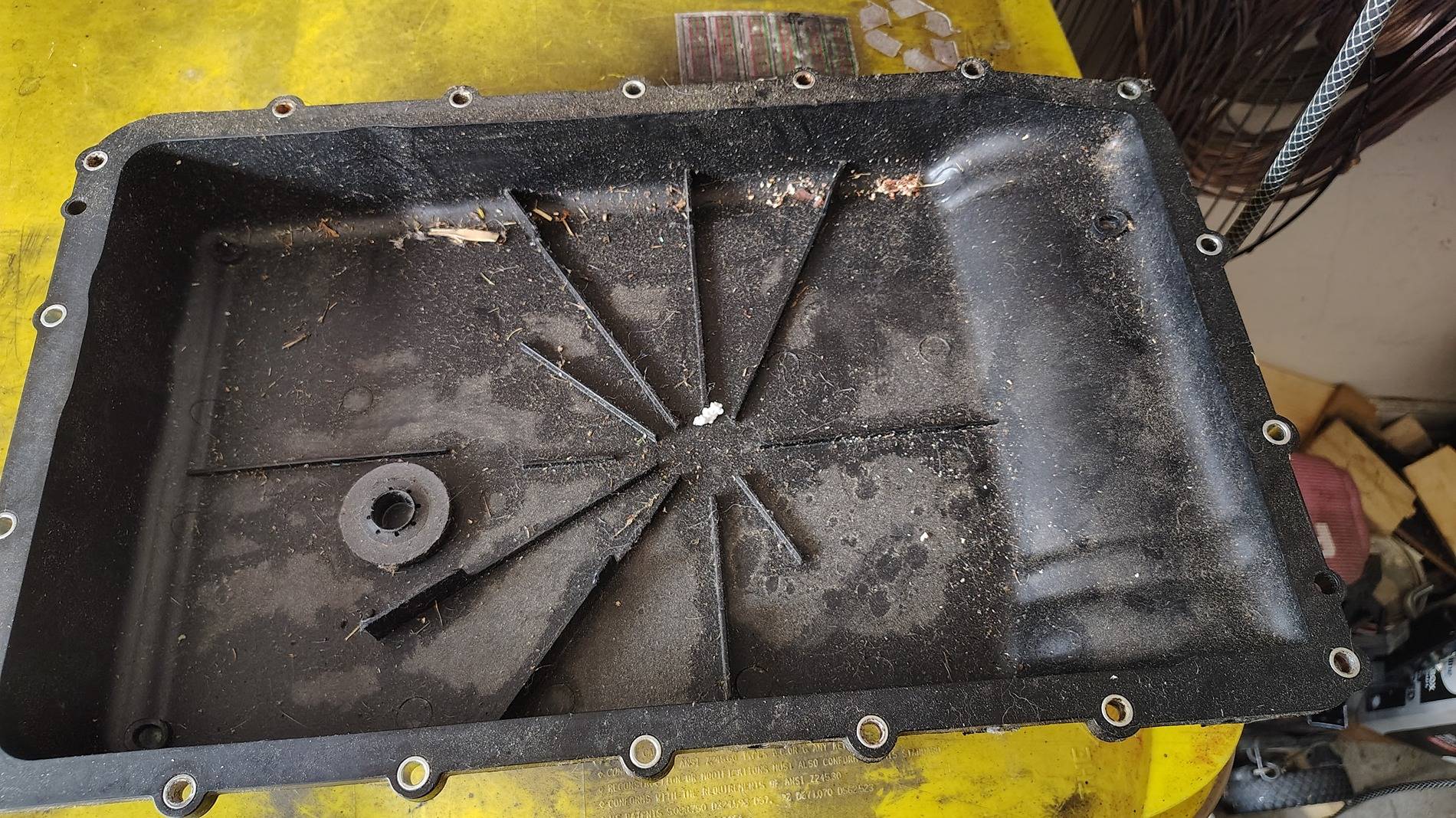

Anybody have a pic of the Ford OEM pan? To compare baffling.
Here ya go. It's been sitting out in the garage (literally) collecting (A LOT) of dust.
