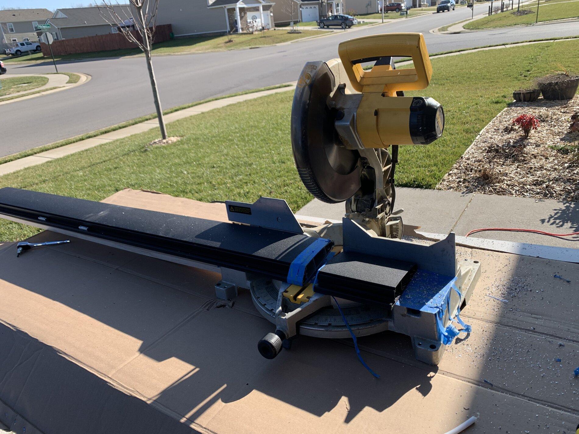

If they’re made out of aluminum a new carbide circular saw blade on a chop saw will give you nice clean square cuts. Just let the blade cut with minimal pressure. Clamp if you can. If steel different approach entirely
was kind of thinking about that too
With way, need to get a new blade for the chop saw

Chop saw
Carbide blade and a little blade wax
done cutting With the chop saw before I could have ever started with the hack saw.

I’m so glad you went that route - I use my DeWALT mitre saw on aluminum deck railings, etc. with a blade designed for fine finishing work - 96 teeth, I think. I was about to suggest you use this method and then I saw this photo - nice!
It was like cutting through butter.
