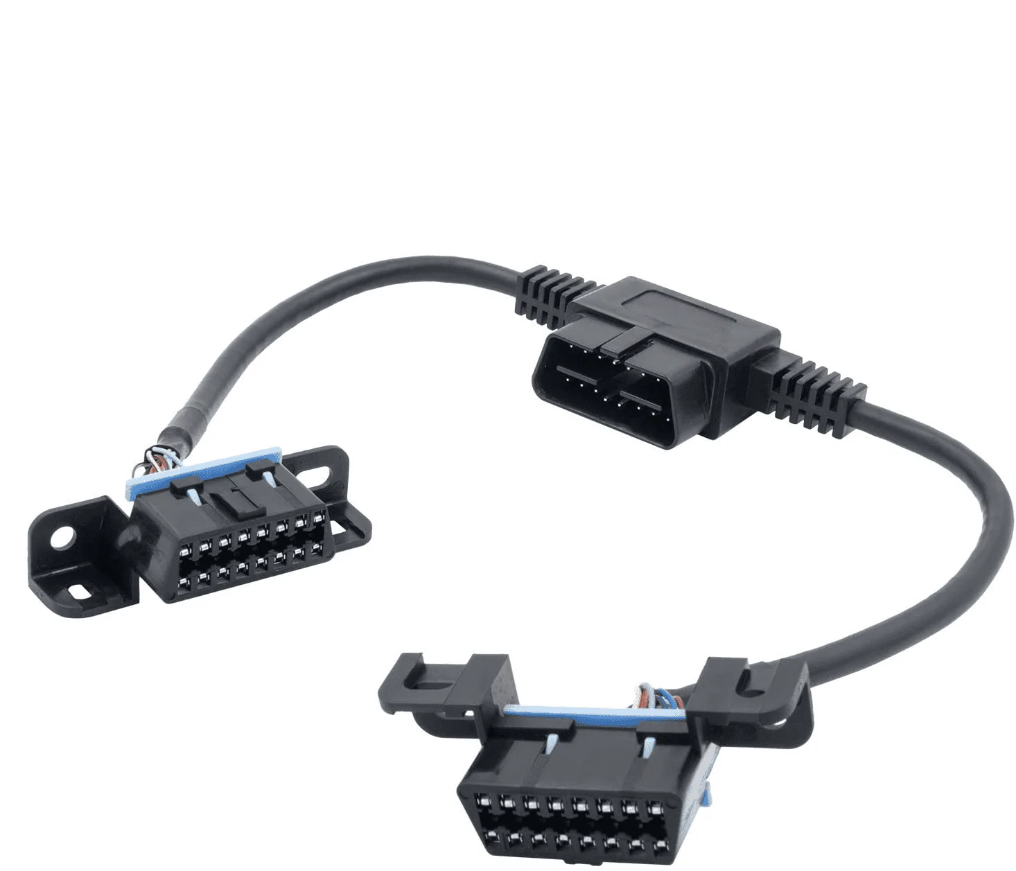

  • I bought an OBD-II splitter on Amazon,
    appears to be same as what AMP sells but cheaper, $35! Worked just fine. I have my OBDII Bluetooth installed and working with OBIIAA. Cant wait for my next inspection to see the shop freak out.

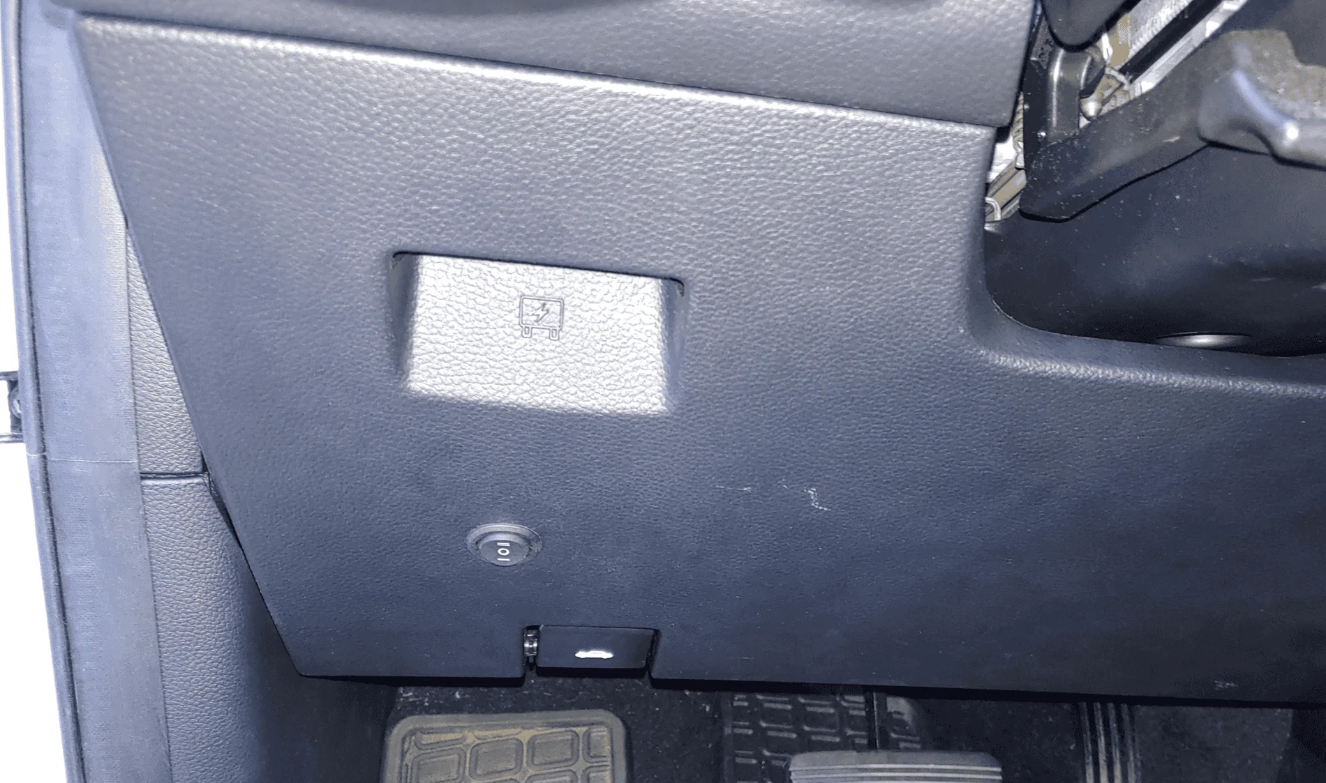

Hey where did you guys with the override switch put it? For a switch that wont get used very often I dont really want to make a hole in my dash. I may put it on the kick panel.

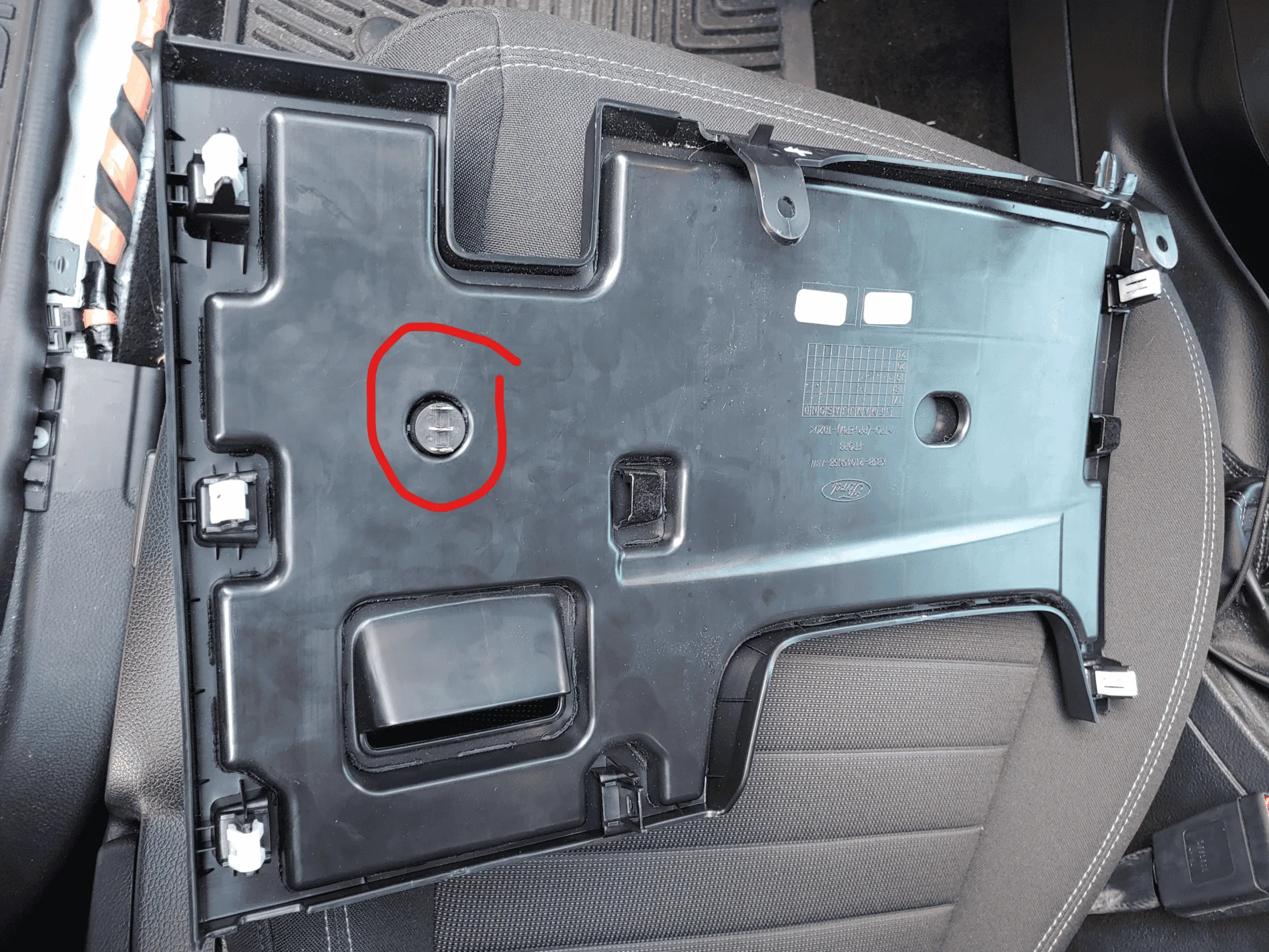

Finished the override sw install. Used the AMP install as guide, got a 3 way rocker off Amazon and Done! I will probably use this a lot as I have discovered that I don't need the step to get in our out.
As to the switch location - I put in on the "fuse" panel. Location decided for my by the round opening in the back here.

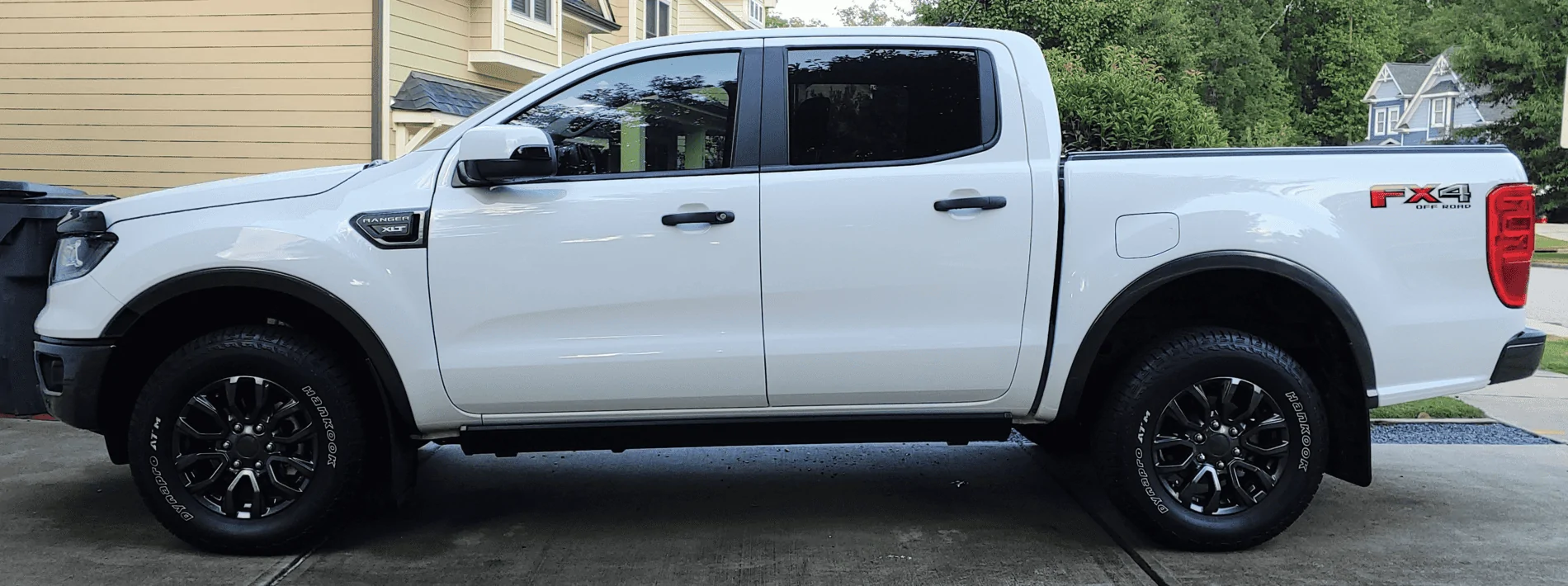

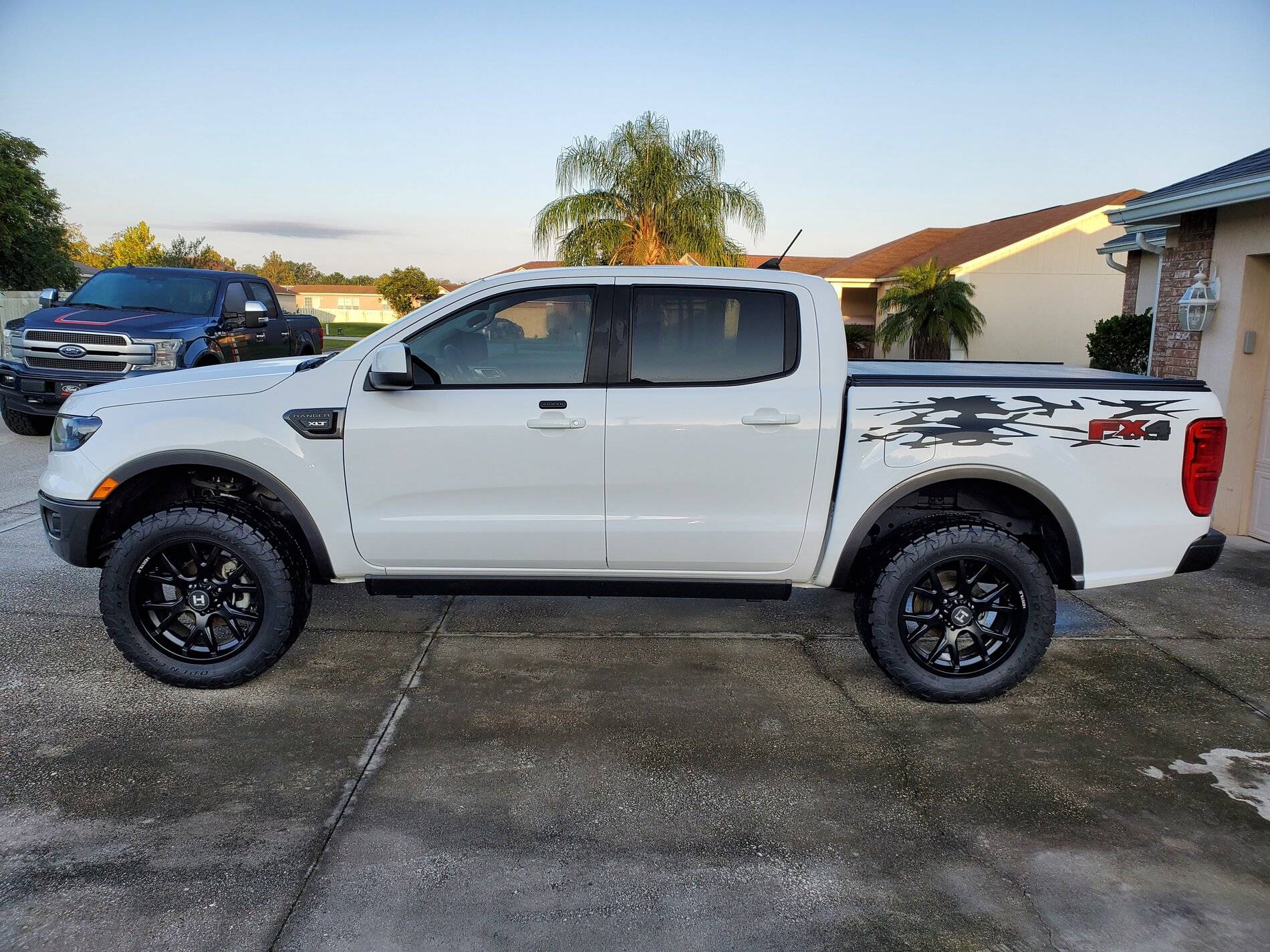

Installation complete
Looks good! I am loving mine. Truck looks so much cleaner than the factory steps.
And look great on a white truck!

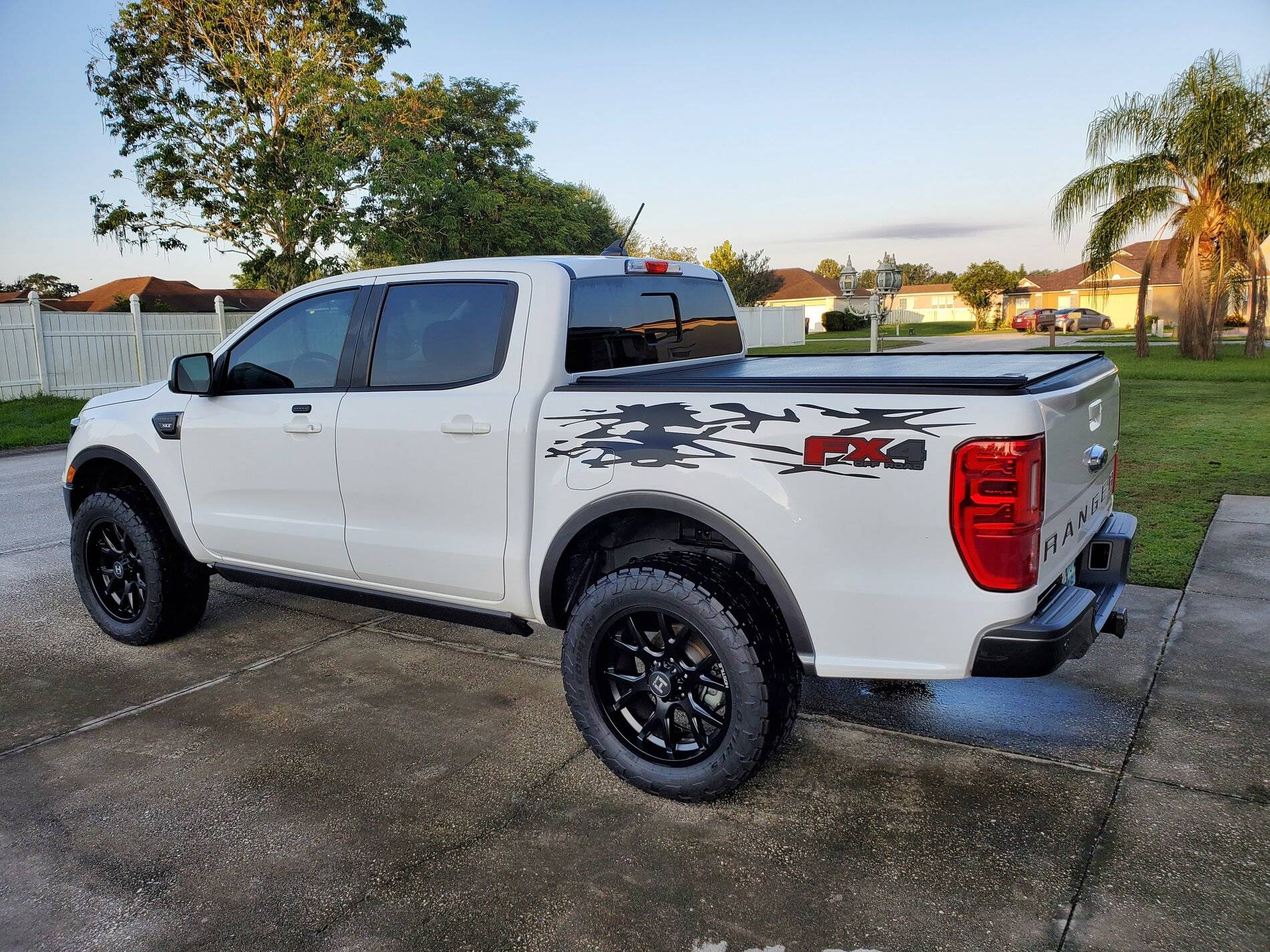

Hey I didnt think XLTs came with painted door handles!?
Found your post on this - Nice touch!

Very observant and you are correct !!
I replaced the mirror covers, door handles as well as the tailgate handle w/PTM replacements from a Lariat that match the body color

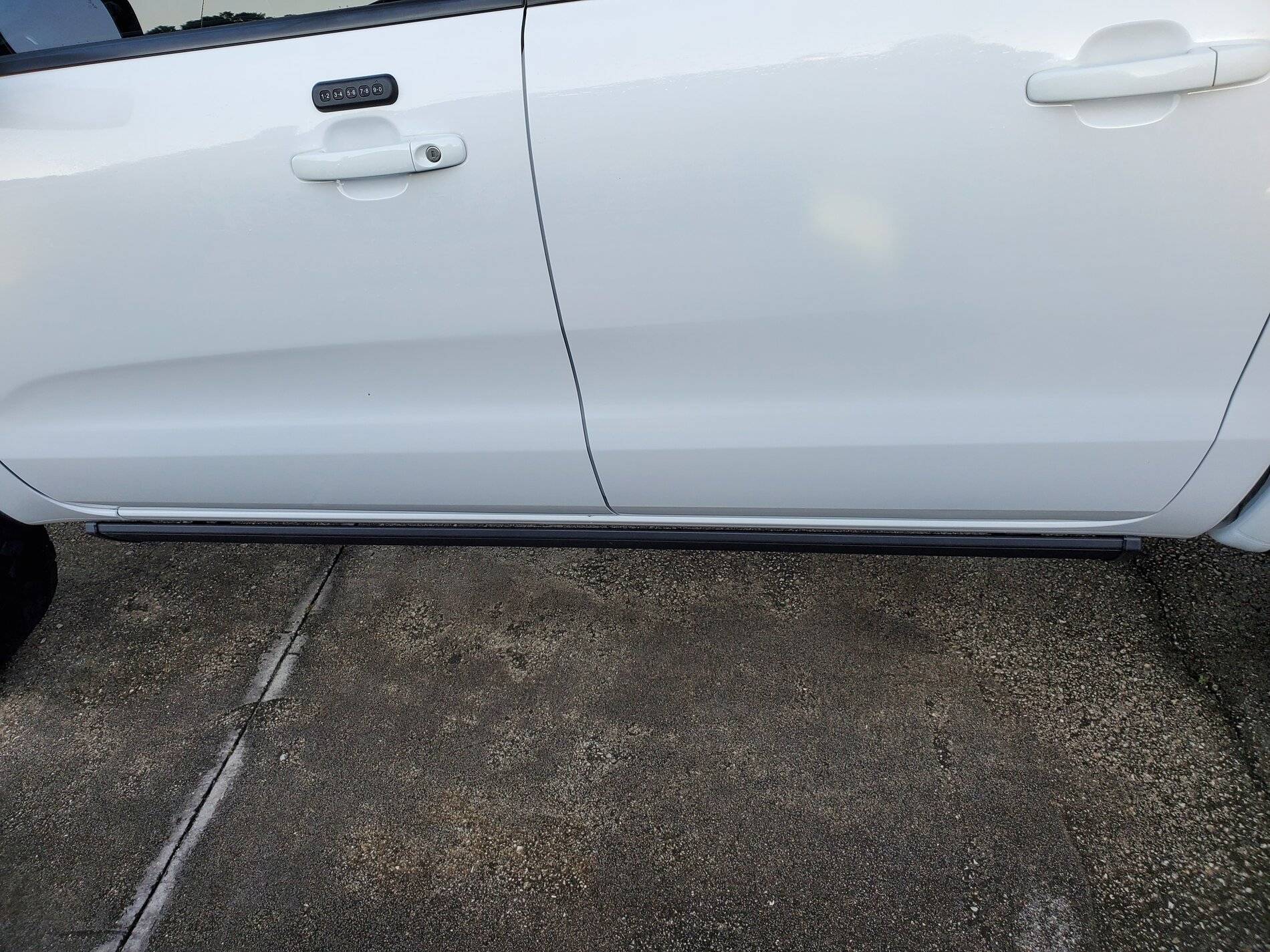

FINALLY
I have both sides working smoothly and snugging up front and rear. Had to use an ultra sonic cleaner to free up the linkages and lots of silicon spray. Also discovered you can remove the big shaft/drive shaft and get all the grit out!
I think this has now become my favorite mod, would I spend $1700 with what I know now? Not sure, but a lot more likely now.
These things ROCK, if you can afford them - GET THEM!
