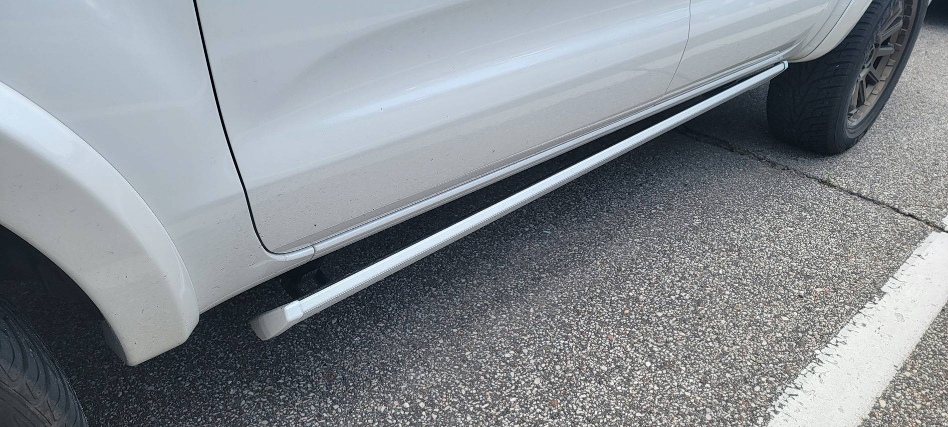

Just an update. I got my Ranger back from the dealer after the windshield adhesive replacement recall and AMP Powerstep debug. The tech determined the front idler operators are warped and has contacted Amp for a replacement under warranty. The dealer said the steps come with a 5 year warranty, so they expected to get replacements shipped to them at no cost. When the parts come in, they will call me to bring it back for the update. Here is hoping.
deleriumtremor
Bill
Apr 19, 2022
1,200
3,810
Boise ID
2022 Ford Ranger XLT FX4
Just a final update. It looks like AMP isn't going to replace the idler units (the forward operators). The good news is I got both sides to open and close completely and it appears as long as I can keep them lubed, they seem to be working (thanks to tgRanger for the tip on the WD40 silicon spray, very easy to apply). If they quit closing completely down the road, I will deinstall them and live without.
I have concluded that this particular application for the AMP Powerstep design is suboptimal. I suspect it is a tolerance thing with where the mounting holes line up and probably is a truck to truck thing. That is, some trucks the holes are aligned close enough for the steps to operate without binding, others, less so.
If I was talking to a friend who had a 5G Ranger that wanted retractable steps, I would recommend they focus on a design that has a motor on each corner, versus the AMP design with the motor on just one end.

Frankly, at this point I am suspecting the "warped idler linkage" story by the dealer was just that, a story. I suspect he couldn't get them aligned and just picked something to single out as a cause and AMP figured that out as well.
I have been under there quite a bit (shimming, changing tightening sequences, going back and forth front to back as I tightened, etc.) and can't see anything that would indicate the idler linkages were warped (at least nothing that is obvious to the naked eye). It would take some kind of measuring fixture to determine if they were not square, which I obviously don't have.
There has been a change on how they operate than when I first installed them and they worked for a short time. During that period, they made a REALLY loud noise on the final closure (a pretty big BANG). Looking back on it, it should have been a sign they were not aligned properly and not happy. When they first quit closing fully, I passed it off as mud and grime collecting in the linkage (we are off road almost every day and when it is muddy, it really cakes the mud up along the rocker panels and the steps and linkages). After finally cleaning and lubing thoroughly they still didn't close all the way, which told me for certain they were not aligned.
Since I finally got them working, the closure sounds are much more like other truck brands I have had these steps on (when they worked flawlessly). I am hoping I finally landed on the right alignment and they will continue to work. I am also going to pressure wash things regularly and hit all four corners with the WD40 spray lube. If that keeps them working, then I will stick with them. If they quit closing all the way one more time, they are toast. ;)

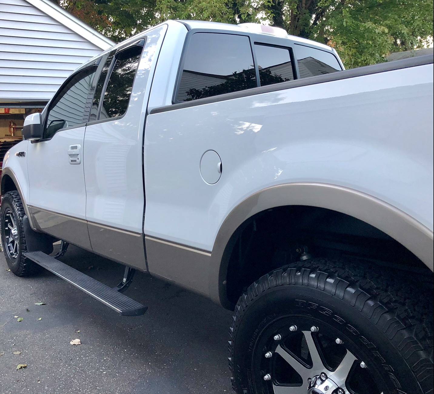

Their Great steps! I installed them on my 04’ F150 Lariat over 15 years ago and they still work flawlessly..

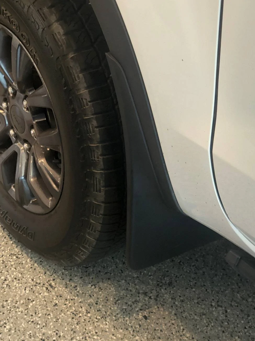

I tend to agree with that observation, at least as it pertains to the massive amount of crud I collect each run on a muddy/slushy trail (most days in the winter).
Your post jogged my memory of an idea I made a strong mental note to try and then forgot as I went down the "alignment rabbit hole" getting them to function properly while clean and lubed.
I just ordered some mudflaps that got good reviews on a couple of guys on YouTube. They don't look too bad (at least on video) and the guy tested them out after installing in some serious paddock mud with good results. I am going to give that a try and maybe with the power washer I can keep them clean enough to work fine long term.
It is ironic as I think they actually are better in many ways to fixed steps for serious off road. Steps that are actually functional to assist someone the size of my wife with ingress and egress hang down low enough, you really don't need to be doing a double diamond rock crawl to turn them in to scrap in a few seconds. The AMP steps tuck up so high, only actual sliders would save the rockers from serious damage if you got high enough to reach them. I did actually gouge the side of my AMP steps on my GMC AT4 and can testify that they are definitely not sliders.
Here is hoping the mudflaps will do enough to limit how frequently I have to roll the power washer out during the winter. :)

So I went ahead and got some mudflaps so maybe I can cut down on the mud and slush I accumulate on the forward linkage (which can't be good, no mater how much I wash it off and re-lube).
I got these off Amazon, seemingly knock off factory style. They fit perfectly, so here is hoping.
Sorry for the bad lighting on th picture. It is hot as hades out there right now, so decided I would keep it in the cooled garage for this round of pictures. I will take some better ones when it cools down. I think they look OK.
