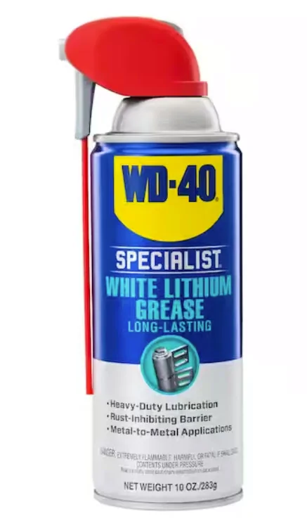

I have had the same issue (as noted in post 46 of this thread) and have been keeping the lubed all summer and they are working fin now. But snow season is almost here and have decided on a plan B.
I am planning on super gluing (any hard core adhesive should do) caps like these (plastic caps) over the pivot pins of the AMP lifters with a very small hole at the 12 o'clock position (to let air out) and inject lithium spray grease at the 6 o'clock position till it comes out the top. That should keep water out and the grease to wick into the pivot. (
) May do the other side of the pivot as well, just for good measure.
I would not use regular WD-40 as it is NOT a lubricant... the WD part (water displacement) may help but it evaporates in a short time (day or so).
IMO: AMP should have designed there pivot location with a grove for a cap to snap into and hold some lubricant.
