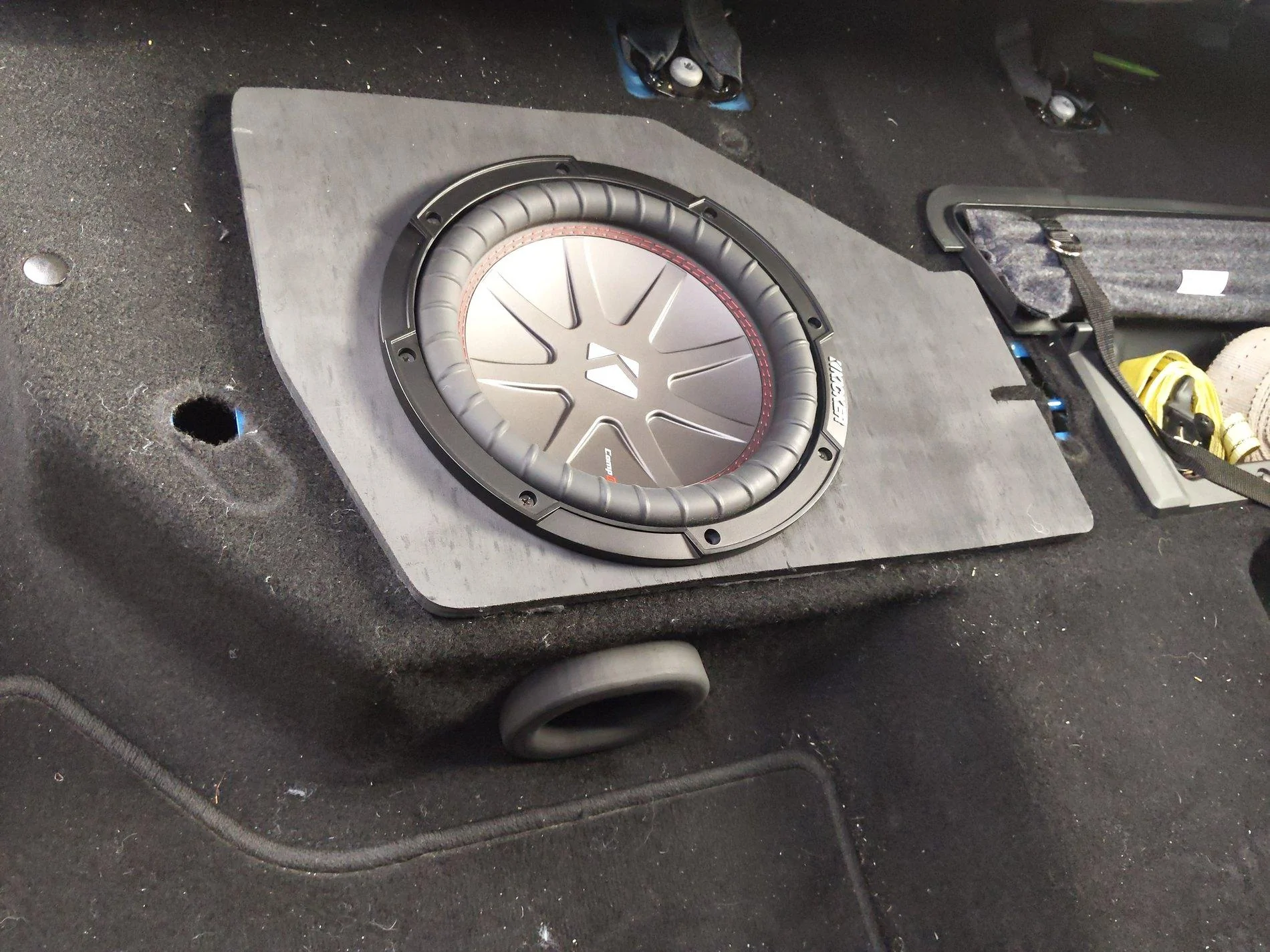

The more I listen to the sub the more I'm thinking it might be a combination of two issues. One the box is smaller than the sub likes (Polyfill should help) and two I think the actual enclosure might be flexing a bit, diminishing bass response. I'm going to pull the box and run some tests and see if it is flexing. If it is some dynamat might fix that issue.

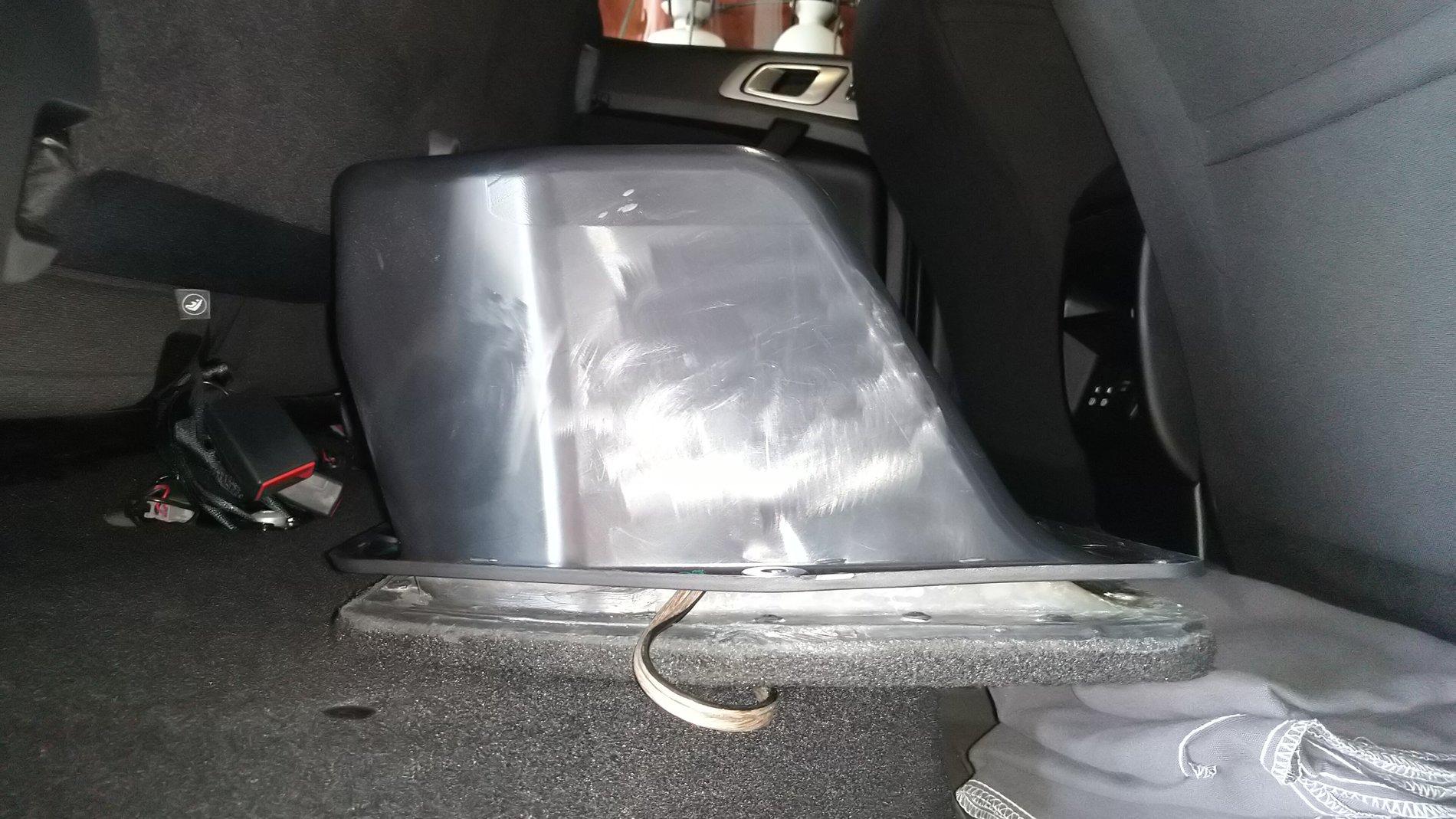

Did your box come from Stealthtech in Australia (the eBay source)? Just wondering if there is more than 1 version of the box because mine is definitely not bigger than the bin. If I were to remove the wire from my box it would fit inside of the bin.
I purchased mine from StealTech as well and I'm wondering the same thing now that you have shown that picture. I stuffed my box with Polyfill to get my sub some better bass response but it really needs to be a bit bigger of a box.

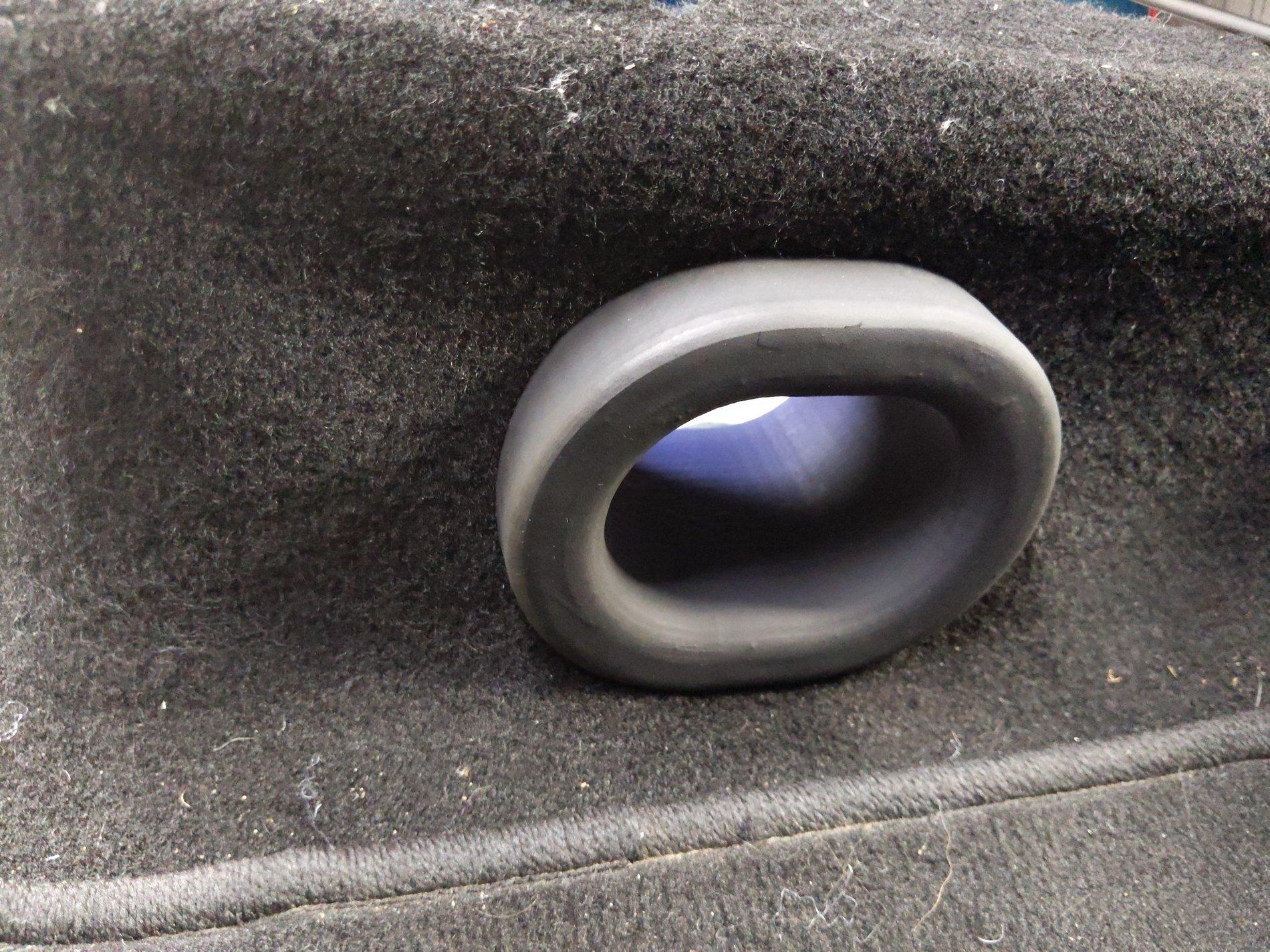

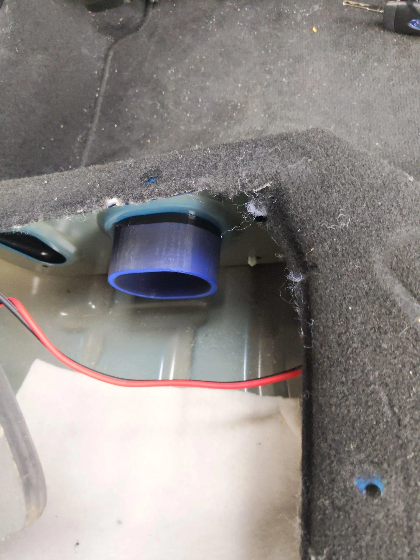

Not sure about the rest of you, but I had a severe heat problem when I installed my under the seat Subwoofer. Admittedly, the original Sub I put under it was huge and old (Alpine R10 originally installed in 2008) but it burned up after about 30 minutes. I like very strong base, so I made an intake using the existing hole in the metal. The part pictured is V2, and I'm quite proud of it.
Haven't melted the new Sub yet, but I will eventually get another R10 and drop it in, so that will be a true test!
Put the images behind a spoiler because nobody likes a screen hog!
