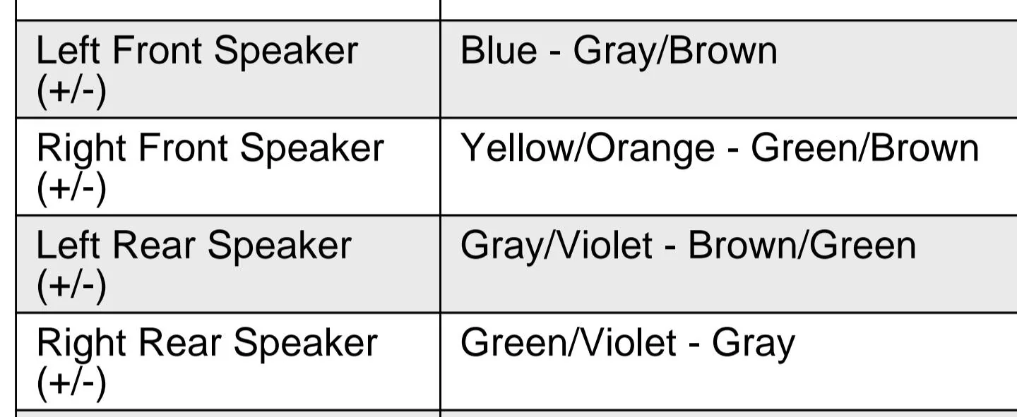

I ran the power wire directly to the battery through the grommet on the firewall at the top of the passenger footwell and grounded it at one of the child seat brackets on the back wall. I tapped the speakers from the loom at the base of each b-pillar. I didn't run a signal turnon because it has a setting to automatically turn on when it receives high-input signal.
So far, absolutely no engine noise... is that only on Lariats?
I'm currently using the supplied velcro straps to hold it in place but I need to hard mount it to get rid of some vibration at high volume.
