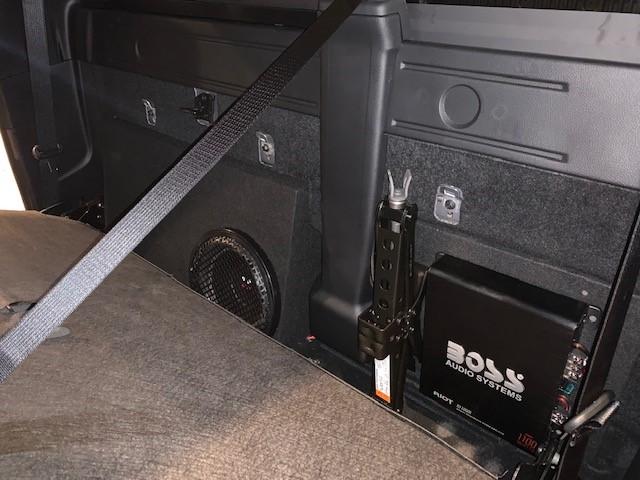

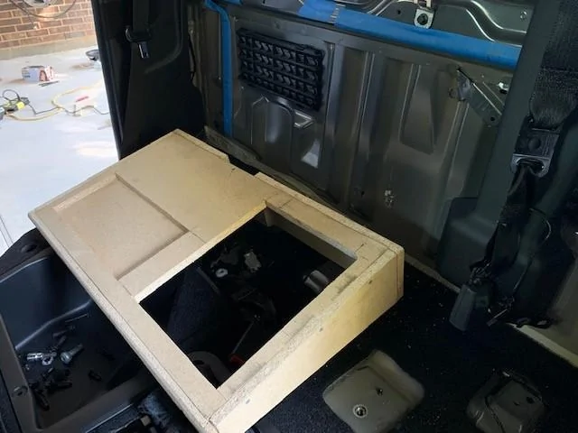

I don't think there's enough air space for a 8w6. I almost went the route of a custom install in that cubby space, but the budget would've been 6 times what I paid for my JL Audio 8" micro sub behind my seat. model #CP108LG-W3v3
Hey I am wondering how you are fitting that box…are you not putting the seat back up? I have tried a truck style box from JL with a depth almost identical to that 8 box. Does not fit. I also have tired a active Box at 5” depth. Doesn’t fit. The model of the 5” is JL Audio ACP110LG-TW1. If anyone has any info or help. Please let me know. I really don’t want to use a hideaway.

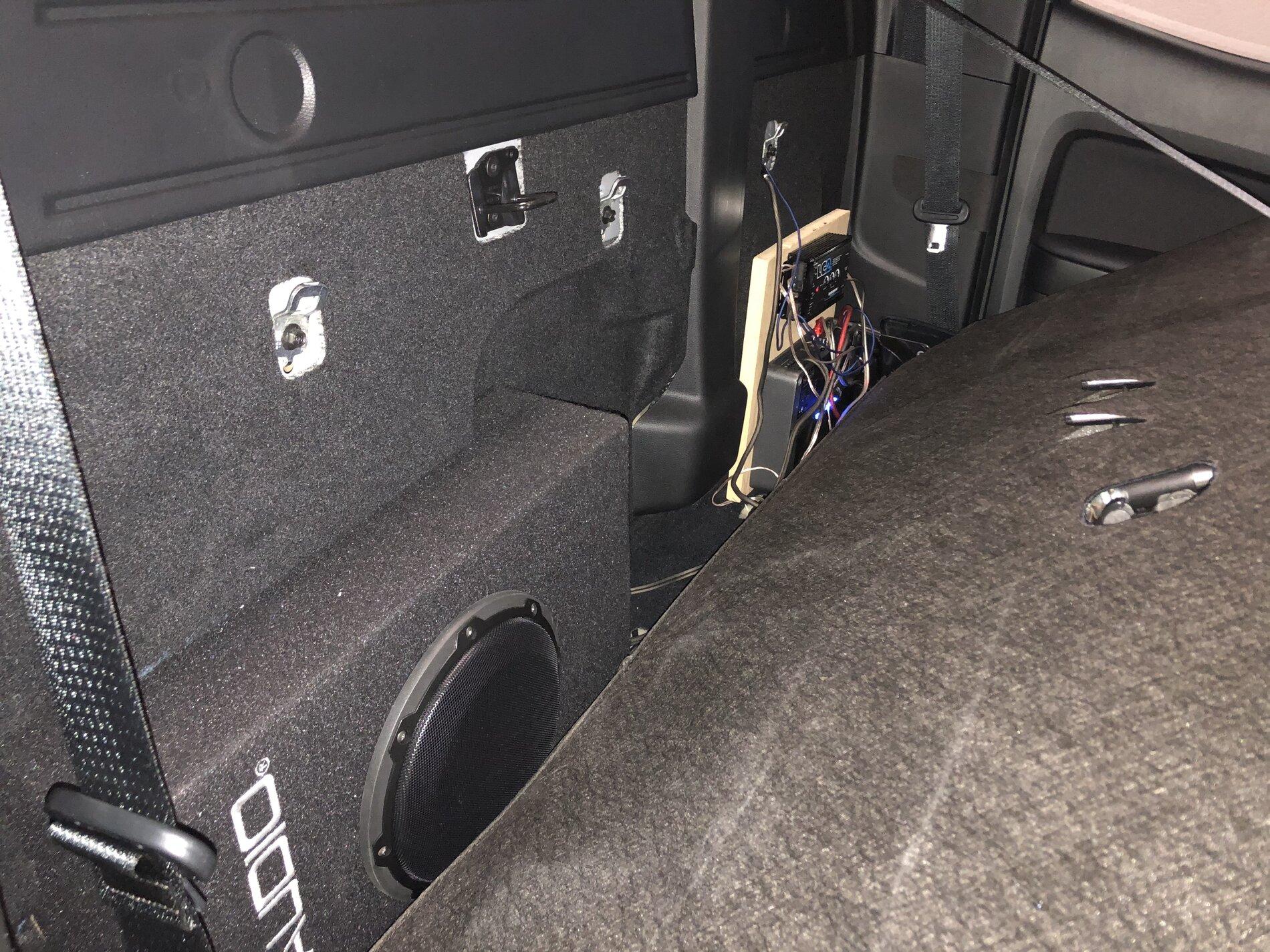

That box will fit if you cut out the carpet. I tired 3 different similar boxes and they all fit, one from alpine,, one from.kicker, and one from jl. I just didn't like the end result sound wise.
Thanks for your reply, I have had the carpet out. And it still will not close. I did however look back at his past post now and see that he mentioned how he did it, so I may try that. Idk how I overlooked that post lol. Thanks again!
I took the carpet out. It will fit in the space but I can not put the seat all the way back up.

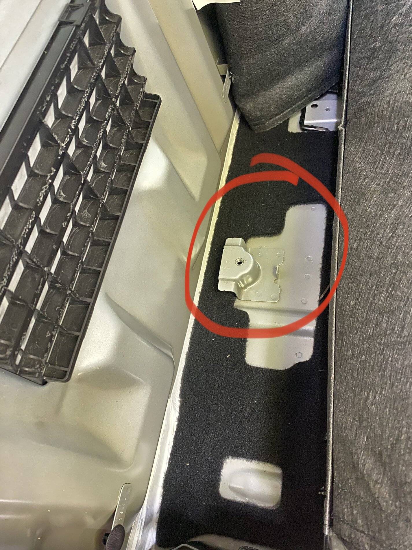

My next question what has everyone been doing with the Jack stand holder thing. Leaving it and building a stand around it. Or removing it? It’s welded on it looks like. Thanks again in advance.

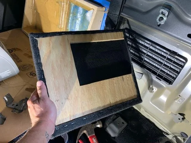

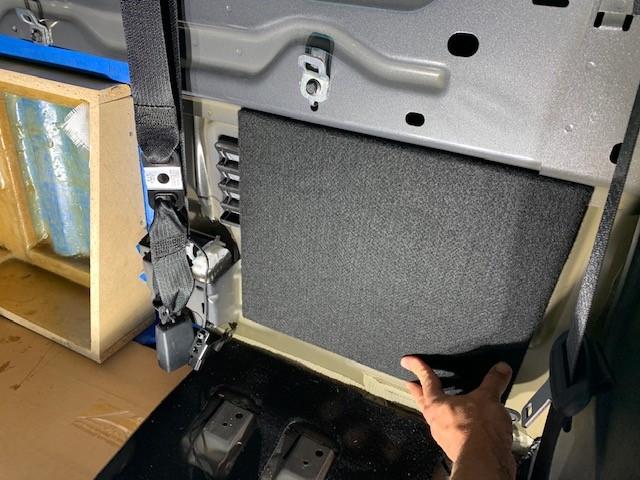

Sound on a Budget: It took some time but I finally got the airspace needed to get the sound I wanted. Kinda came out nice I think. Thanks to all those who post here and share. It made wiring much easier for me by observing the adventures of others. Cheers.
Welllll now I know how I'm spending my weekend. This looks incredible. I'm going to have to try my best to replicate it lol.

Sorry, I don't come here much anymore, but it looks like you got your question answered. As far as the jack, I installed one of the swing out tool boxes in my bed. I keep the jack there along with jumper cables, tie downs, work gloves, etc.

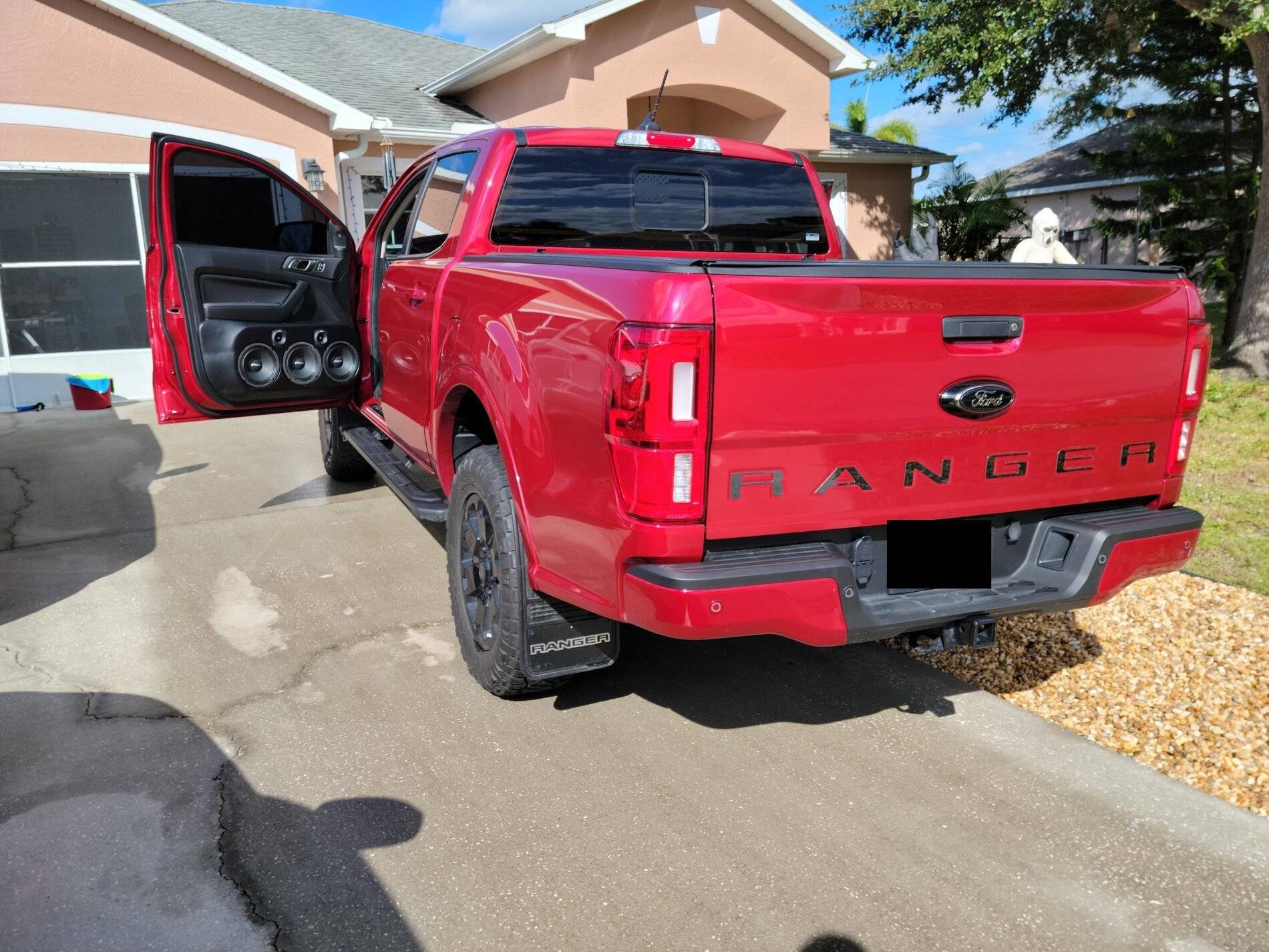

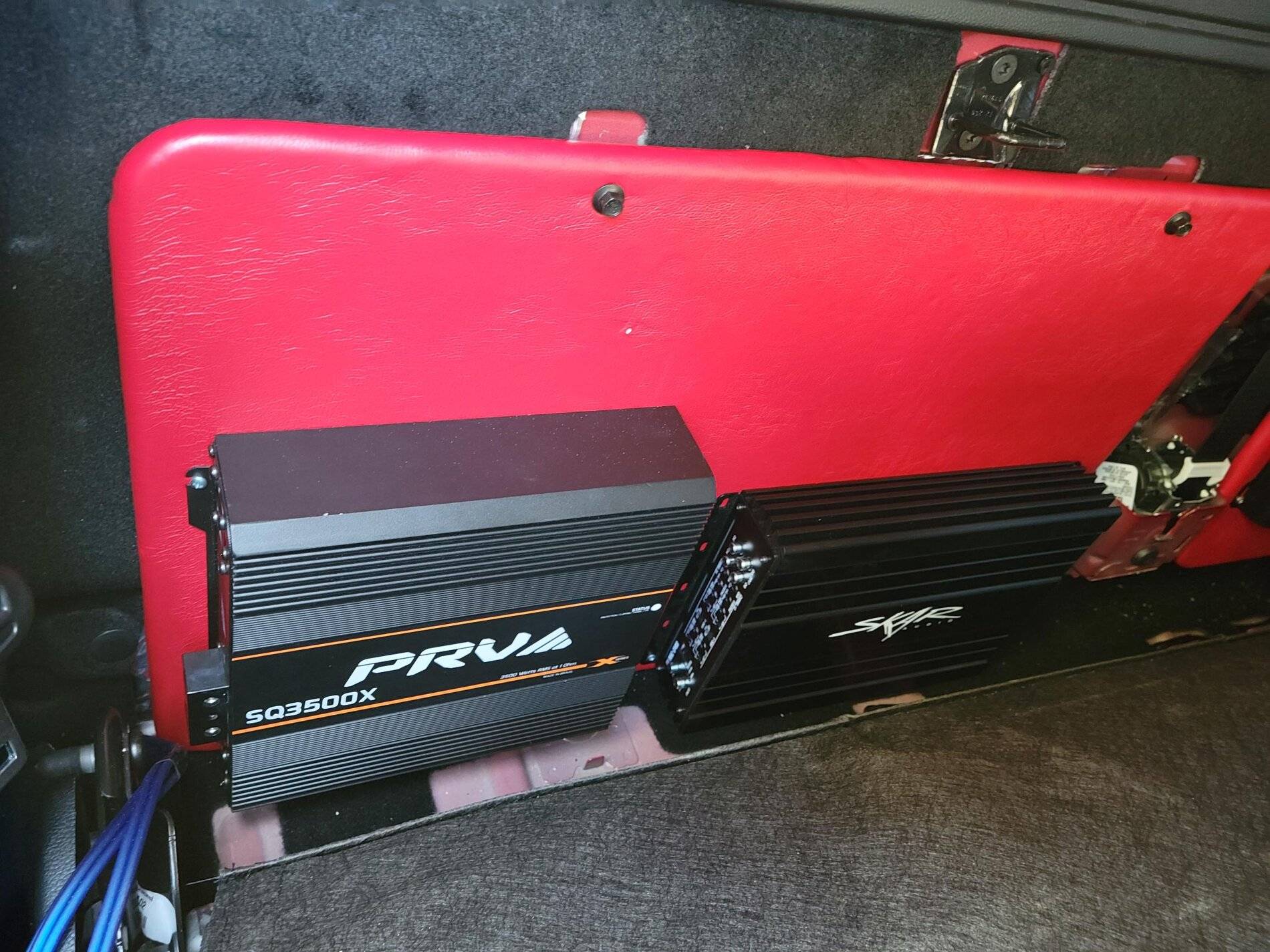

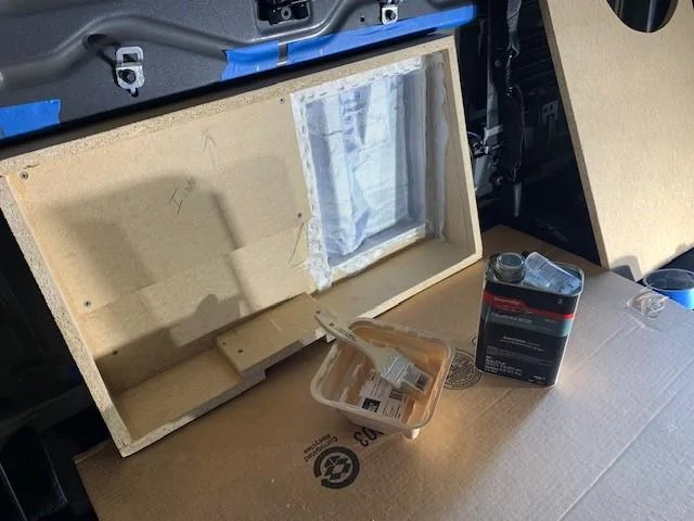

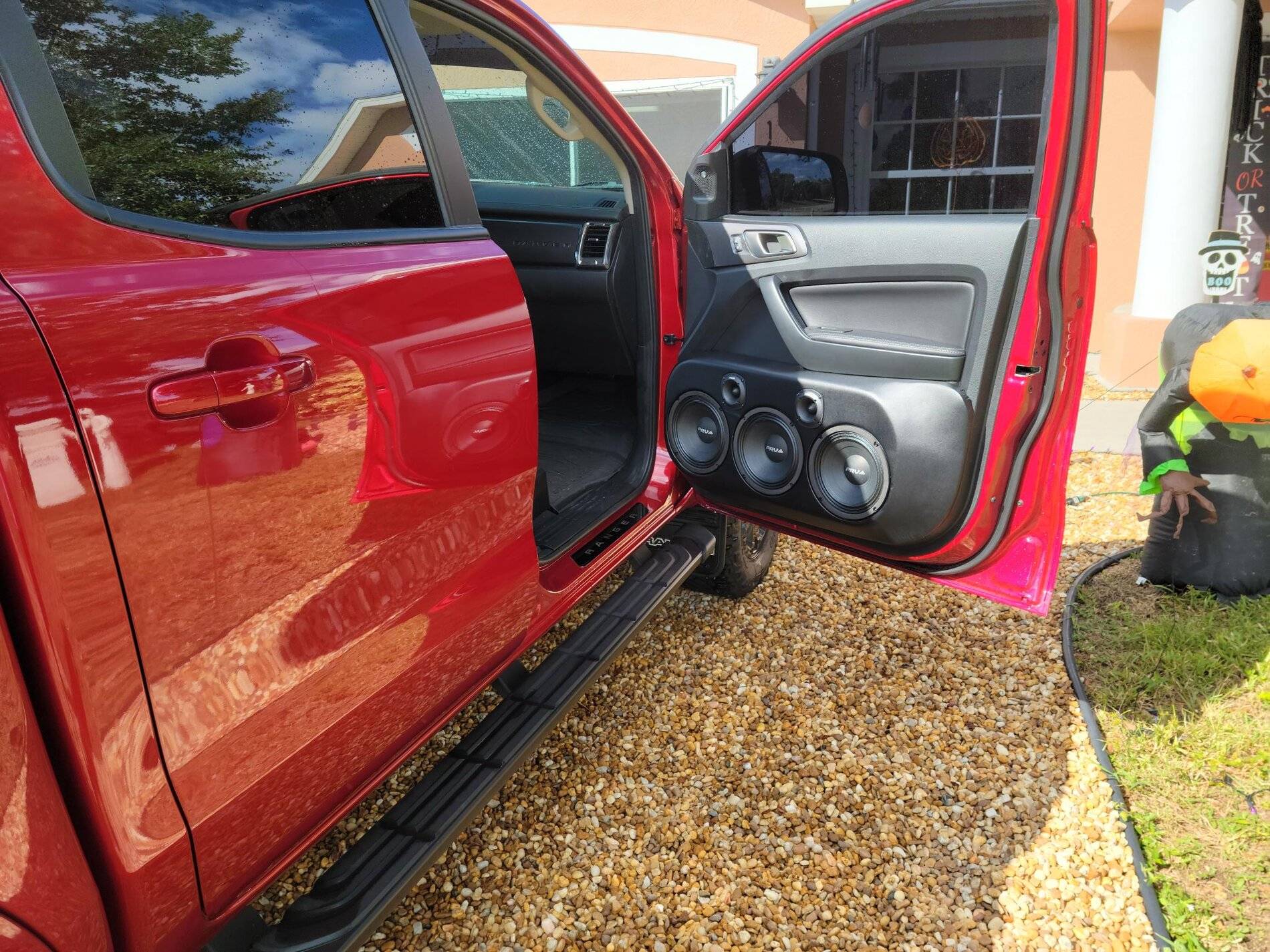

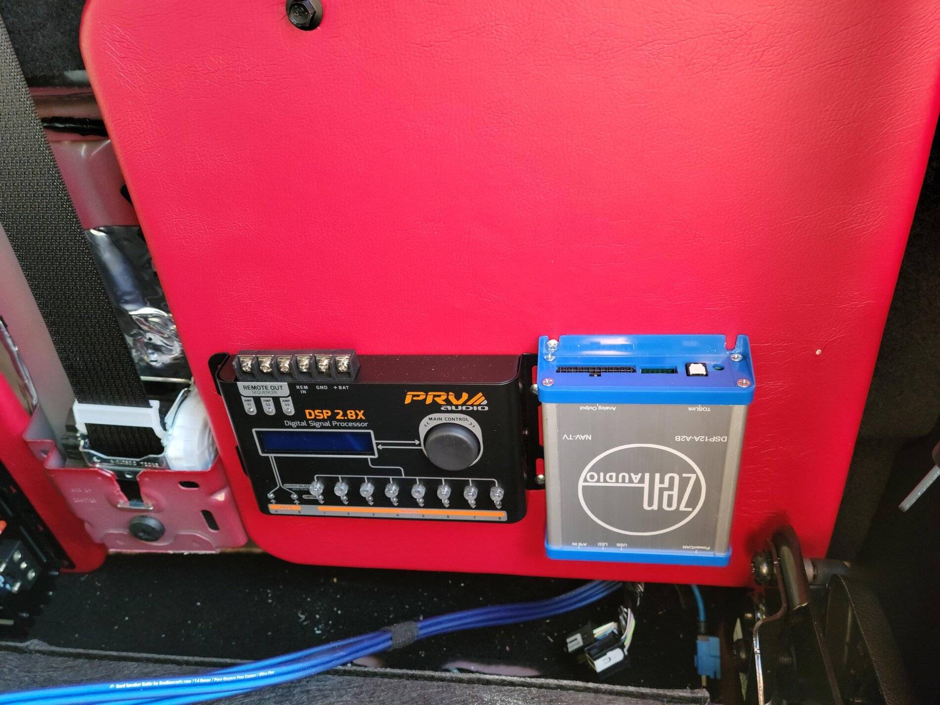

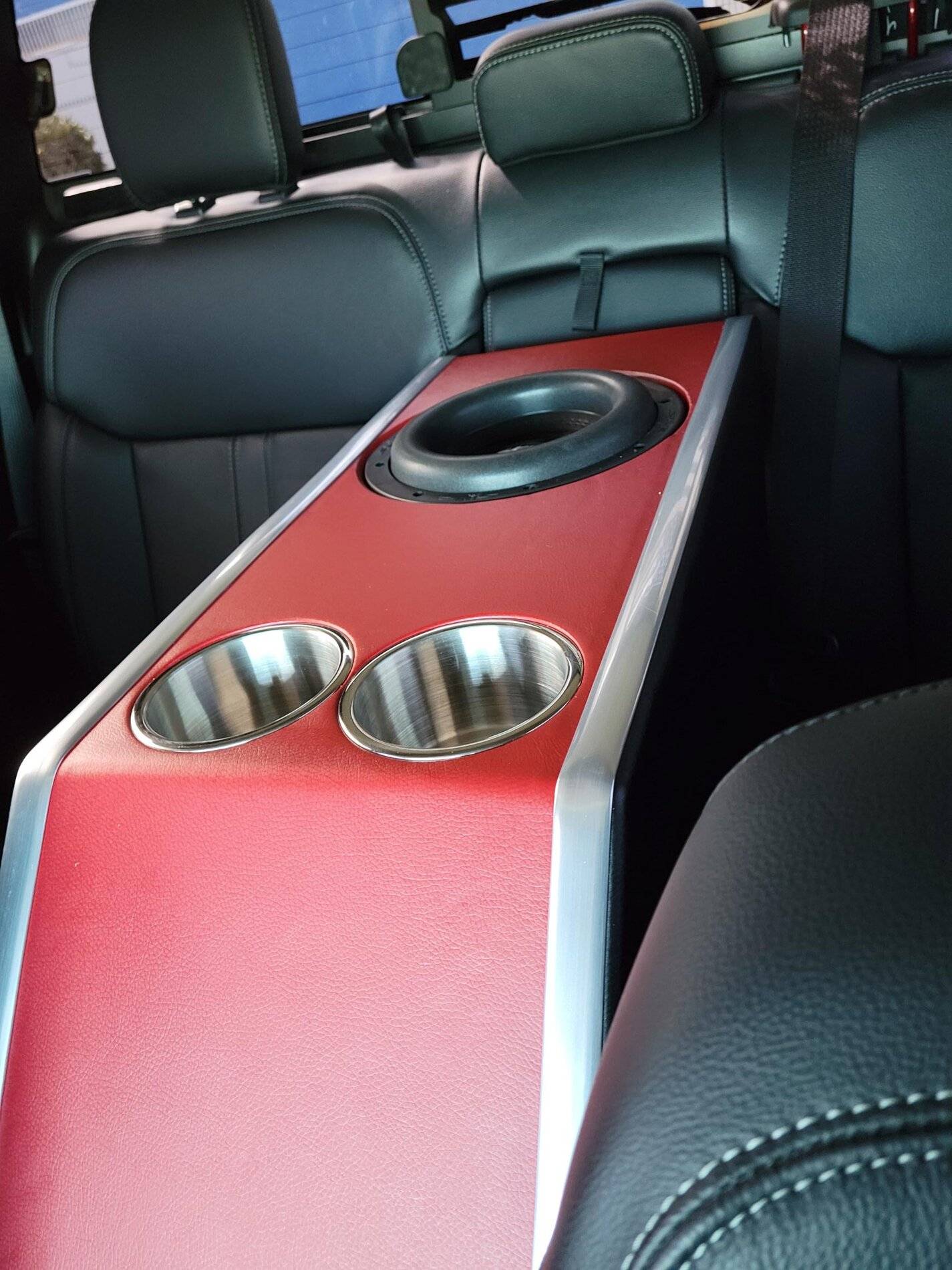

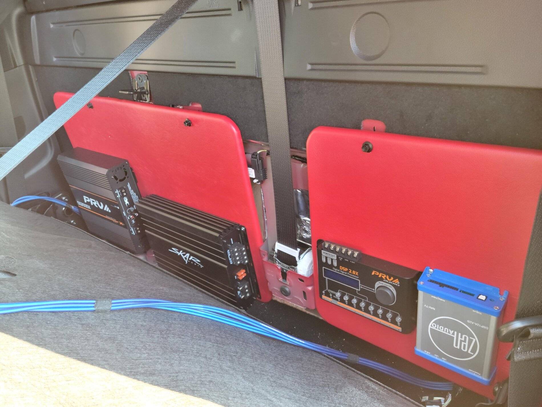

First I want to say thank you to everyone for input regarding hooking into the factory B&O system.
Secondly this build will not be everyone's taste, that's fine, but I built what I wanted and wanted to share, Im big into home audio and car audio.
I have a 2021 lariat. Im using the Zen Audio A2B processor connected to a prv DSP. Then I have 6 PRV 8" midrange on a prv 3500watt Amp. Then a skar skv2 200.4 running 4 titanium tweeters on channel 1&2 @ about 800rms, and a skar audio 8" ZVX8 on channels 3&4, also about 800rms. The center console is getting redone as im not happy with the output but for now this is what ive got
