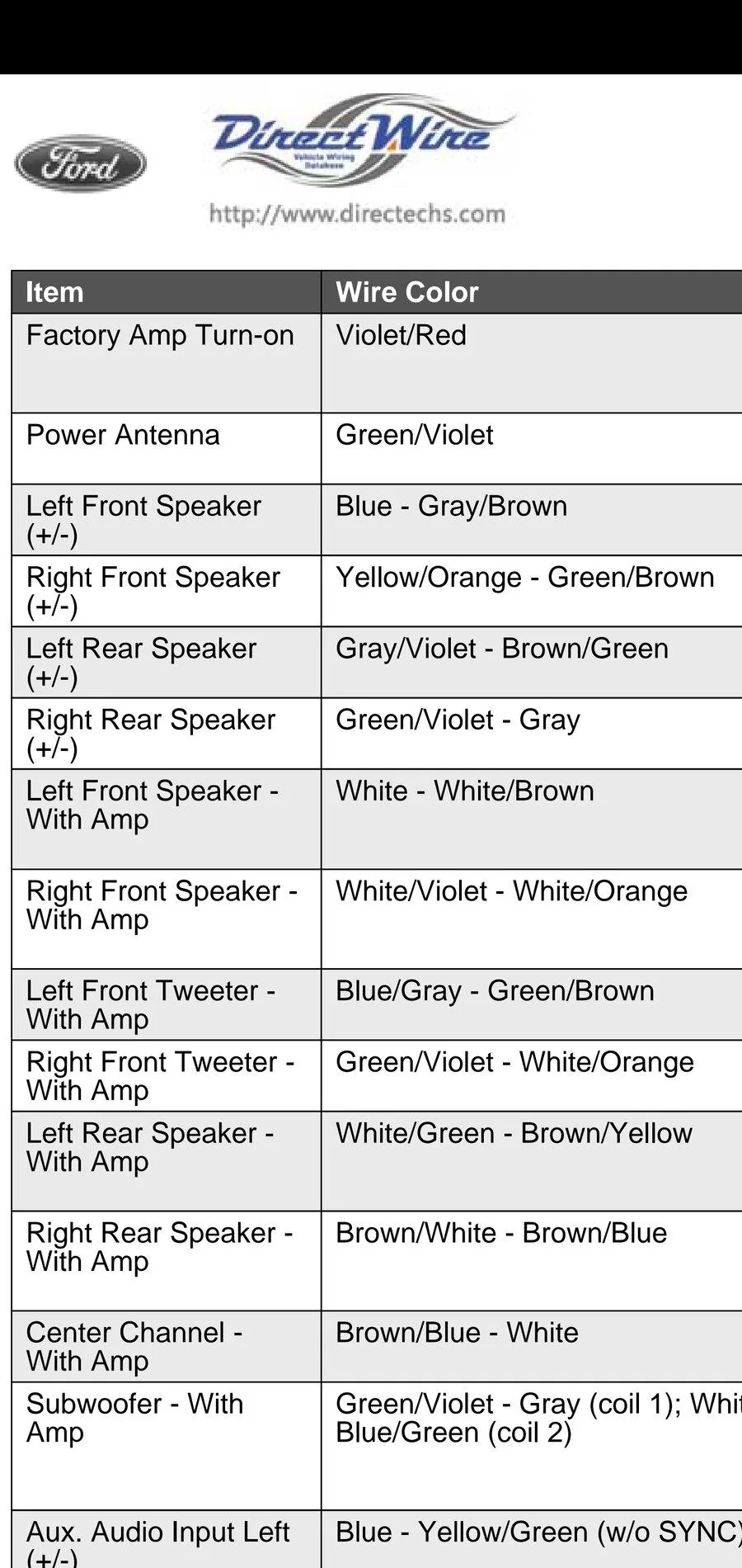

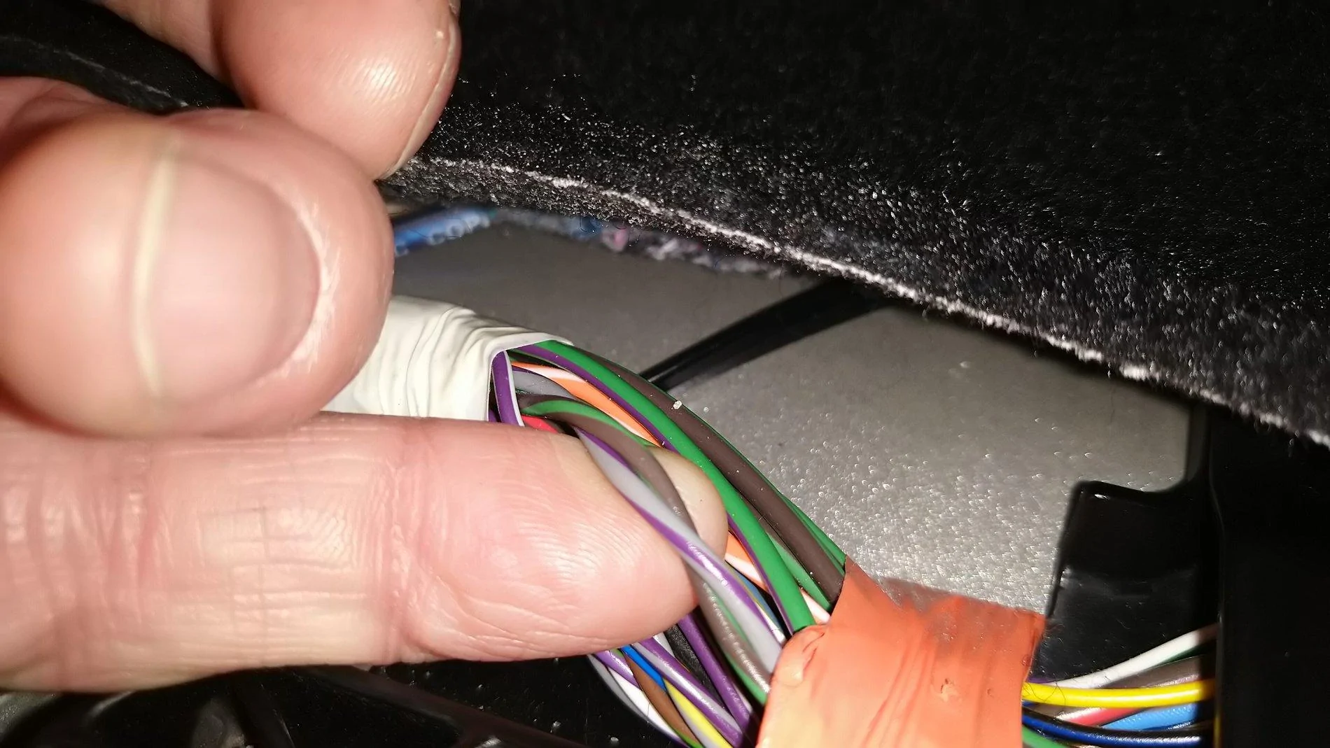

I don't have the B&O setup & I tied into the rear wires behind the B pillars but after I had already cut the wires I realized they enter from the rear & not the front (I'm guessing it has something to do with the enhanced engine sound).
You could probably tie into the rear speakers by just removing the floor trim.....the attached pic is with the driver's side rear floor trim removed. I did not cut all the tape & trace it back so I would remove one of the B pillars & trace it back to verify this is true before cutting the wires.
Also....I originally used the rear speaker wires as input for the sub amp & had the fake engine sound in the sub. Last week I changed the sub inputs to the front speaker wires & I have not heard any fake engine sound in the sub since. In hindsight I wish I would have removed more of the carpet to see why the rear speaker wires enter from the rear.
I also attached the direct wire PDF if you don't have it. Page 4 has the speaker wire colors & polarity.....the speaker wires are also twisted together, makes it easier to find them.
This was exactly what I was looking for. Just installed a JL Audio RD500/1 and spliced into the left and right rears on my 2020 non-b&o system based on this diagram. The color coding matched exactly. I only had to remove the one floor trim piece between the B and C pillar (the piece your rear passengers would step on to get into the truck). Super easy install!

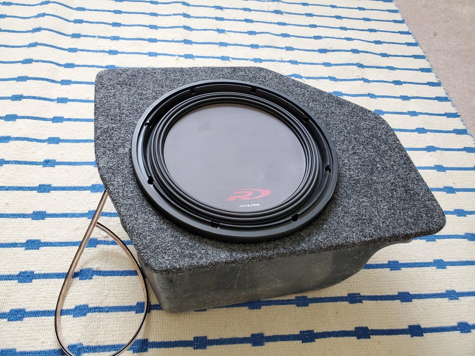

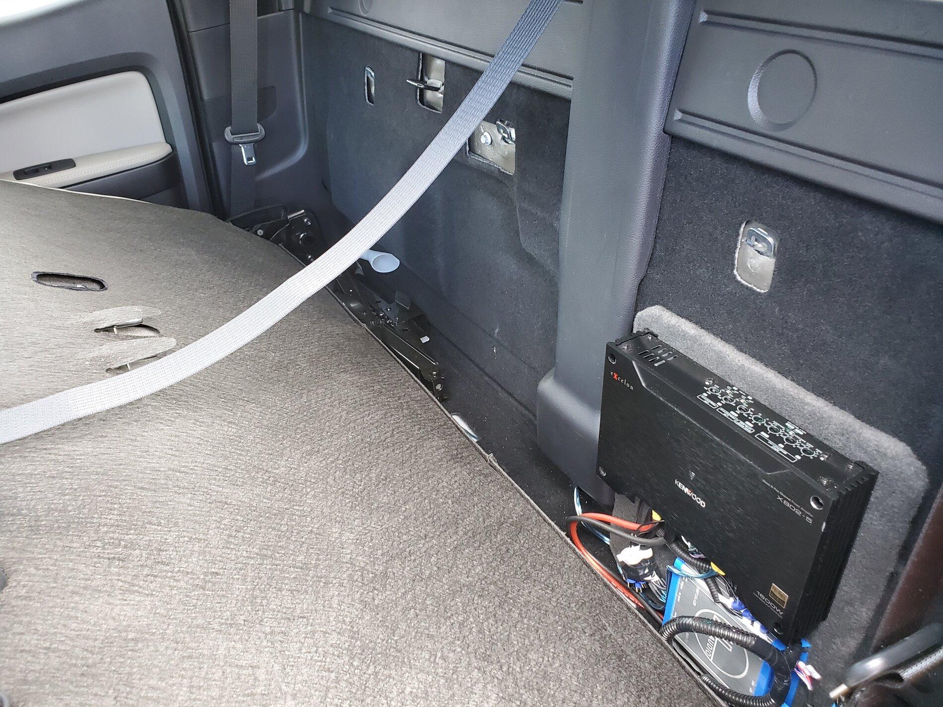

I enjoy this setup a lot. Alpine swr-T10, Aussie fiberglass box, and Excelon x802-5. I also put in all alpine type R component speakers and sound deadening in the doors and back wall.
