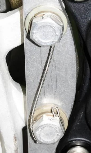

Could drill and wire the bolts like aircraft hardware.
I was thinking the same but would need to be 0.32 like the pic above , but add a locking tab to attach it at the frame mounting bolts vs side to side each bolt would have its own positive lock
