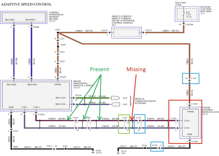

Bad news is a new harness will need to be made to go from the CCM to the IPMA.

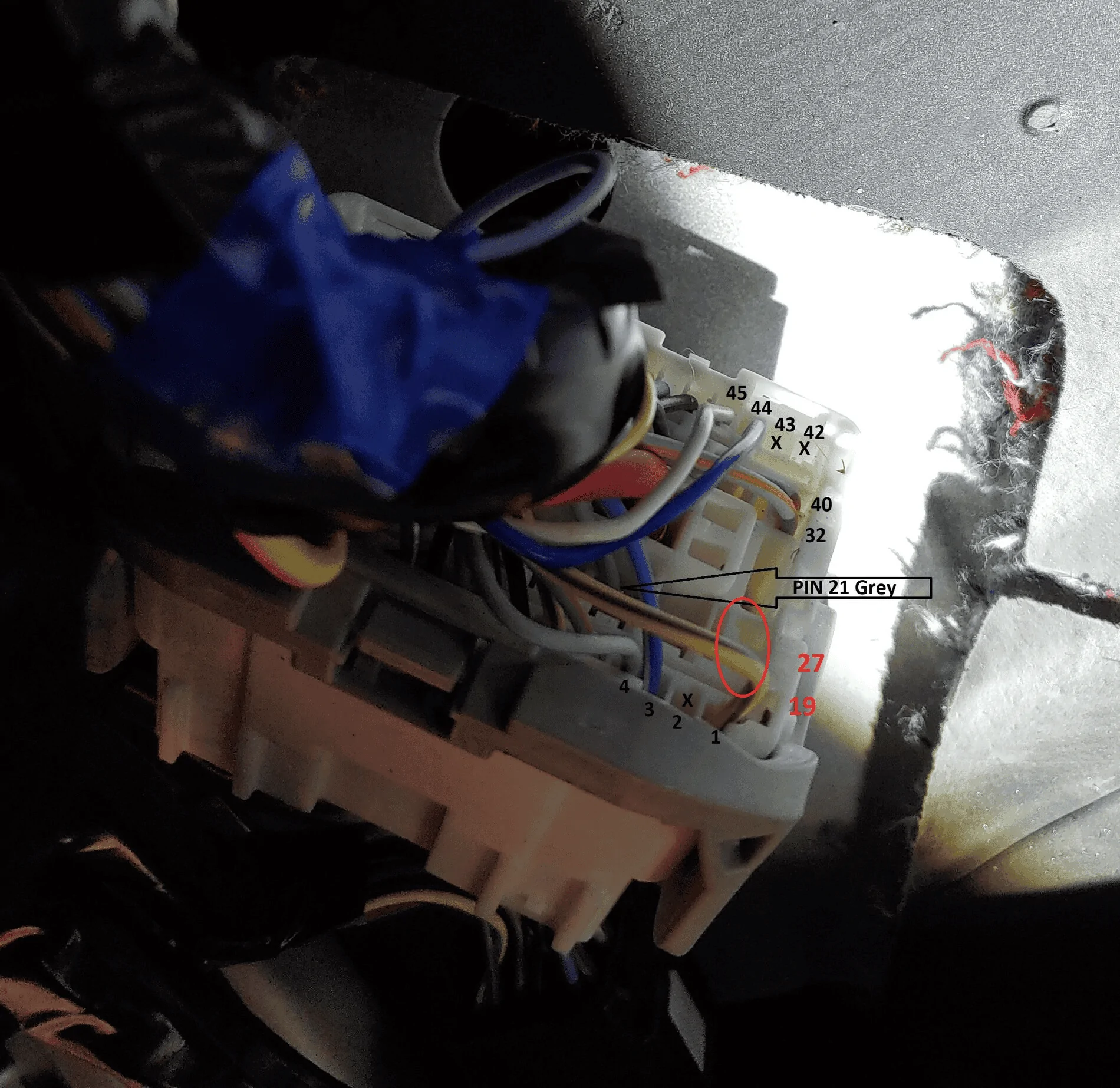

Below is from my Heated mirror install. This is connector C237 on the drivers side kick panel. You are looking at the harness side that comes thru the firewall. There are no can-bus wires coming from C145. Ignore all the black numbers - what we want is pin 19 and 27, you can see there is no wire
Looks like the can-bus wires are there at the C9224 IPMA and at both sides of C919 and C903. So should be on the backside of C237.

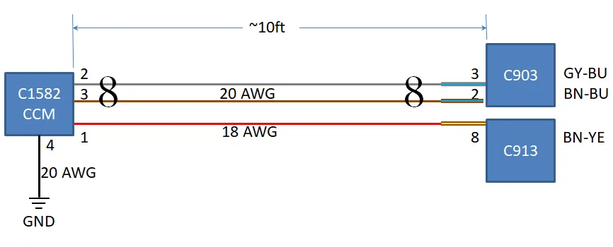

Probably easiest to do as @CHrisin did and tap in at the A-pillar (driver side for us!). Looks like I will go this route as the BN-YE pwr wire is in C913 which is right next to C903 in the A-pillar. Disconnect battery - there is an airbag in the A-pillar! NOTE that the power for the CCM is NOT battery direct it comes from the DC/DC converter
The last connections to the CCM is Ground (pick a spot!).

Yes that how I was going to do it - but always good to get tips! Question is what length to start with pre twist!
I am thinking ~10ft from the stock location. I plan to use a ground point on the passenger side at the front of the vehicle - assuming I can find it w/o removing the front end! Or I will just make a ground point. I am duplicating Gauge used in the stock harness. C903 and C913 are both at the bottom of the Driver side A-pillar.

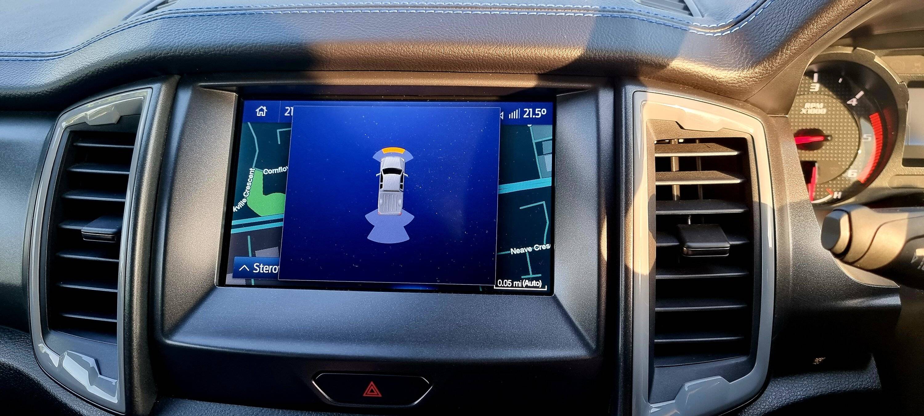

I had to make a new wiring harness from the bumper to the BCM and update PAM module soft, everything works fine.
