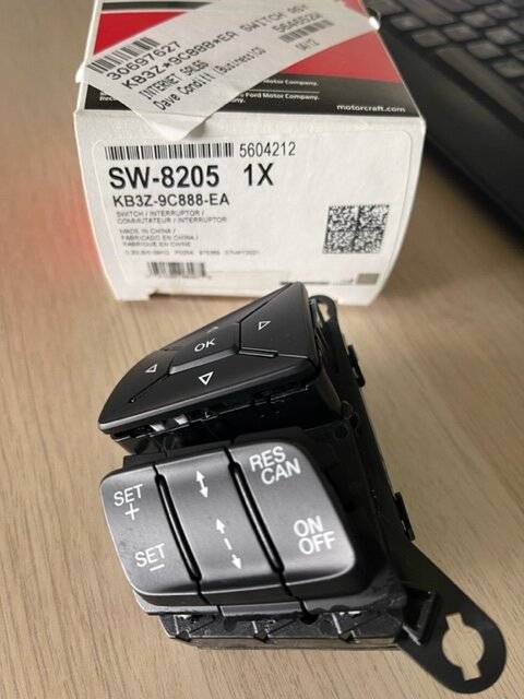

The switch we need for LH drive in the US is: KB3Z-9C888-EA
It's listed as LH switch w/adaptive cruise.
Correct - I hate it when they have the wrong part picture. Worse than no picture.
I just spent some time looking over the wiring diagrams. It May be easier / cheaper to do as CHrisen did and make a harness. For NA trucks we would tap into the wires at the Driver Side A-pillar. Could save having to take the bumper apart, not hard but tedious.
Only 4 wires - much easier than adding Lariat Mirrors!

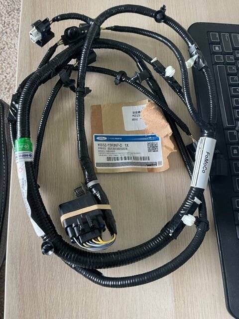

I believe there are 4 harness's available. This is the one I purchased which is for adaptive cruise (has the connector) and also parking sensors, which my truck also has.

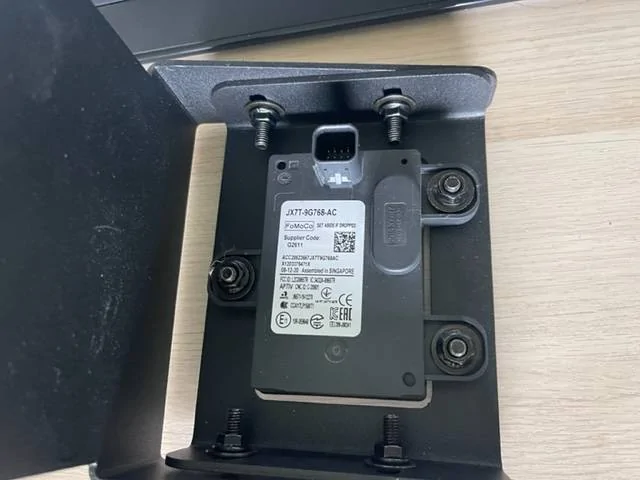

Here is a list of what I purchased to do this mod (US Model 2020 Lariat trim Ranger ecoboost).

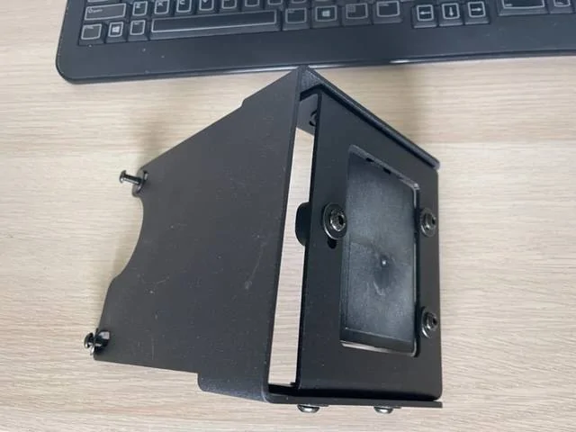

I bought an aftermarket mount as I want to also install a light bar when I pull my front bumper to do this mod. Mount from Amazon.
Here is the part number of the radar unit (which you can source from a wrecked Ranger):

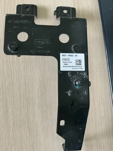

If you want to go the factory route, you will need this bracket. It is missing the 2nd piece to mount the radar unit, but Ford will sell you both piece's with this part number.
The steering wheel switch (LHD US)
The harness (Varies if you have parking sensors, this is the part number for parking sensors)

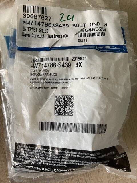

If you go with the factory mount, you will likely also need some bolts and nuts:

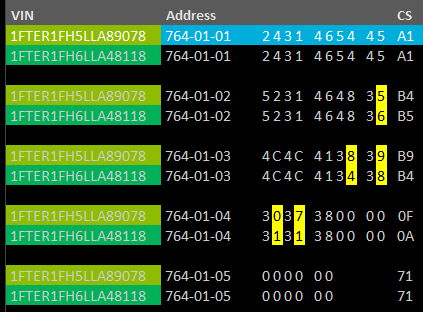

CCM (Cruise Control Module) is NOT present in vehicles without Adaptive Cruise Control. This module contains your VIN Number in ASCII HEX https://www.asciitable.com/
For US vehicles this block starts with 24 ($)
764-01-01 Starts with 24 (which is $)
764-01-02
764-01-03
764-01-04
764-01-05
Here are 2 trucks with ACC starts with 24 ASCII($) and their VIN's 31 is ASCII (1) Hex 46 is ASCII(F) HEX etc.... fills the rest of the blocks with 00 after the last VIN number:

We know the first 4 blocks are again the VIN number in HEX.
So that leaves
760-02-01
760-02-02
760-03-01
And looking at these blocks (VIN ending in 78 and 18 have ACC) there is pattern to the coding:
CCM:
764-01-01 > 21VV VVVV VVxx
764-01-02 > VVVV VVVV VVxx
764-01-03 > VVVV VVVV VVxx
764-01-04 > VVVV VVxx xxxx
764-01-05 > xxxx xxxx
764-01-01 > 24VV VVVV VV CS
764-01-02 > VVVV VVVV VV CS
764-01-03 > VVVV VVVV VV CS
764-01-04 > VVVV VV00 00 CS
764-01-05 > 0000 00 CS
(V = ASCII HEX of your VIN number)
CS = checksum for that row

CCM:

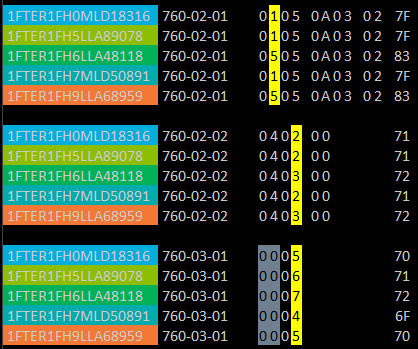

And lastly the ABS Module:
AntiLock Brake Module
ABS:
760-03-01 > xxx# CS
ACC = a value of 2 (So if you have a 4 here, it becomes 6) If you have a 5 here (You truck also has a Elocker) and this becomes a 7
(So you will have a 6 or 7 when adding Adaptive Cruise), depending on the ELocker option (which has a value of 1)
I do not believe any changes need to be made to your PCM to enable this option.
Lots of talk on the Ford Focus forms about adding ACC and getting the calibration error. It appears to have something to do with using used parts or new and do a calibration of the module via Fords IDS. (New needing IDS and used worked).
(This is untested.... But compared lots of AS_BUILTS).

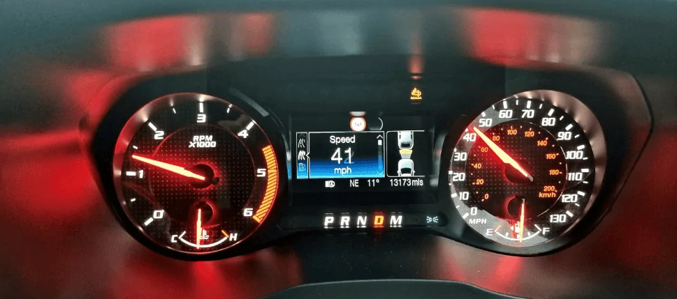

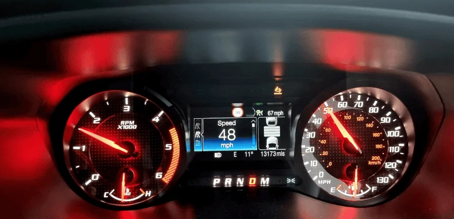

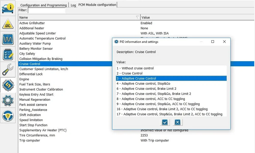

Full success!
Everything is working perfectly fine.
Cars driving on either side don't affect it, it only sees cars in front of it. A lot of people had a problem where the relocated sensor would pick up cars on either side, but this doesn't happen here. Most likely due to calibration.
Turns out Forscan has a calibration, you need to enter service mode to turn on calibration.
I had two faults, one fault made the calibration not work. This was caused by a wrong value in CCM:
764-01-01 21xx...... (previous) -> 23xx ... (corrected)
21 is an EU Ranger and 23 is a Raptor (which I have).
After calibration 3 faults came up, ABS, IPMA, and PCM.
This was caused by a wrong value in ABS:
760-03-01 xx31 xx (previous) -> xx3D xx (corrected)
This solved all those faults.
@daczone The PCM change is required, the extra module will change the resistance and more power will be required for everything to be working correctly. It may not work correctly without it, throwing faults, switching off, and breaking, especially during braking. A lot of people had this fault and changing PCM fixed it. The image attached below shows that PCM needs to know which CC you have.
US version will differ from UK one.
There will be difference in IPMA
706-01-01 XXXX 9XXX AA (UK) -> XXXX 9XXX A9 (US)
This 9 is responsible for LHD or RHD
SCCM will also most likely be different as the button layout may be different.
Also PCM and ABS most likely will be different as I've noticed that it has a different software.
Other modules should be the same.
