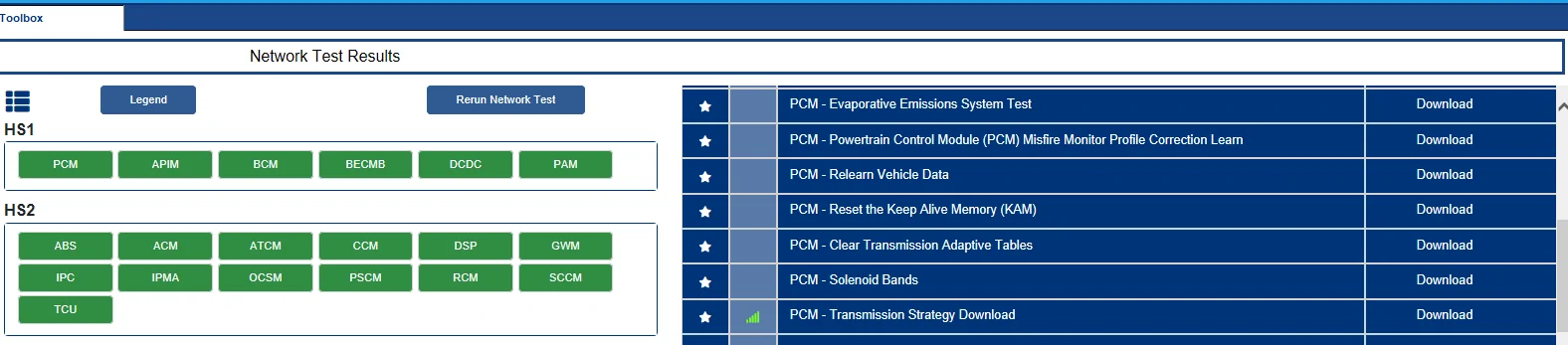

I did some digging and I think I see the issue
It's the calibration level (Software Change) that's triggering the code
This needs to be completed - (PCM - Relearn Vehicle Data) this is how the tab is labeled.
What this means:
The relearn will allow all the associated modules with the Cruise Control System (Adaptive)
Learn the operating profiles of each other they are the ABS - CCM- IPMA - RCM - SCCM.
So basically, the CCM is all alone in the communication and it cannot see the other modules and the Relearn Vehicle Data will allow that to happen
I do not believe Forscan has this authority in the software, some high-end scan tools have it, I would have to check mine (IDK if its available on them) but Ford - FDRS does.

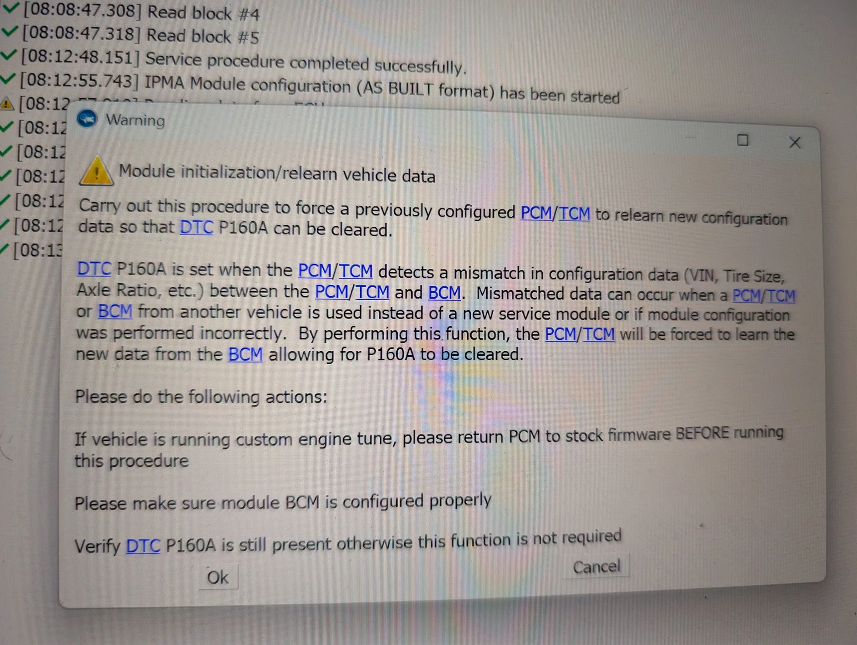

Poked around Forscan a bit and i do have that option, and this is the heads up message i got.
As i do have a custom tune on the engine, this will have to wait for a while 🫣😭😅
