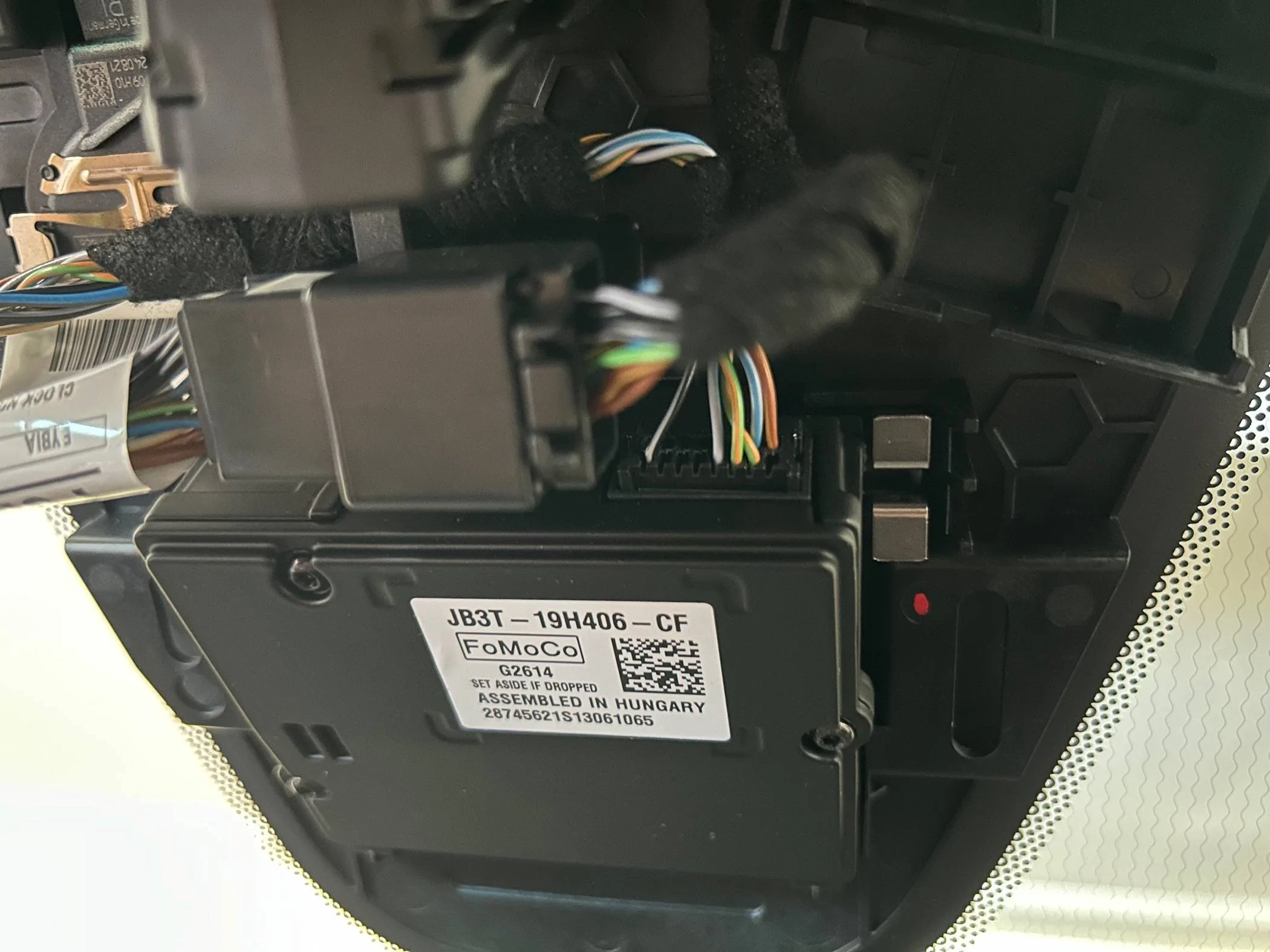

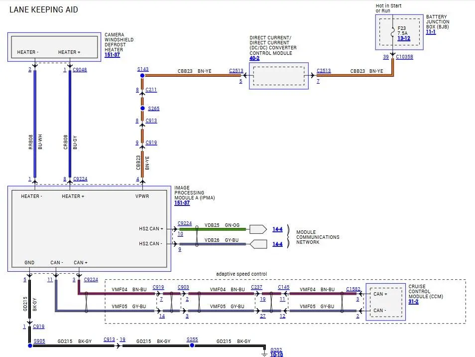

Hey guys, i have the following trouble on my 2022 Ranger Raptor: the canbus wires are ending at the male C903 Connector. They are‘nt going up to the camera.
Any suggestions?

Ref This thread for Connectors (at the mirror)
Non-auto Dimming Rear View Mirror Power | 2019+ Ford Ranger and Raptor Forum (5th Generation) - Ranger5G.com
NOTE: The ROW Rangers are wired differently (as it appears yours is) from the US Version
This is from the US Version.
The IMPA = C9224
Ref above thread for the connector location, that connector feeds over to the IPMA
You will have to decipher the wire pinout and color vs this diagram, determine which 2 wires are not routed over to the IPMA, then determine where they go into the C9224 connector.
So, if the wires are run to C919 then all you need is to get some terminal ends and tap into connector C919 and route to C9224, but if you note the US Version and the ROW version are pinned differently
This is where you will need a wire diagram and pinout for the ROW Ranger, but this one will give you a basic wire run.

Sorry for the delayed reply to add to the discussion:
For me, I went to a local junkyard/recycler and grabbed the short harness between the IPMA and the connector. My Ranger didn't have the wires either but once I installed the new little harness under the IPMA cover, all was good.
