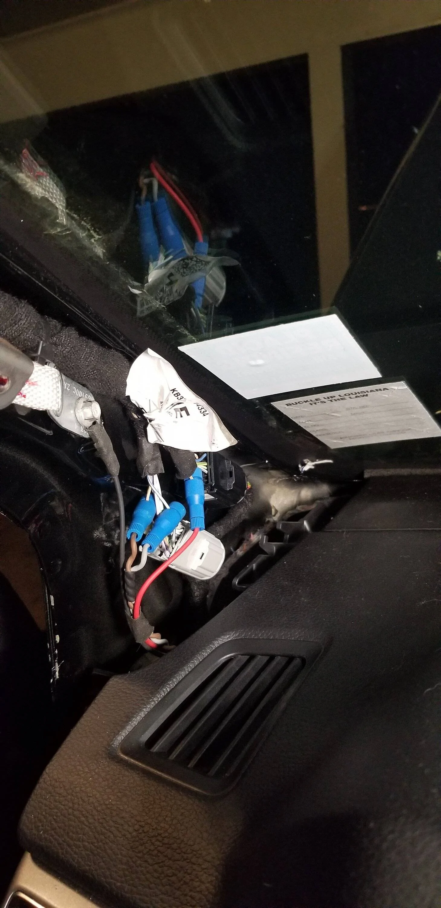

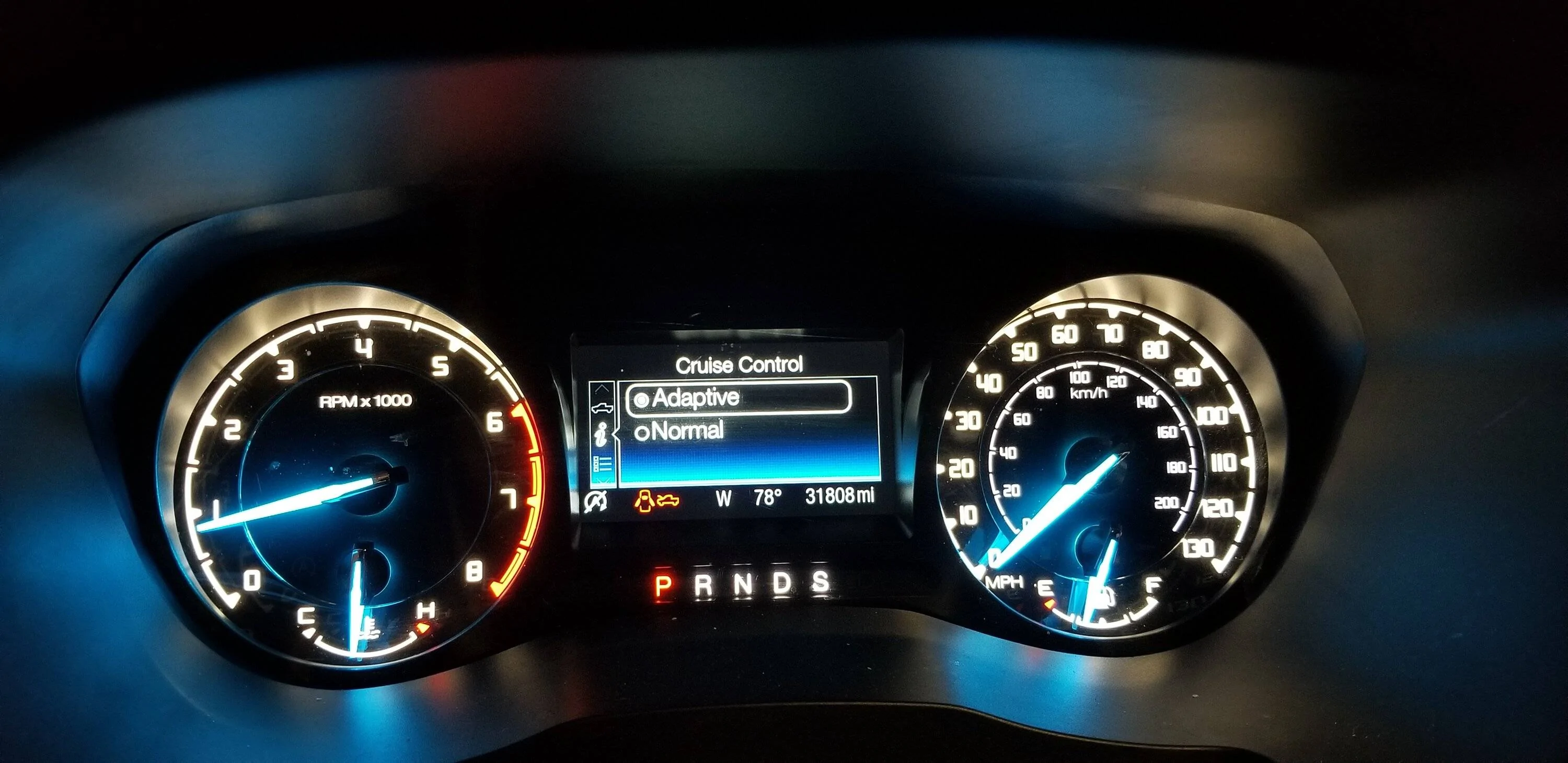

I finally did it! Installed and working, mostly.
Ended up using Positaps for the connections as I didn't want to bust out the soldering iron to splice in wires. The 18 gauge wire I used was a little difficult to fit into the terminal pins and housing for the CCM connector, but it worked. Might suggest 20 gauge or thinner insulated 18 gauge as previously suggested in the thread.
Got really nervous when the CCM was not showing up in Forscan, but creating a new vehicle profile while reloading seemed to be the solution. Worked great for most of the quick test drive last night, but got a "sensor blocked" error right at the end of it. There didn't seem to be any obstructions, but the user manual says that it can just sometimes throw that error for no reason and you have to hope it goes away or doesn't come back after ignition off. So hopefully not a significant issue, but only time will tell.
Just wanted to say thank you for all the work everyone put into this!

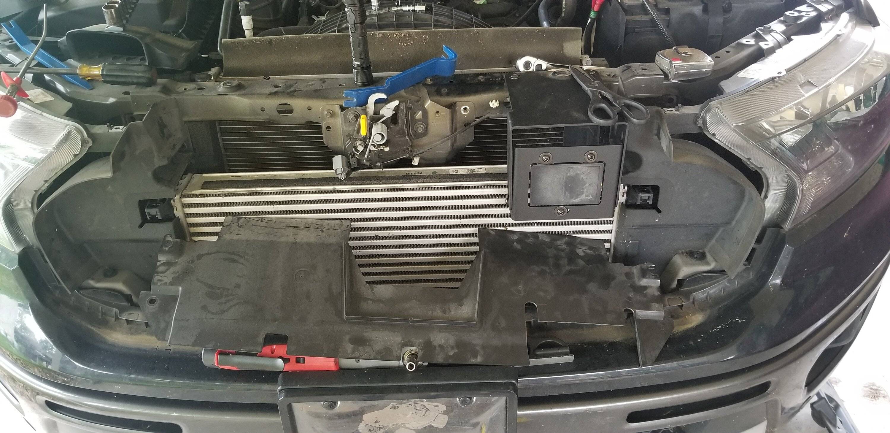

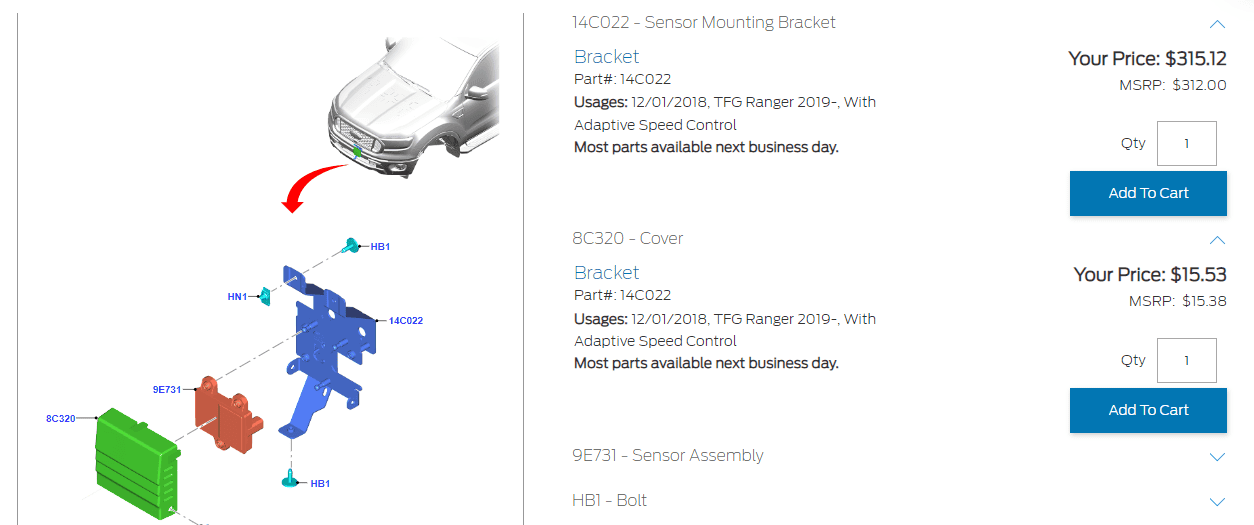

Great work. You shouldn't need that cover if you have the CCM up in the grill. The cover is to protect from rocks and stuff when it's down low.
Plus, I don't think there's room for it. I have the grill mount too.
Yeah I went with the Westin grill mount and planning on that aftermarket grill insert to fill that gaping hole. Just trying to help Tom find one for him :). Though I'm almost wishing I just did the factory mount as the CCM keeps "getting blocked" randomly even though it's at the lowest adjustment I can set. Its been leveled during install and added a stiffening bracket, so I'm not sure what's happening.
I know there are a couple threads where people were having issues after CCM relocation so I'll have to look into that after this trip. Maybe even calibrate if I get desperate. At least you can still use regular cruise.

I Found the cover, and it actually has already shown up. It will be mounted in the stock location. The rest of the stuff should be here by next Thursday. The module changes that have been documented earlier in this thread still hold true? Thanks for the help so far

Just finished installing everything, works perfectly. THANK YOU!!!
I did have about a 1/2 hour of oh Shit, It doesn't work. The module isn't showing up.
Then I remembered you said you had the same thing happen and had to make a new profile.
All good Now
