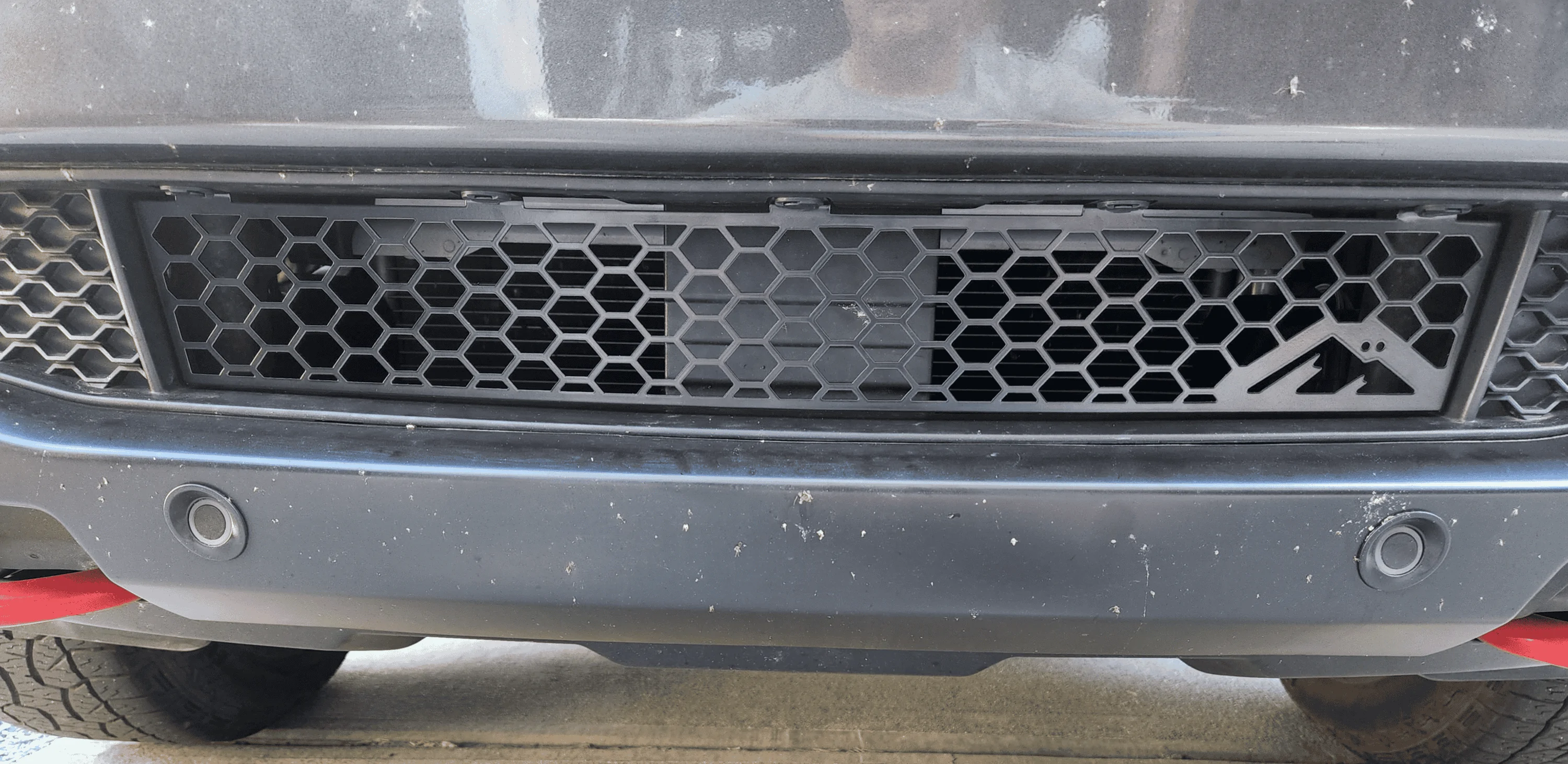

And for those going the stock bracket route. I had a Non ACC Putco grille insert and had planned to get one with the opening for the ACC. But I came across this - Mountains2Metal Bumper Grille Insert. Says it works with ACC w/o a cutout. I decided to give it a try and it works! I figure if it starts giving issues I will get the dremel out and cut out the center section. Bonus - they say is SS so some touch up paint should work fine.
Oh and even though I was able to install my Putco w/o removing the lower valance, I dont think that would be possible with the CCM installed. This one installs from the front using the upper clips - no need to remove anything but the clips.
