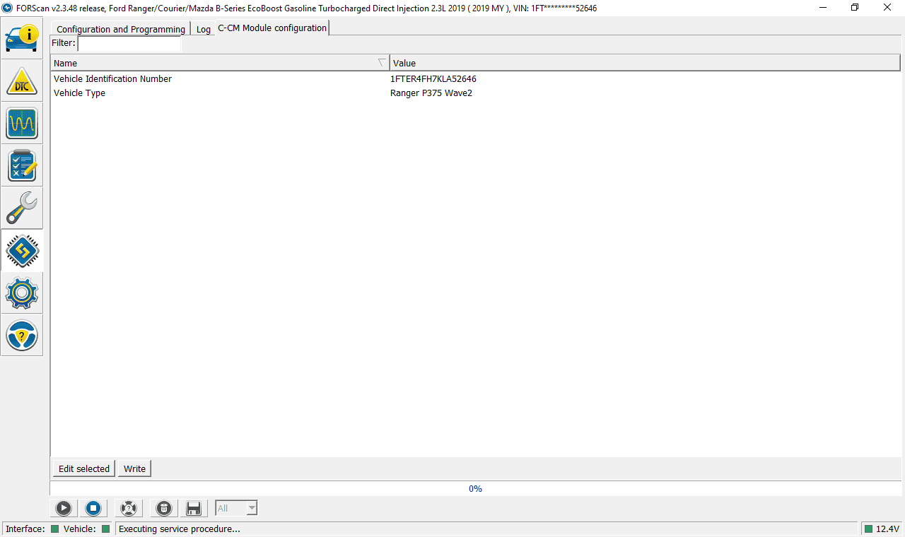

Then I had taken a short cut adding my VIN. I used Easy Mode. Well it took my VIN w/o issue, but the second option you see below, Vehicle Type, wasn't even there! One of you guys got me thinking that I should check my VIN in hex as I had remembered something about the 1st 2 digits being significant. Sure enough mine where 00. I changed it to 24 and BINGO, as below
Now to try calibrating again after dinner
UPDATE
SUCCESS!!!!
Well mostly :-/
I was able to calibrate and now hove no errors!!
