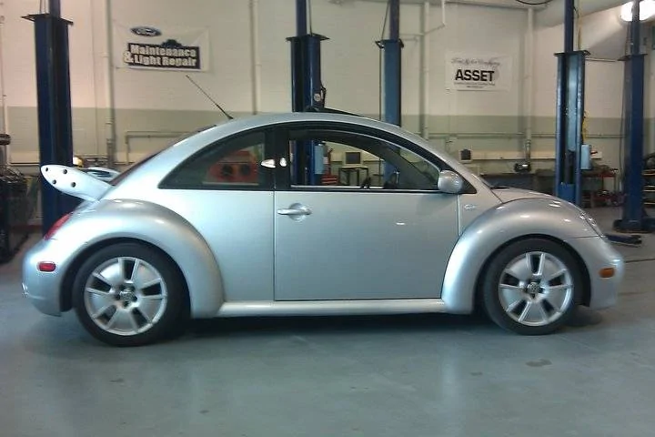

I had last week off (staycation), which was awesome as I got to many of the projects I have been wanting to find the time for done. I did the timing belt on my Audi TT
I used to have a Beetle Turbo S that put down 300 to the wheels.
It was nuts!
I always wanted a TT. At that time in our lives, we had kids, so we needed the back seat as a people mover, so no TT for us.
I refuse to accept help for my car modding addiction - I don't have a problem, I can stop at any time.
Old crappy picture:
It was nuts!
Old crappy picture:
The TT is a fun car, but it's NOT fast... 225 HP AWD and makes lots of noise. My daily driver is my Tesla Model 3 Performance, No clutch, No shifting, just press the GO Pedal. So nothing else is fast anymore.
