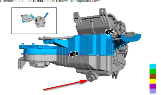

If you just noticed it right after having the work done it's most likely the RTV curing as Duke said. I've worked with silicones & caulks for 40 years and when they're contained in a small area (cab of your truck) there's a lot of off gassing going on and no where for it to go. You won't notice this as much inside your home as it will dissipate through the house and through the HVAC when on.
Robert @NotBudule has a good suggestion about opening the windows and blasting the heat to set it up. If you're parked in the garage keep the windows open to let the gasses out.
[/QUOTE]
I had the blend door fix done on mine, too. The procedure requires than the whole under dash heater be removed. The condensation drain tube may have gotten pinched during re installation, causing the condensate to accumulate in the plenum. you may also notice little moisture droplets at the base of your windshield when the A/C is on, especially on Max A/C.
The RTV should have cured by now.Maybe there is a blob right at a duct.

Spores don't always have to be attached to something they can be airborne. It could've sucked a mold spore through the duct while it was running and the filter trapped it. Then it grew while sitting in the filter and that's what you're smelling. Like Chris @Motorpsychology said a condensate line could've been pinched and is now leaking which will cause the spores to grow on the inside of the duct. So when you turn on the HVAC small parts of it will break off and get trapped in the filter while the rest is still stuck to the duct. You could just wait a few weeks and see if the smell appears again then you'll know for sure. Chances are it was just trapped in the filter and not in the duct.
This happens a lot in a house HVAC system, especially ones that are never cleaned and the filters aren't change often. That's why they have duct cleaning companies for houses. Same principal just a much smaller system in the vehicle.

You could try the "Red Green Approach" :
  • Get an aerosol can of Lysol Disinfectant
  • Remove the cabin air filter, replace it if it's stinky or dinjy Part # FP 88
  • Turn on the HVAC system, not on Max A/C or Max Defrost, fan on highest setting open all windows shoot a ~10 second spray of the Lysol into the intake duct.
  • Repeat for all the other settings to insure all cabin ducts & vents have been covered.
It worked for my '84 Tempo when the drain hose got plugged.
You may be able to check to see if the drain hose is blocked or kinked:
The hose is left of center just above the transmission.
https://www.ranger5g.com/forum/threads/ac-condensate.14149/
