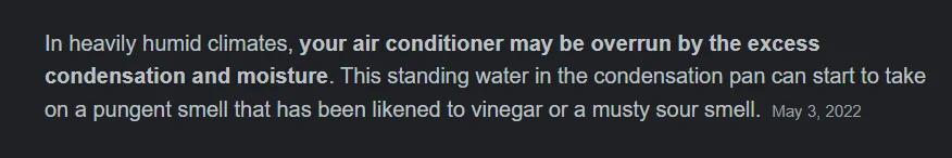

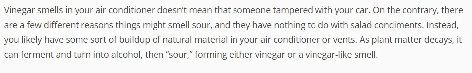

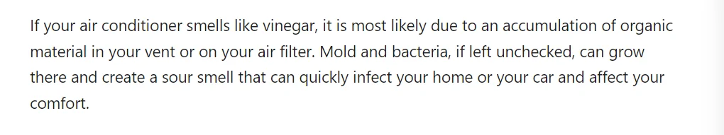

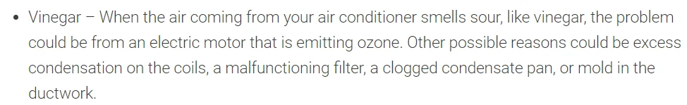

that someone is me, and i know you're hell bent on Phil finding your solution
you can accept others suggestions too or not.
heres a few snippits to help you consider something other than 3 month old silicone.
