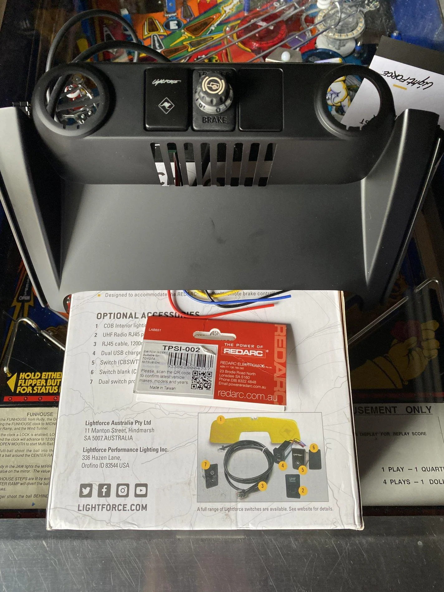

Thanks all for the info and details. Ordered mine and they had it the next day. They were aware of how to use FordPass points so I used the whole mess. Paid the difference which is cheaper than buying from a discount Ford seller. I do my own work so the pass pints won’t do me good anyway.
I’m using a Lightforce panel with the tow pro switch insert for it:
REDARC TPSI-002 Tow-Pro Switch Insert https://www.amazon.com/dp/B07G9PJ23T/ref=cm_sw_r_cp_api_i_pNUXEbP833BP9
That probably what Im going to do as well. Does it include the install directions with it?

This is the setup for the dial:
