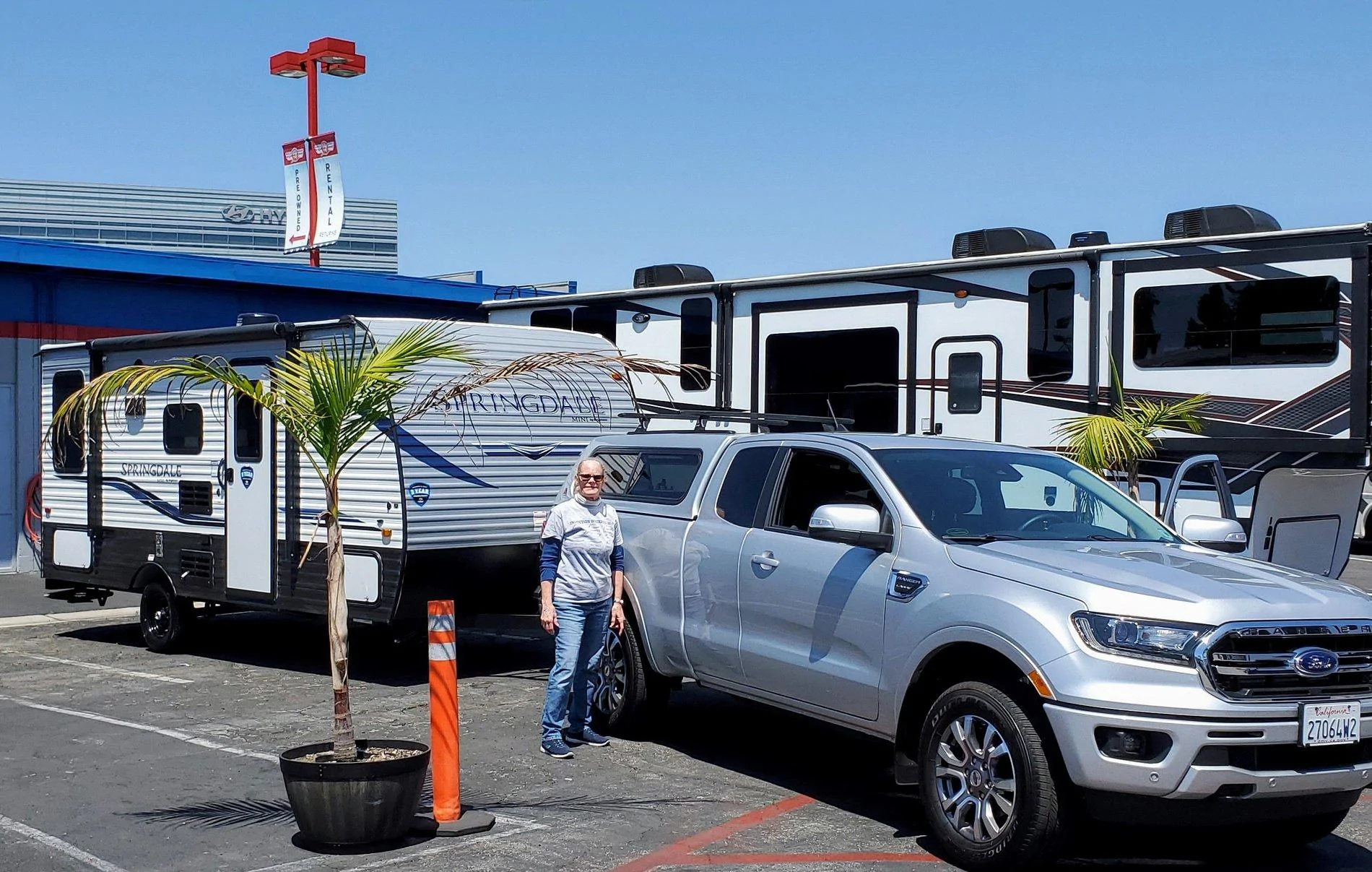

I promised to post my results with the Curt Echo brake controller when I set it up and used it.
I took delivery of a new 2020 travel trailer today and when I hooked up the Echo controller it worked exactly as Curt said it would.
My sequence was get the tongue, chains and pull away hooked up then with the truck in park running plug the trailer into the controller and then plug the trailer/controller into the 7pin on the truck.
It took about a minute to pair the phone and controller and set the profile for this trailer. Once plugged in the truck recognized it, then automatically turned on the trailer side traffic warning system and went to trailer profile "A" that I programmed the night before.
I only towed 80mi home and didn't get a chance to fine tune it yet but it definitely works well.
I have my old Galaxy Note 5 with no SIM card, wi-fi off as my dedicated Echo app interface so calls, texts, emails etc. don't cause any issues with the Bluetooth connection.
I'm still not sure why some of you had problems with the Echo because it was the easiest brake controller I ever used.
