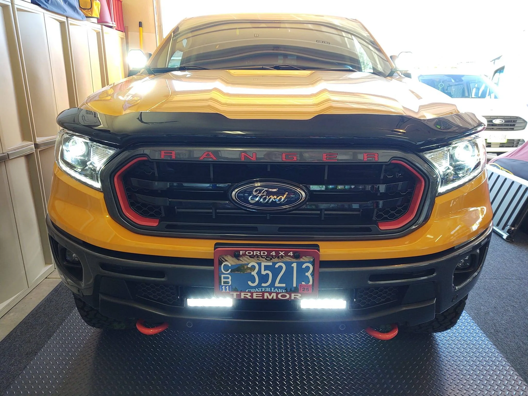

Craig the Ranger is looking SWEET! I to have been using battery tenders for many, many years on my cars, trucks and motorcycles!!!!! Sucks about you canopy. Good luck getting that done the way it was supposed to be done.

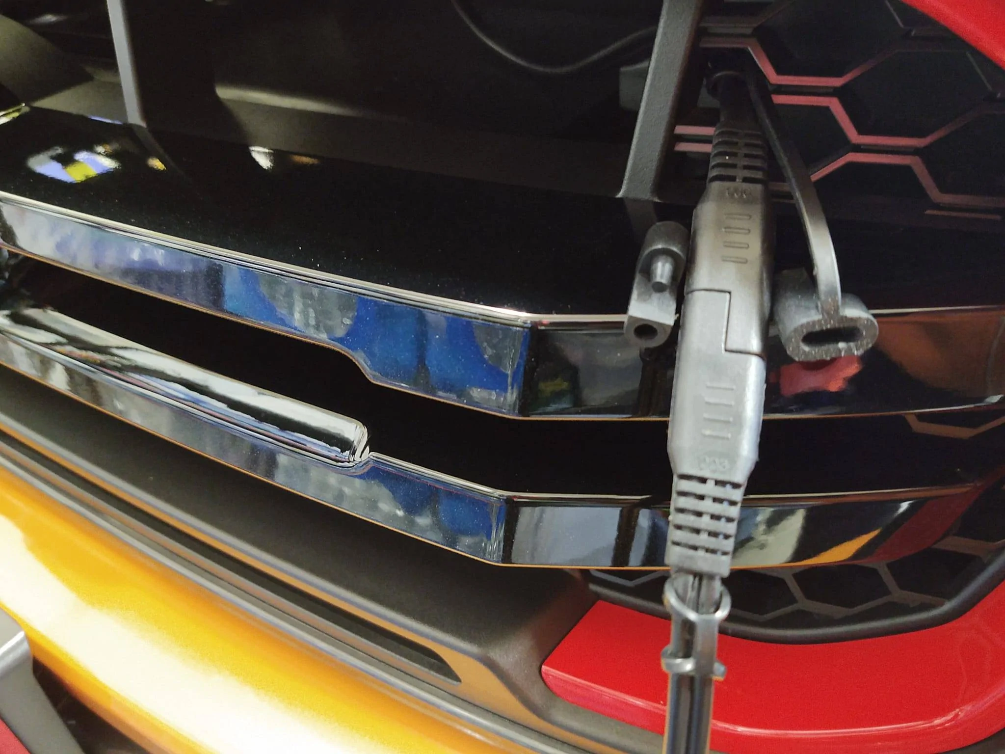

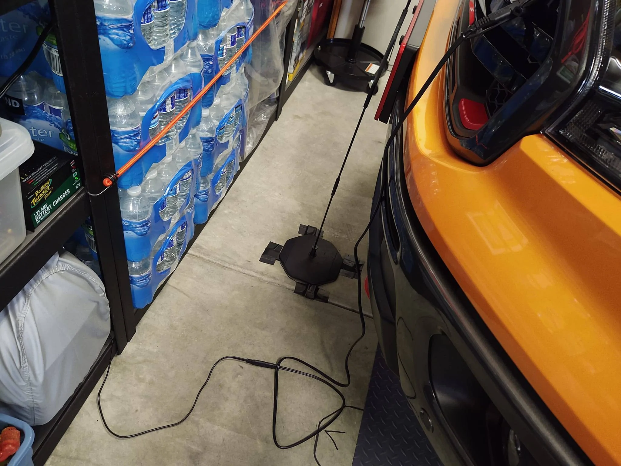

How is the 18" lead connected? spliced at the battery terminals?
No....it comes with ring connectors attached at the battery end....so it goes right on to the battery terminals, the screw on top of the terminals where accessories can be connected. (FYI, the kit also comes with alligator clip connectors, don't use those, they are for a temporary/table top usage). Here are 2 more photos; at the grill and attached to the charger;
Thanks for the comments. Yep...Battery Tender is the way to go. On the Canopy....I wanted this truck to be perfect as it may be my last. They really messed up. Hoping for some resolution. I thought about LineX-ing it...but it needs to be removed to do that too.

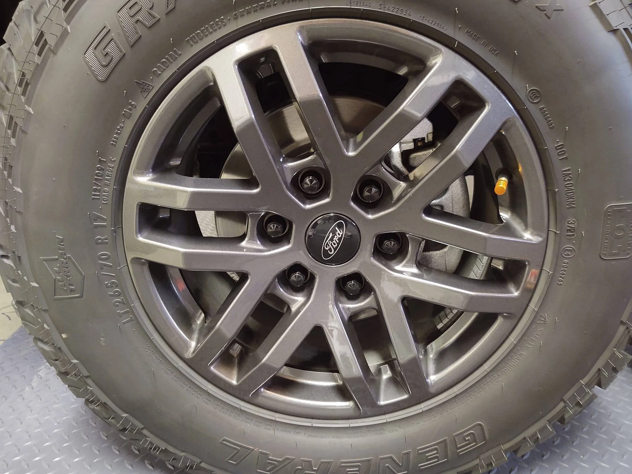

May want to remove those aluminum valve caps before galvanic corrosion starts and they aren't removable.
I have had them on vehicles, motorcycles and a show car for over 10 years with no issues. I know it can happen with some brands.
