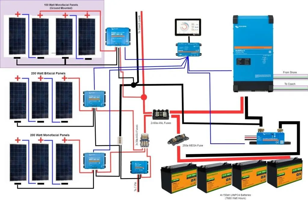

Very good information. I use the smaller/older Orion TR 12/12-18 in ours, just to supplement everything while we're moving. Never really liked that it doesn't integrate with the CerboGX and will probably upgrade to the XS sometime this year.
I've tried to look at charging data in my system, but since the Orion doesn't integrate with everything the data has always gotten lost in the weeds.
This is the system as it sits right now.
